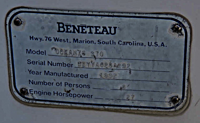

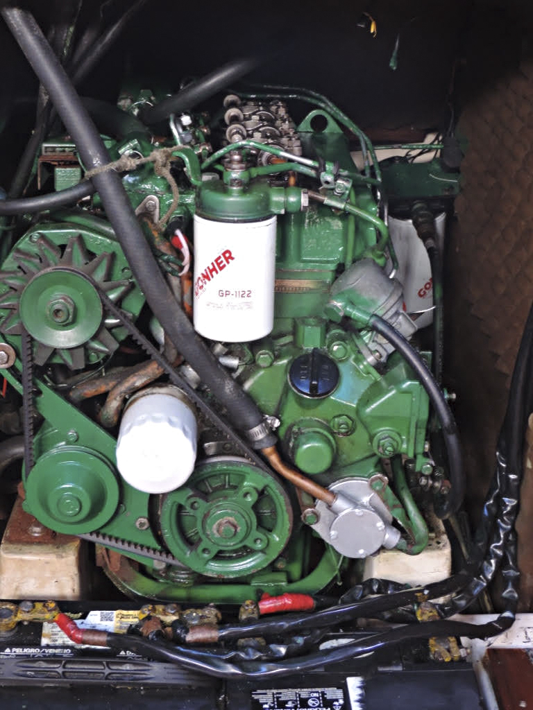

I just received some pics from the owner. Hull plate and engine picture.

Looks a lot like the 2003T that I have on my Oceanis 390 (also labeled 27hp) with a retrofit raw water pump (the silver looking part bottom right) and a retrofit piping of the raw water. The heat exchanger and oil cooler for those engines are almost not available and very expensive (eg $1500) when you can find them at all. I had my oil cooler retrofitted in a similar fashion. The engine itself seems very reliable to me but some parts can be hard to get or expensive (like the heat exchanger). The fact that oil filter/fuel filter/raw water impeller/ alternator are all accessible in the front is a plus. It's also a free flow return meaning that you can get away with not bleeding it if it runs out of fuel, and the decompression lever are also plusses to me.I just had mine rebuilt after 7000+ hours on it because I got water into the cylinders (long story). It's pretty easy to work on for the most part. Starter/altenator, V belt, impeller, etc, are all easy to get and inexpensive
Apr 2, 2019
1
Beneteau Oceanis 370 Fremantle
I think most of the Oceanis 370 are the V-P 2003 27HP, not the 2003T which is turbo. Mine is 2003, and is running well, generally parts are expensive. Regular failure is the raw water pump, which is manufactured by Johnson, and can be bought from them, or rebuilt with a kit.
