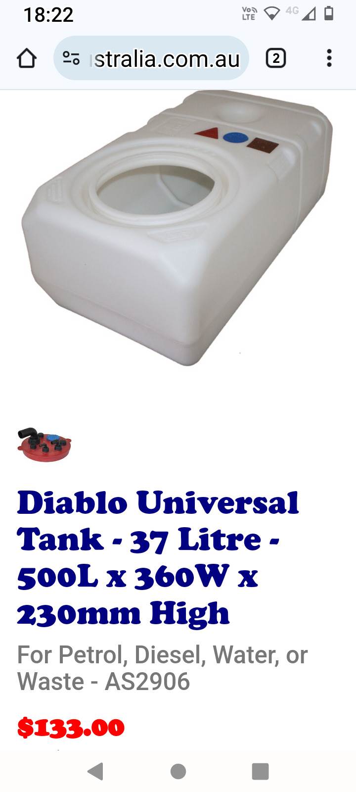

A new plastic tank would be my choice.
Check the net. You will find tanks cheaper than from a marine chandler.
The following link is for the tank only. Lid is extra!

Plastic tanks made to hold water and waste cannot be used to hold fuel...Petroleum products would saturate them. There are two different types of polyethylene...water and waste tanks are made of "linear" PE...petroleum products would saturate it. Plastic fuel tanks must be made of "cross linked" PE and also must be USCG approved, meeting several standards that include "no horizontal surface on which liquid can pool." and others. Because of that and liability risks, there are very few mfrs who makes plastic fuel tanks. Moeller is the only one I know of who still makes anything but small ones for outboard engines and theirs are expensive!
Aluminum is actually the recommended material for permanent marine fuel tanks because of its resistance to salt air that steel doesn't have. Do a search for aluminum FUEL tanks fitted for use with diesel.
