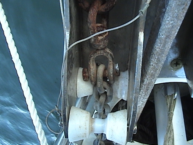

Maybe the perspective of the picture deceives me. Terry to you have a shot from one side of the anchor roller that shows the respective heights of the rollers and the guides that from the sides of the anchor-roller assembly? I'm curious about the lead when the boat is "pulling-up" on the anchor as it is "out there".
If it's not convenient, don't feel compelled to do it quickly ;^)))))

I put one of the tranpartnet yellow ones on mine. Is holding up much better than the stock white one.
I've looked at some of those and they might work. Just need to get a couple that are close in size then trim them as you say.
I'm going to the boat this weekend and will take some pics for reference. The rear rollers get no rode strain to speak of. The larger front one will get the most and it has held up well and remains in fair condition.

Hi Rich, the two rear rollers are 3” wide, 1-3/4” in diameter that tapers down to about a half of an inch to the center. Pin/axel diameter is 3/8”. I’ve looked around for something close off the shelf, and am still looking.

Checked on the boat today and measured the center diameter of the small bow rollers. One inch.

Terry - are the rollers in the picture feeding into the chain locker or out over the water in the direction you'd drop the anchor? It looks to me like the bow is toward the top of the picture.

It is. The aft end of the bow roller contains the two smaller rollers that sort of feed the rode into the locker. Setup does not work very well, so I end up hand feeding the rode into the locker. That way I can keep an eye on the whole operation in order to keep everything in proper working order.
Happy with the operation both launching and retrieving the anchor by hand. Manual (foot switch) electric windlass hoists the anchor as I feed the rode into the locker. Manual drop (launch) by hand seems to work just fine. Not a big deal and all part of the cruising experience. No plan to make any major changes, just a tweak now and then.
