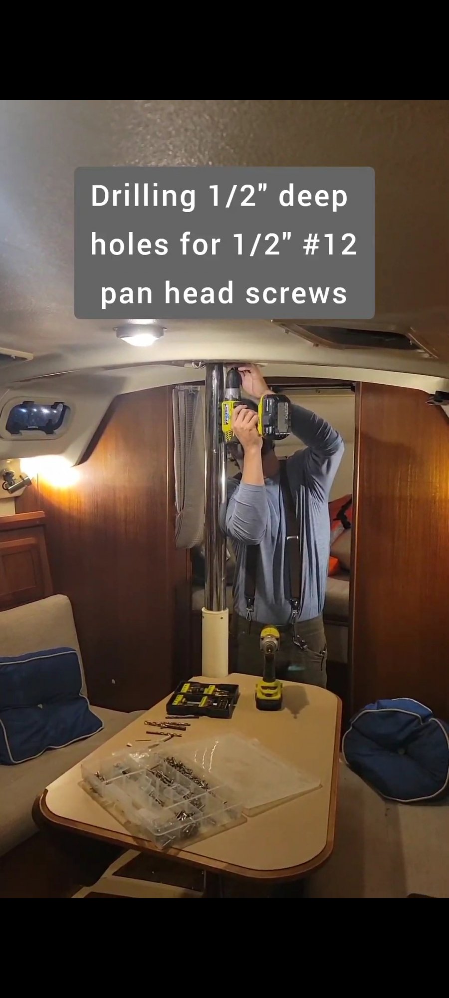

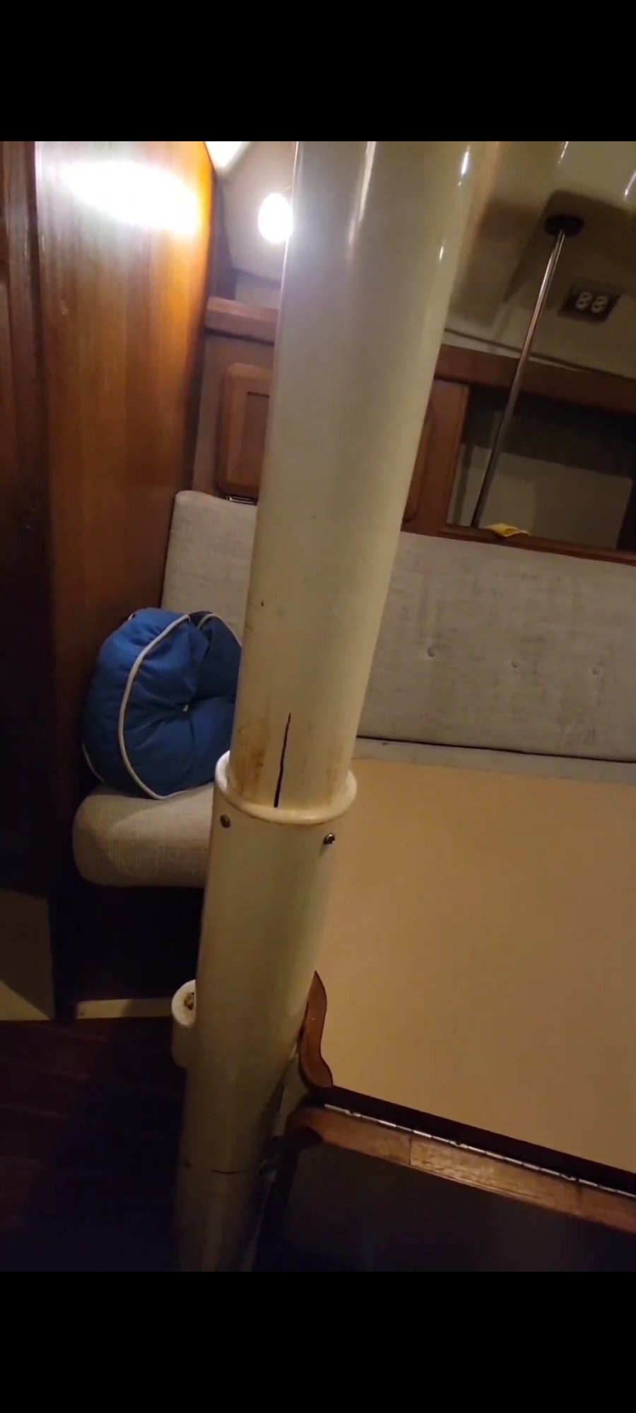

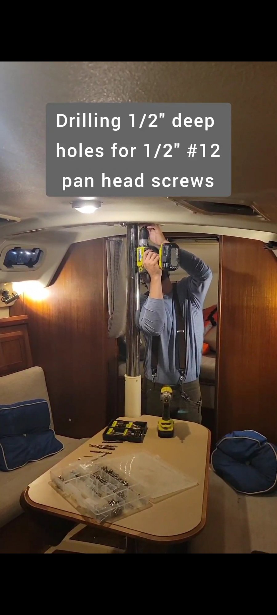

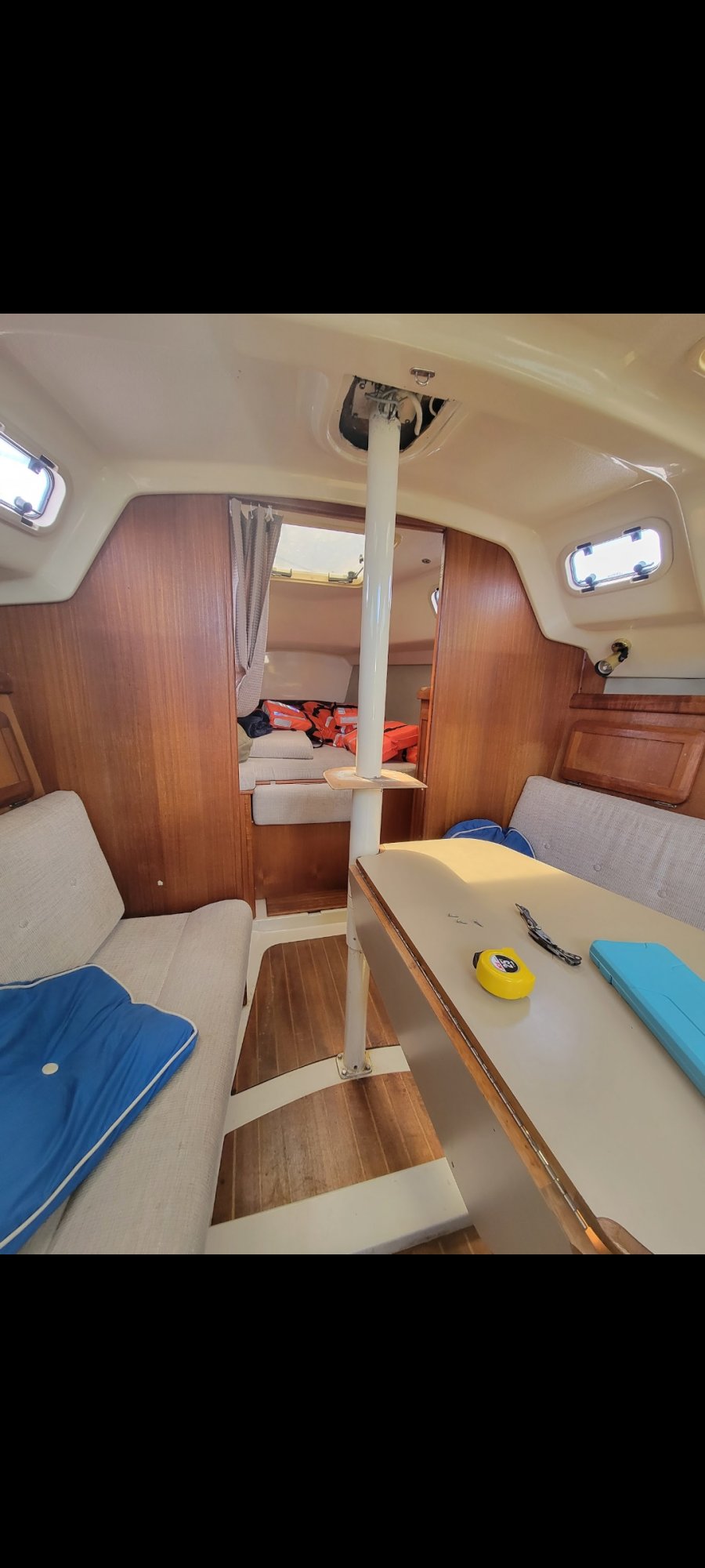

Has anybody experienced this same issue? The counterweight inside our aluminum compression post oxidized and swelled, causing the post to crack. we replaced ours with schedule 40 316L and ditched the counterweight.
