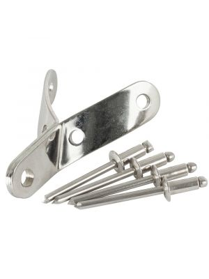

Usually there is a tang at the base of the mast to which you shackle the vang.
It often looks like this..
So look and see if there is a way to attach a shackle to the base of the mast. There are a lot of ways to accomplish this.
Notice in this picture (below) they are using a simple pad eye (aka eye strap or eyelet).
You can buy them right here at SBO
Sea-Dog Line Eye Straps - 081101/2/3/4/5
Pop two rivets into this and you are good to go... you can also find these at Lowes in the stainless section near the cheap pullys.
