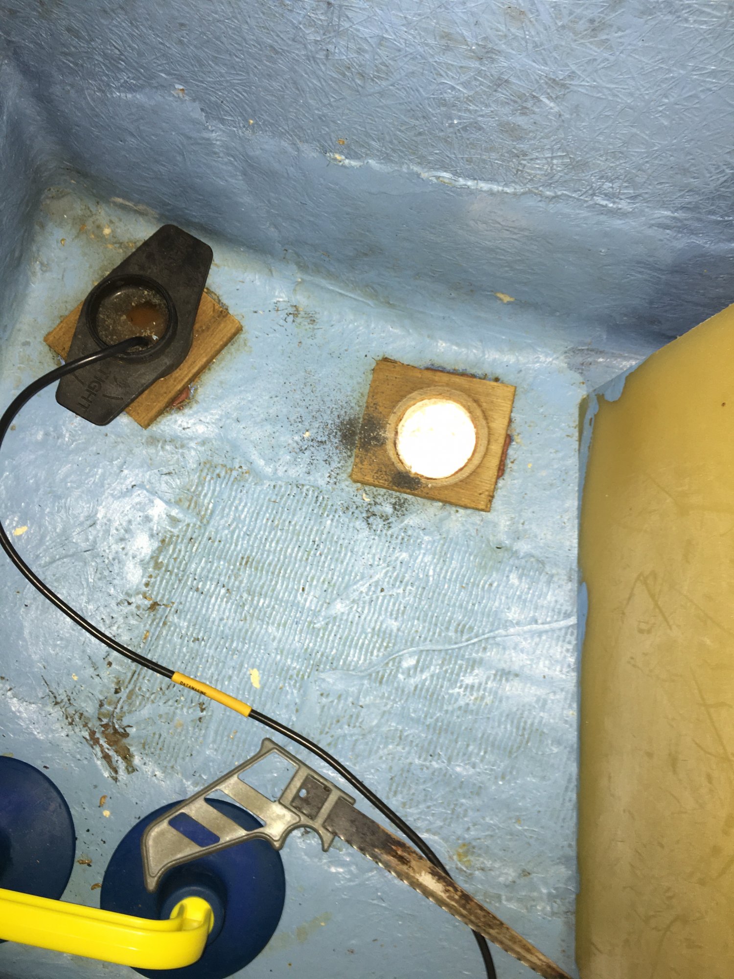

As purchased, she had no working electronics other than the autopilot and I need some basic instruments... Depth Sounder, Wind Speed, and a GPS antenna. I assumed the depth sounder would be easy enough after I remover the old water wheel and replaced it with a new transducer, I could just use the old wire as a fish... Failed.... I was hoping someone found a method or a trick other than hammers, saws, and chisels to run the wires. Open to all ideas after spending a full day crawling around, poking into tight spaces, moving floorboards, seating and gear around with no success. If you are too busy sailing, jealous but understand.

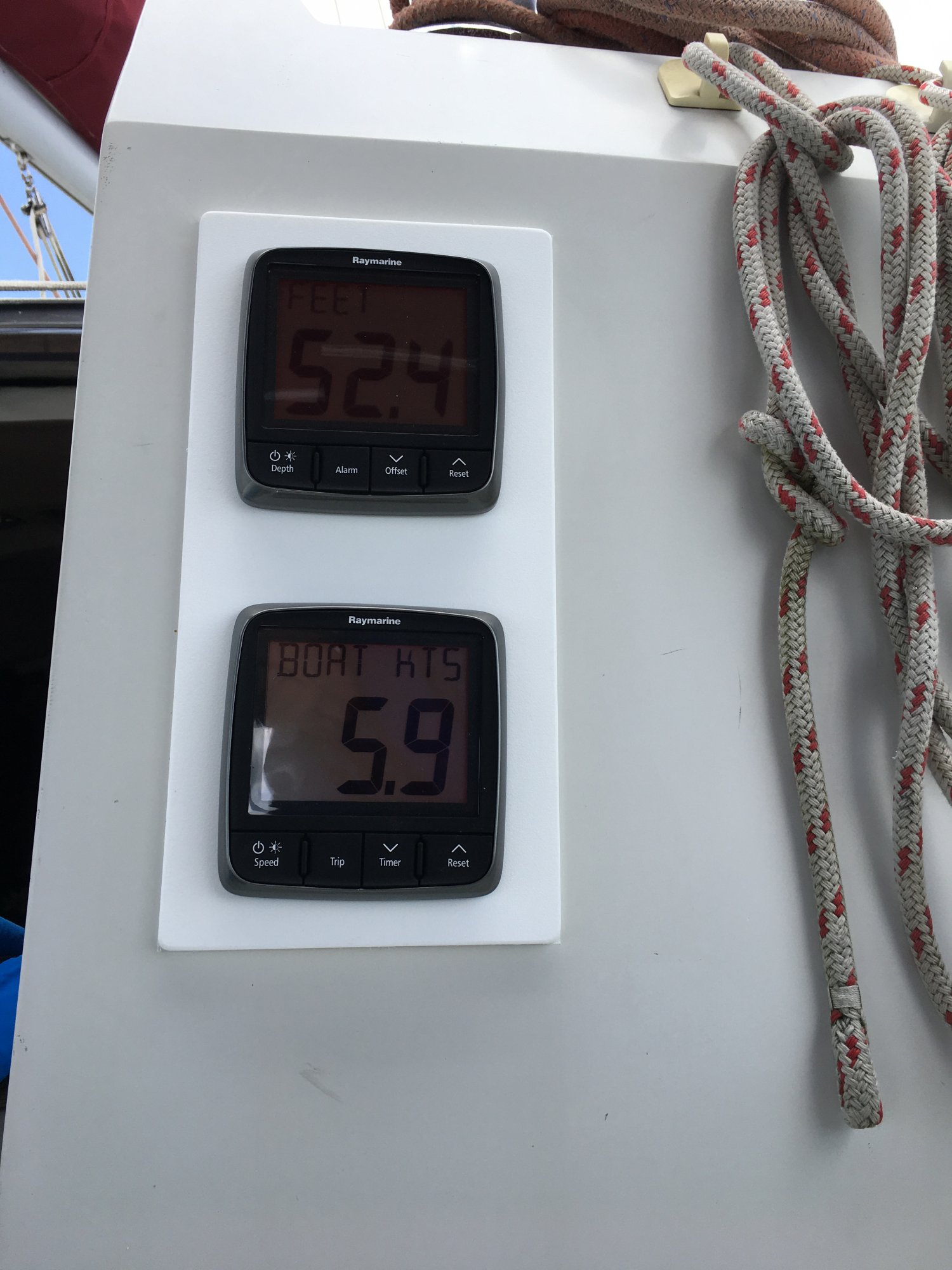

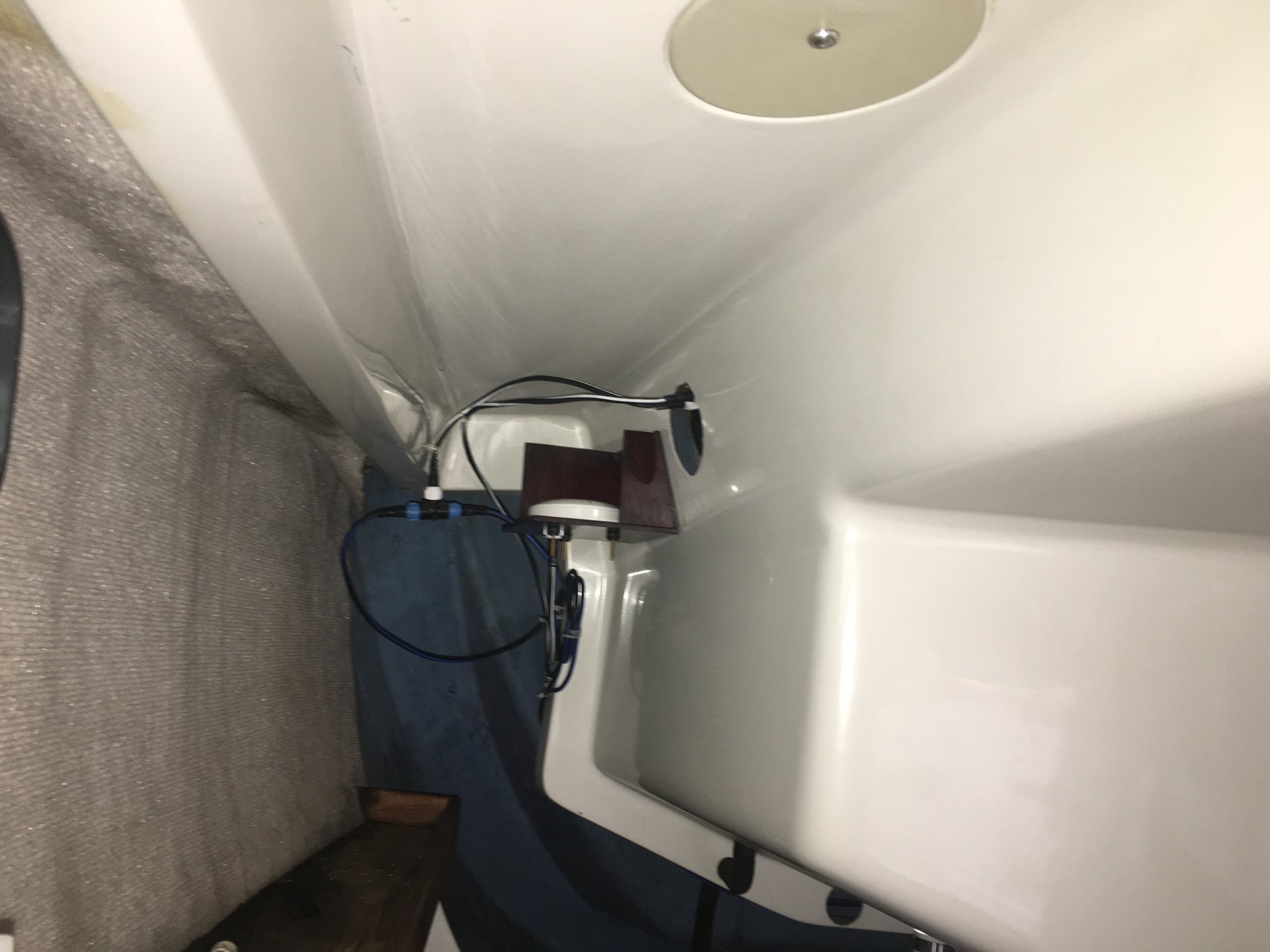

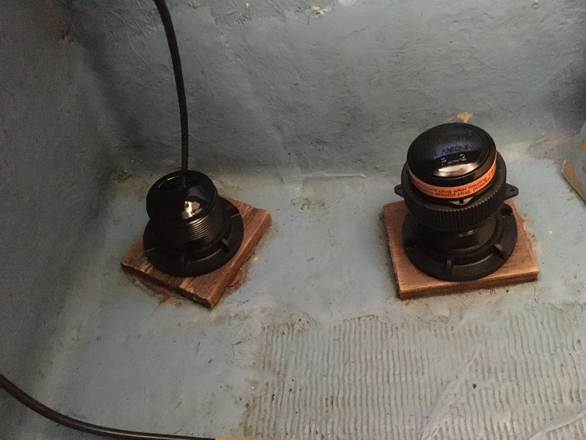

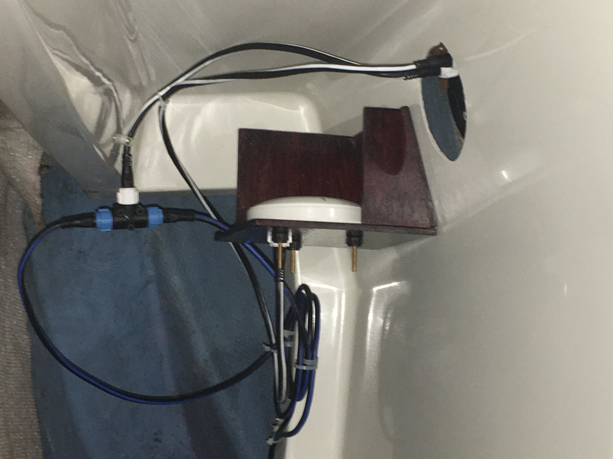

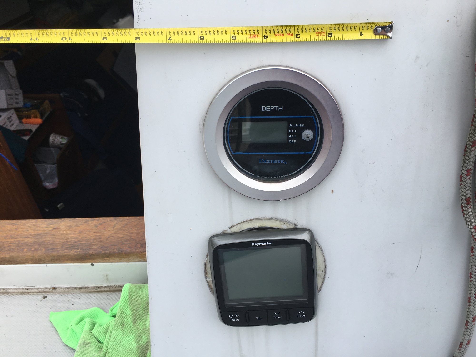

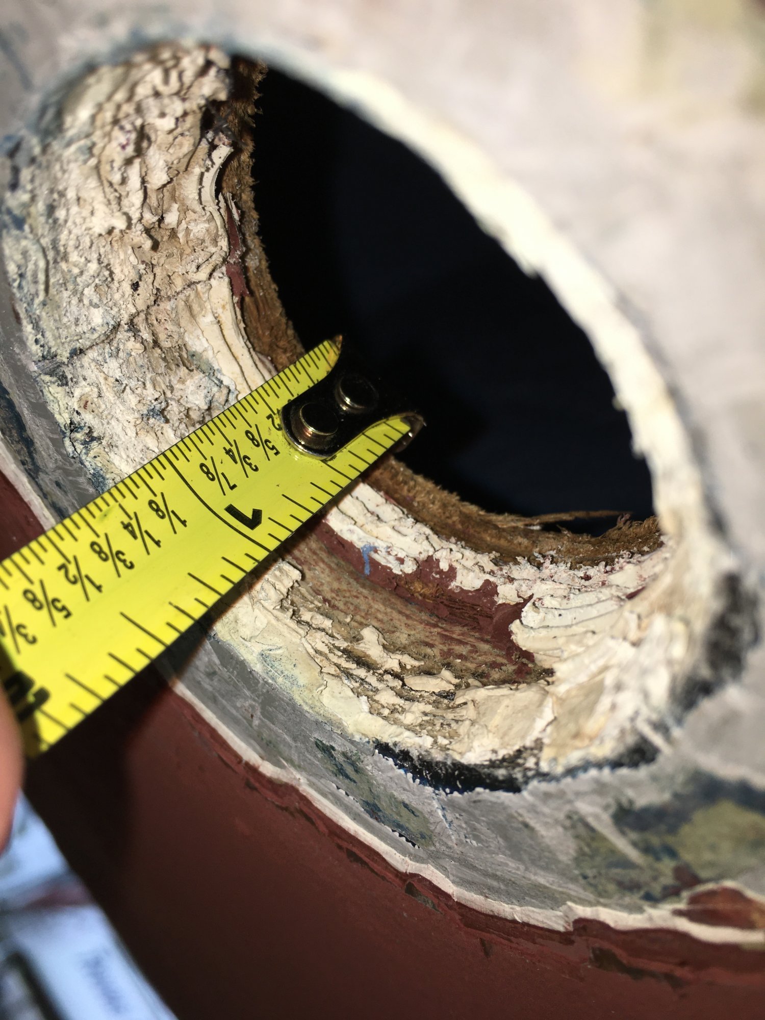

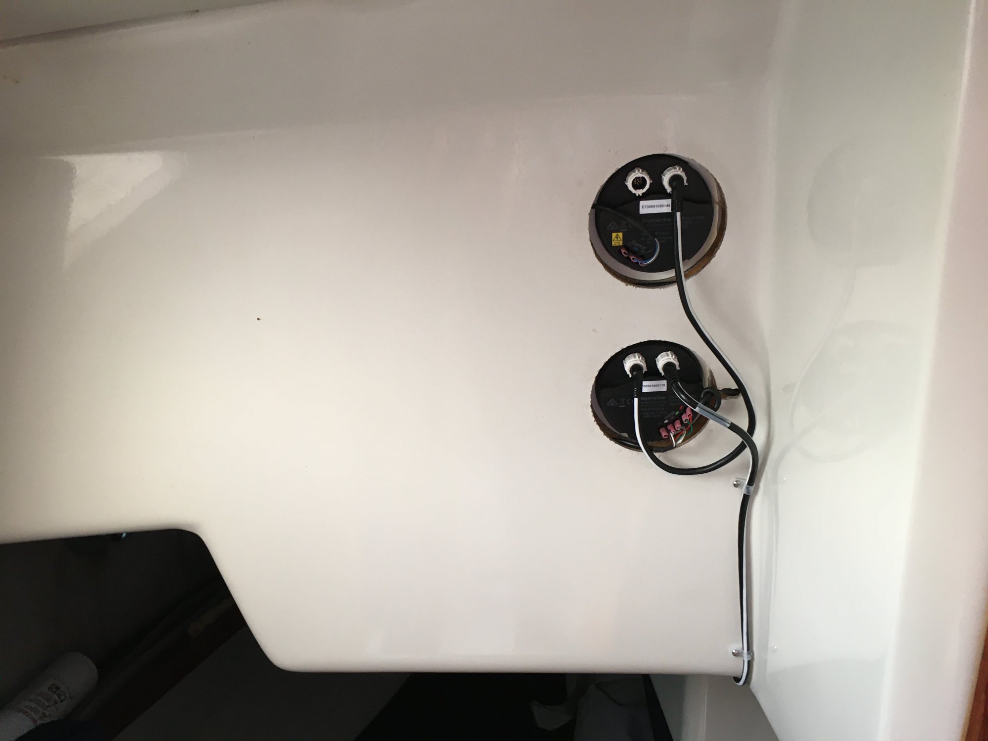

By amazing coincidence, I just happened to have replaced my old DataMarine original speed and depth in the last few weeks. While both still worked, the display numbers were getting so weak to read, it was time. Also, I wanted to get modern instruments, so the data could be posted onto my SeaTalkng NMEA 2000 network to post on the chart plotter, calculate true wind vs apparent wind, etc.

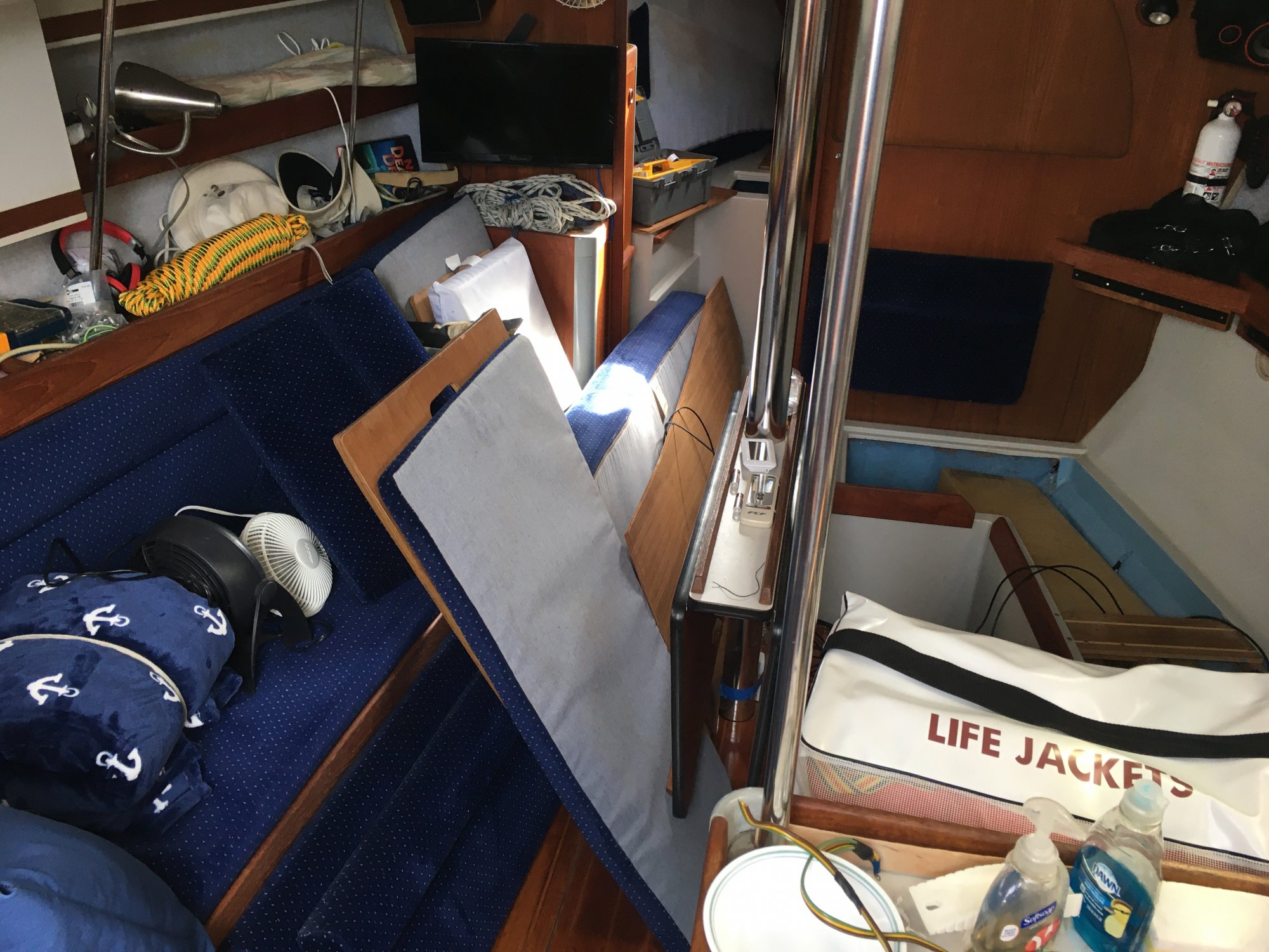

It was not too bad a project. I had traced the wiring to understand how it ran, to insure running new wires was going to be possible. I used one of the old transducer wires as the messenger to pull through the new wires. The route (as you probably know) is....... Transducers in the forward area of the U-Dinette, then back beside the starboard water tank, then under the ice-box and the stove, under the aft locker, then a right turn along the front of the holding tank under the aft berth, then a right turn along the starboard side of the engine mounts, then up the front of the engine compartment, and behind the stairway aft-facing plywood, and then a short run between the cockpit hull and the inner liner. Using the existing wiring as messenger made it pretty easy (don't loose track of it ! or break the connection between the old messenger and the new wire). Fishing around with a contractors, fishing wire thingy (what do you call that thing), was not terribly productive and might take forever.

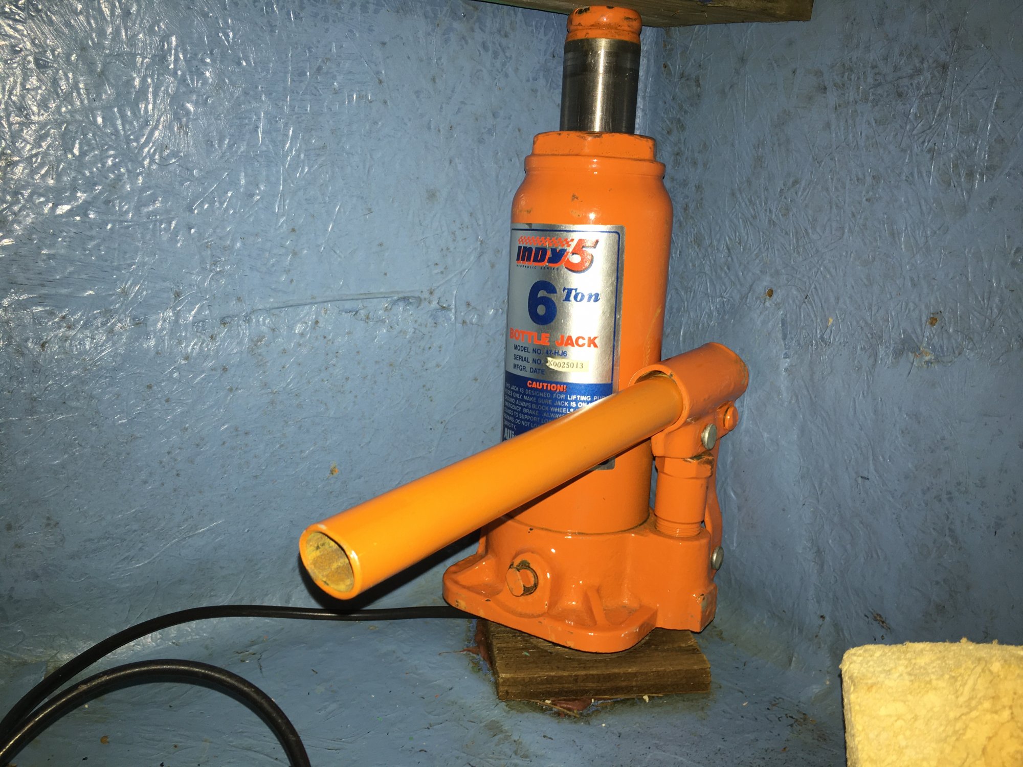

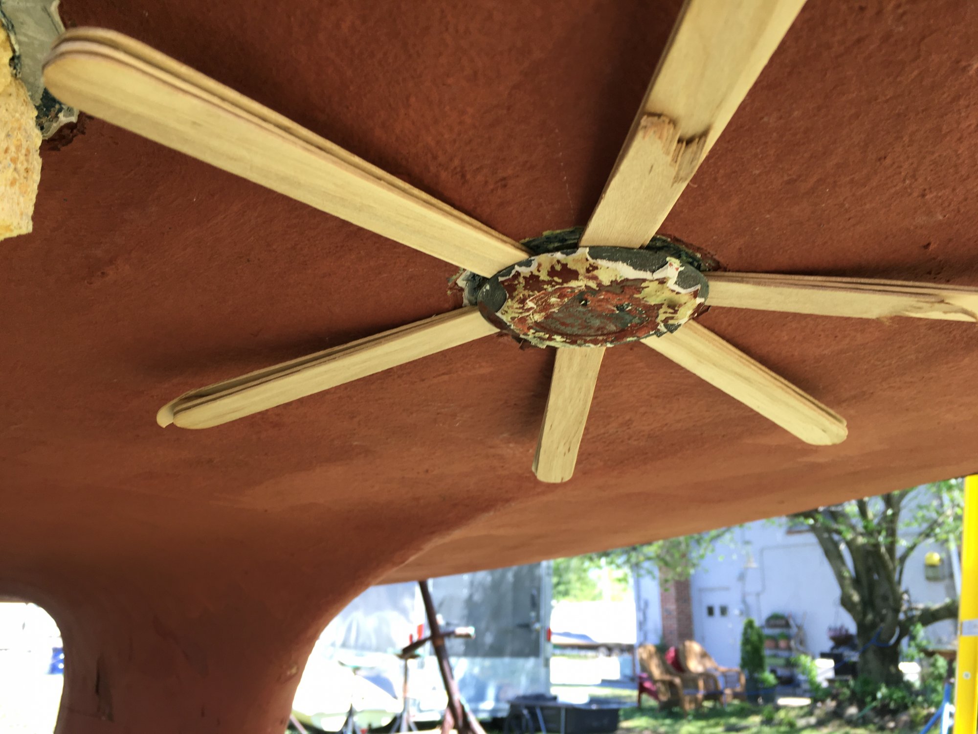

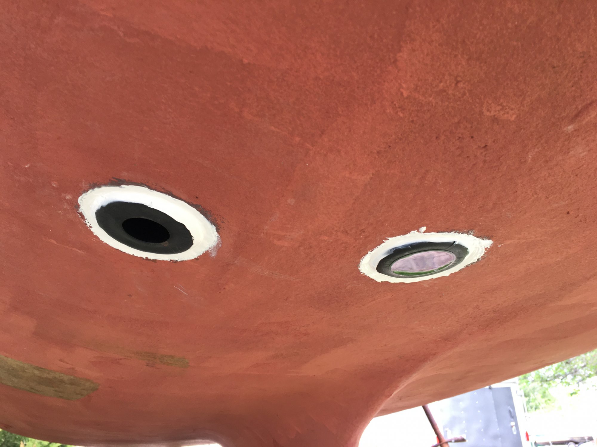

I was concerned about whether the old transducers were installed with 5200 (the BANE of all mankind ! ), but they were just installed with traditional Life-Caulk . (THANK YOU O'DAY !). I did make the job easier by pressing them out from the inside with a small bottle-jack and they came right out. Not quite like butter, but not bad at all.
Attached are some pictures.
The new instruments are Raymarine ST50. Love them!

Thanks - New transducer is mounted thru the hull. The issue is that none of existing wires are moveable and I was unable to fish is through another path. Looks like I will need to rip up part of the glued down decking to find a new path. I was hoping someone else solved this issue on another ODay 322.

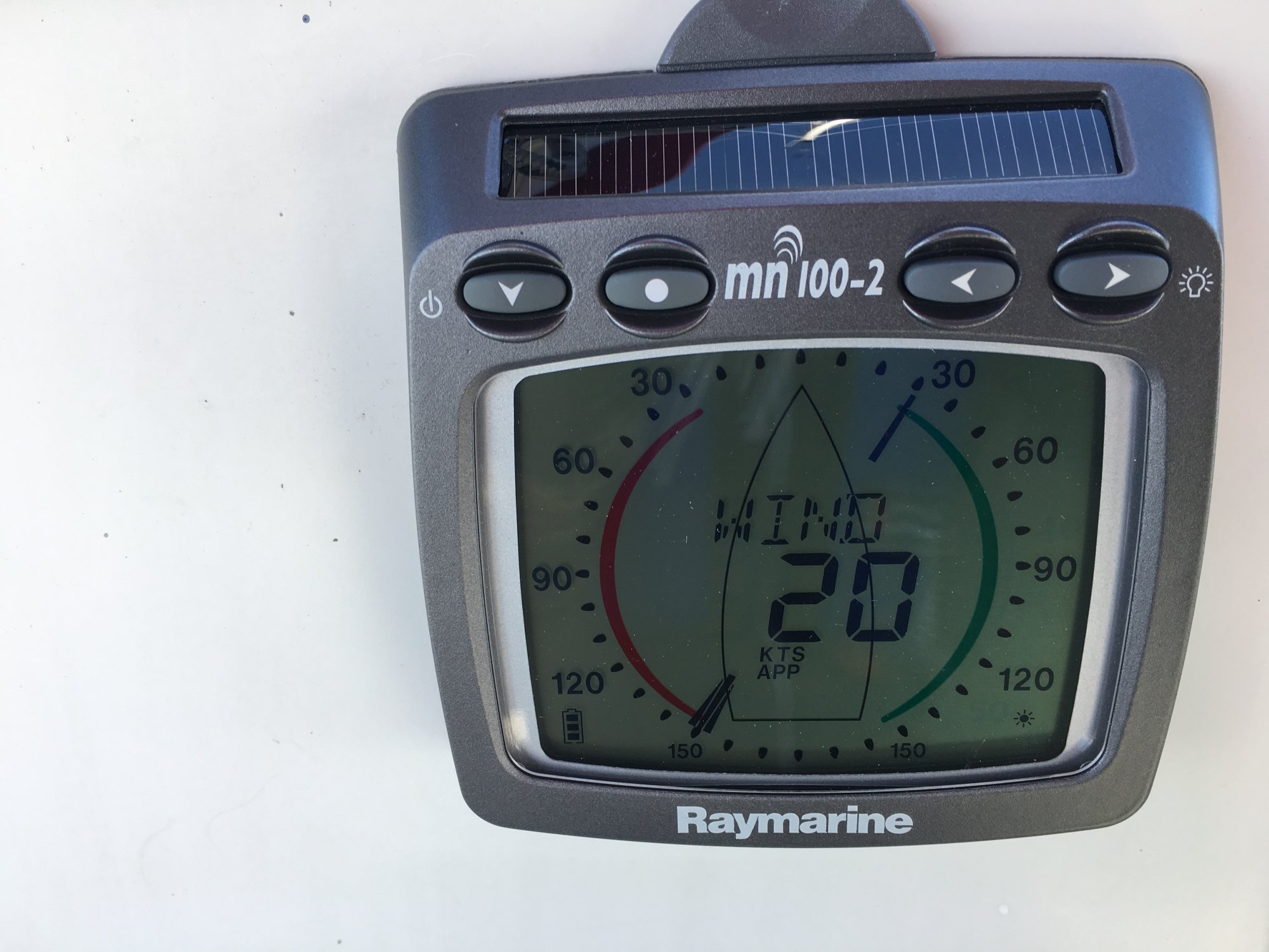

Sure. These babies need no wiring (solar powered):
Raymarine Wireless 2-line Speed/Depth Pack, 1 Xdcr Amazon.com: Raymarine Wireless 2-line Speed/Depth Pack, 1 Xdcr: Home Audio & Theater
Raymarine Wireless Wind Transmitter (Part #T120 By Raymarine) Amazon.com : Raymarine Wireless Wind Transmitter (Part #T120 By Raymarine) : Sports & Outdoors

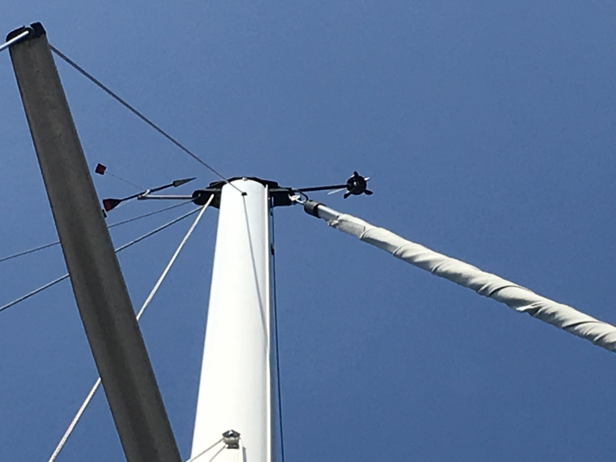

While I did not replace the speed/depth with wireless (see previous post) I did use the wireless RayMarine wind unit for the wind vane project. I also installed the wireless adapter (flying saucer) to post the data to NMEA2000 SeaTalkng network, so I would have wind data at the MFD, and so it could compute true wind from apparent wind (true wind is computed via boat speed through the water, wind speed, heading, wind direction, and a bunch of trigonometry (too much for me !). But I love having true wind speed now. The data flow from the wind transponder to the wind display unit, to the wireless adaptor, onto the network and thus to the MFD. (it does not post data to the network if the display is not turned on, that is required for the data path).
I hope it lasts 10 years, so far one year and so far - so good.
