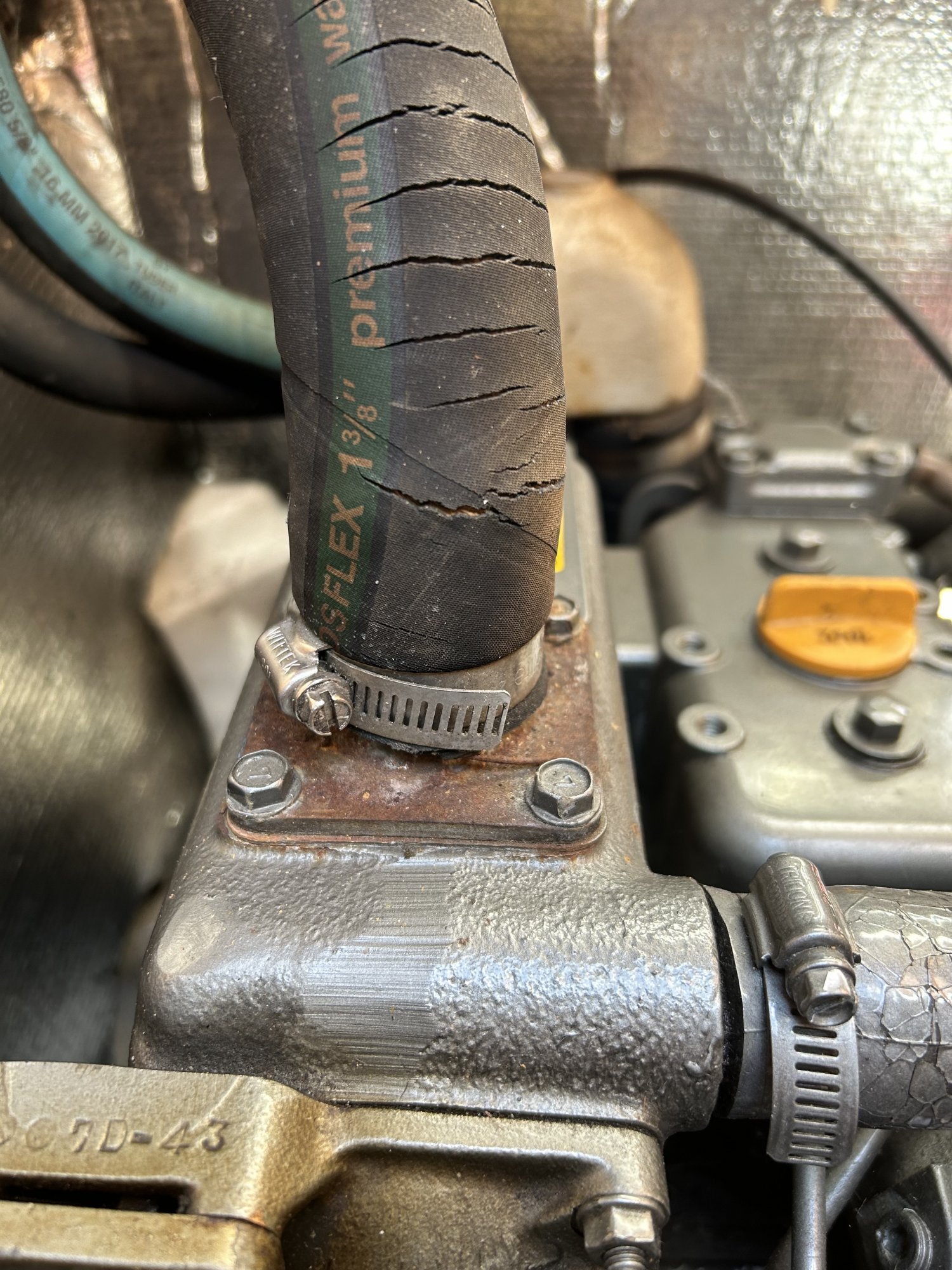

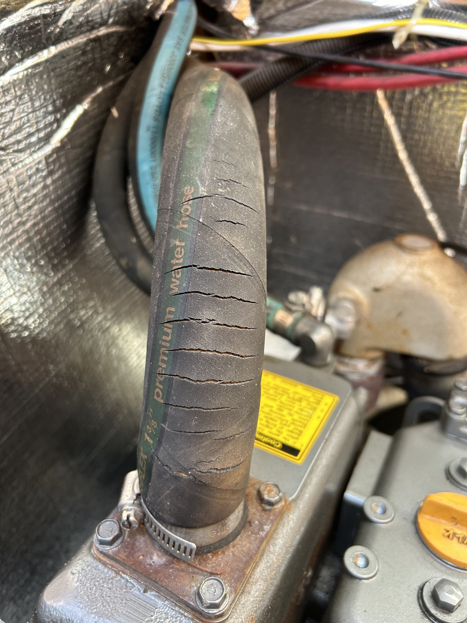

Hello my hunter 28.5 with 2gm20f engine has radiator hose coming out of heat exchanger at top of engine which then runs to a filler neck with pressure cap located in the battery compartment. Why can’t I just put the filler neck with cap at top of heat exchanger and eliminate this huge
1 3/8” radiator hose. I do have full access to top of engine. I made the top of engine compartment removable

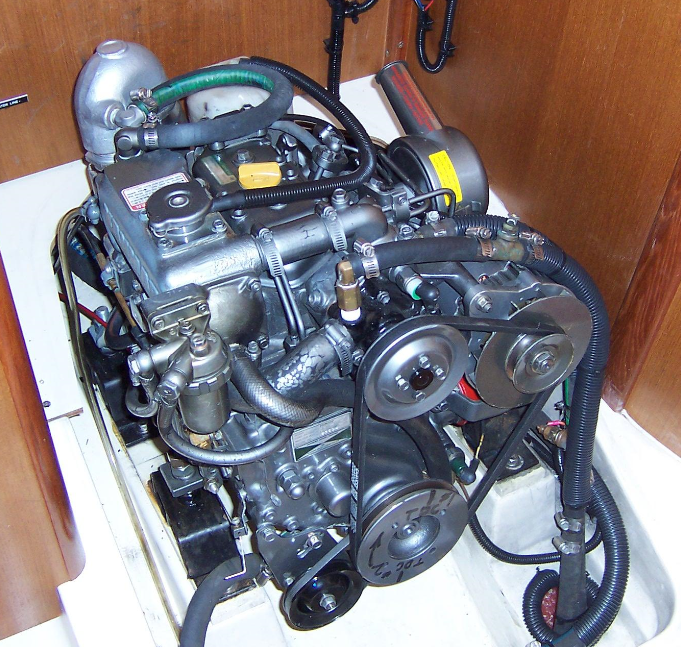

Here is the original construction on top of the HEX :
I don't know what you'll find under the hose but I don't think a cap is going to go directly back on to what is remaining on top of the HEX.
You're definitely on the right track as the hose looks like it's on its last legs.

As @Ralph Johnstone said, someone Frankenstined your engine.
My 2GM20F looks a lot like Ralph’s (just not as clean).

Hello the hose exits the engine compartment to a filler neck with cap located in the battery compartment. It appears that this was done to allow access to fill the system since the engine compartment top is not removable. I went ahead and modified it so it slides out and I now have full access to top of the engine
Dec 14, 2003
1,450
