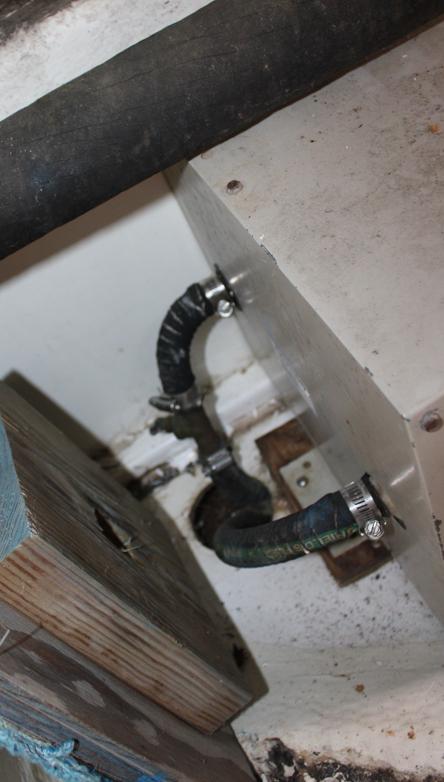

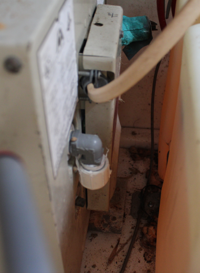

See the attached thumbnails. As you can see the it appears the rear inlet and outlet to and from the engine are still attached whereas the front inlet and front outlet to the potable water system are disconnected and capped off. I did not have time to check out the impendence of the heating element(s).
If the elements are sound I surmise replumbing this to the house system could be challenging, to say the least. That won't happen this year...

On the water heater, the rear photo does show the engine heater hook ups to give you hot water from the engine. The engine coolant runs through the hoses, through a coil in the WH, warming the water in the tank.
The other photo appears to show the electrical connection and what I am guessing is a Temp & Pressure valve (only saying that because there does not appear to be any hose attached to it.
On my old Atwood WH, the engine heater hoses are in the back, like yours, and the electrical connection, T&P valve, as well as the cold water inlet and hot water outlets are all on the front. They are made in different configurations however, so yours may be different.
More photos of all connections would be helpful.

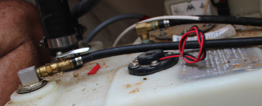

Any idea(s) what the black and red wire are for?
I agree with David. I would say it is a fuel level sensor that is not hooked up.
If you can find out the ohm range for the sensor And purchase the correct ohm range gauge, and supply power to the gauge, you could have a working fuel gauge.
