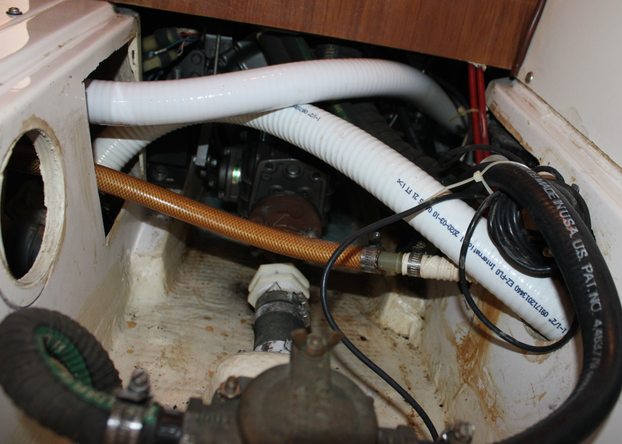

This valve with white hose is, I believe, the fresh water intake to the Yanmar engine. My question is the "flange" between the bulkhead and the valve. I "scraped" the flange and it feels like rusted iron (iron oxide). Is this the normal material for a freshwater intake flange? What is the normal or OEM material?

Whatever that is, replace it asap. Bronze or brass don’t rust and someone connected that sorry excuse for a thruhull to a hose with some plumbing fitting similar to a screw-on PVC pipe connector. Did a surveyor ever look at that?

Are you certain that isn’t the thru hull fitting for the holding tank discharge? Just curious, because I had a 88 Hunter 33.5 that had a gate valve for the holding tank waste discharge; all of the remaining thru hull assemblies had bronze ball valves. I don’t have a clue as to why Hunter used gate valves for the holding tank, other than reduced costs. General knowledge that gate valves are not a good idea for marine thru hull applications. Seeing your gate valve setup leads me to believe that it is probably original to the boat; 39 years. Needless to say, it is past time to replace the entire assembly preferably with a bronze seacock or at least with bronze ball valves. I replaced all of my Hunter thru hull fittings, valves, & tailpieces with bronze & fabricated new backing plates as the plywood plates that Hunter used were rotting. Definitely ditch the pvc/hose fitting & use a bronze tailpiece with double clamps on the hose. Must have been a plumber who did that repair! Don’t know what other maintenance / repairs are planned; however, this requires immediate attention.

I agree with all of the above - the thru-hull, valve, and hose all look very non-marine, and due for replacement.
One note on the terminology to keep things clear if you talk to others about it - you’re on a lake so the water is fresh, but the general way to refer to that plumbing is the “raw” water circuit. The “fresh” water circuit in an engine is the closed antifreeze/coolant loop. Also, the pictured item is a thru-hull, and it goes through the hull itself. A bulkhead is a divider usually separating parts of the cabin and attached to the hull.

Out of curiosity I went to Lowes.com and entered the SKU#, the hose is 1 1/4" Flexible Spa hose.
While there are places on a boat where using non-marine grade parts are OK, especially on a freshwater boat, it is foolish to use anything but marine grade when the consequences of it failing are extreme, like sinking or setting the boat on fire. Sure, the marine stuff may cost a few bucks more, but isn't it worth it to keep the boat afloat.
To add to @Davidasailor26's comment, "fresh water system" usually refers to the drinking water system. Raw water or Sea water intakes and systems refer to water taken in from the lake, river, or ocean. I tend to use the term sea water as it is quite specific.

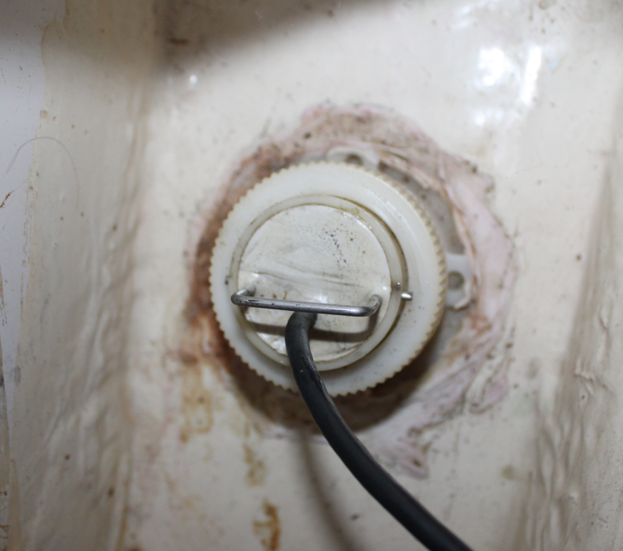

      • Hunter 285 - Shaft Bilge - Speed Sensor - I assume this is the speed sensor, versus depth detector, for this boat. Is this an item that could/should be replaced also? I, again, assume this is OEM and therefore 40-years old.​

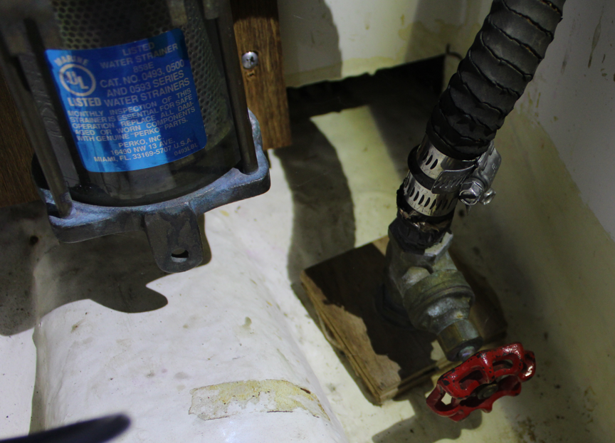

      • Hunter 285 - Shaft Bilge - Raw Water Intake - This is what I believe to be my raw water intake valve. While the valve appears to be an OEM gate valve, and the hose is secured by two (2) hose clamps, I have asked the marine to replace the hose due to its aged appearance.​
Maybe, can't tell the difference from inside the boat. Look outside for a paddlewheel.

Can't tell from the photo. Find the end of the hose. Is this the same hose in the first photo?
If your depth sensor works then I would probably not prioritize transducer replacement. If the transducers are 40 years old then replacing them could mean replacing the displays too, which will get expensive quick. On a lake without current speed through water isn’t critical; GPS speed from a phone could be good enough for now. Use the boat, see what you like, fix the other safety-critical things, then decide on what you need for electronics.
Hunter 285 - Shaft Bilge - It appears this white non-marine hose is possibly connected to the engine
Possibly. Usually the engine will have one raw water intake from the thru-hull or strainer to the raw water pump, one hose from pump to heat exchanger, one from heat exchanger to exhaust elbow, and a larger hose for the exhaust. Any other hoses around the engine could be fresh water / coolant. Hard to tell from the picture where the white hose is running and how it might be involved. You’ll probably need to trace it from end to end to find out.
It does look like that could be a raw water intake hose, and yes it definitely looks past its prime. I agree with @dlochner though - that’s an easy DIY project and probably a good one to learn from. It’s probably 1 or 2 out of 10 on the DIY difficulty scale. The gate valves should probably be replaced with proper ball valves or seacocks too, though that’s a little more advance of a project.

The raw water intake assembly (shown next to the raw water strainer), is a disaster waiting for a time & place to happen. The original hose appears cracked & rotted; when it fails, your boat sinks. Keep a set of conical wood plugs to plug the hole in an emergency. Also, keep the valve closed until you replace the hose. Good habit is to close all thru hull valves when you’re not onboard.

I personally wouldn‘t be concerned about the plastic speed/depth transducer yet.
