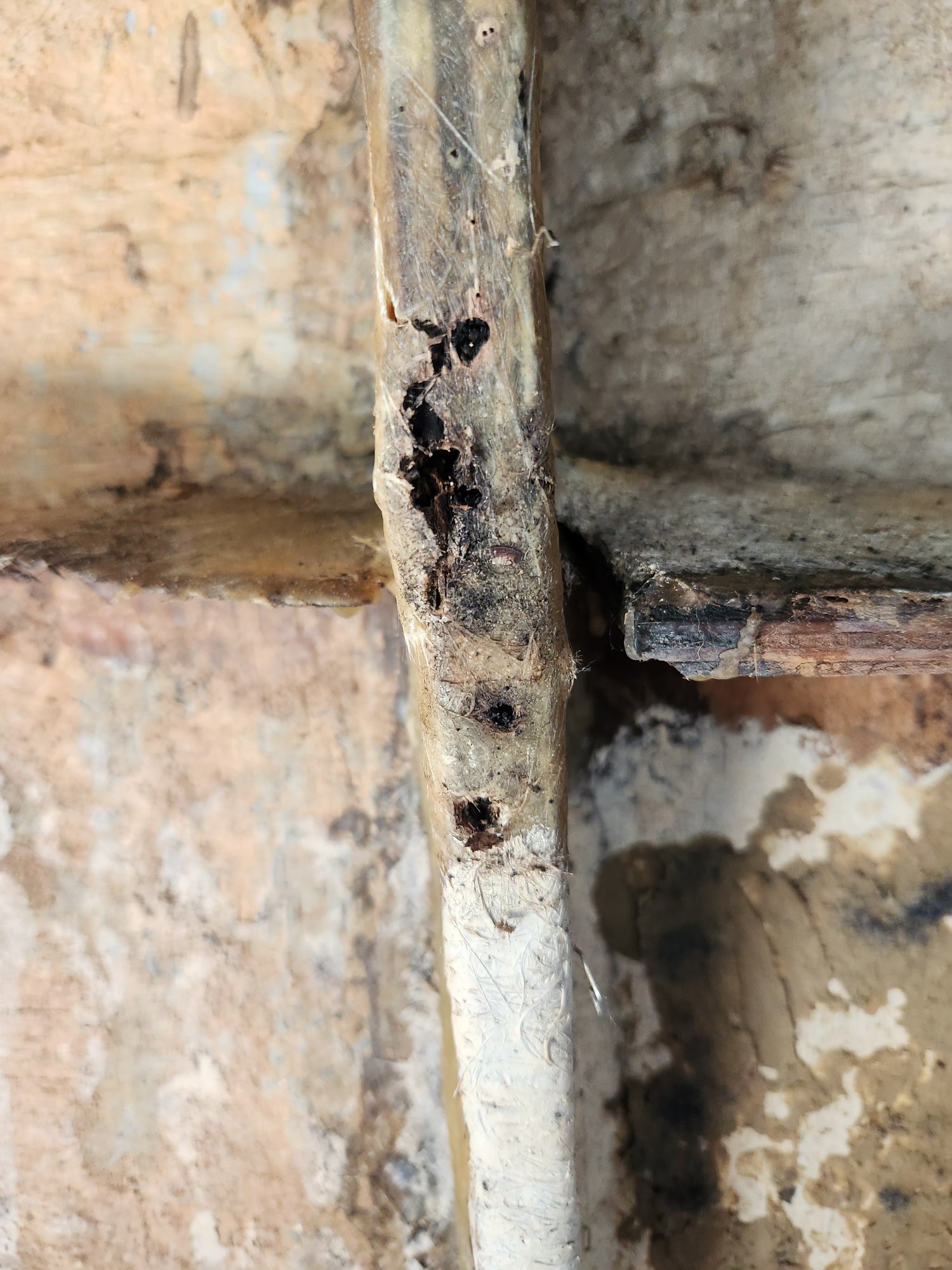

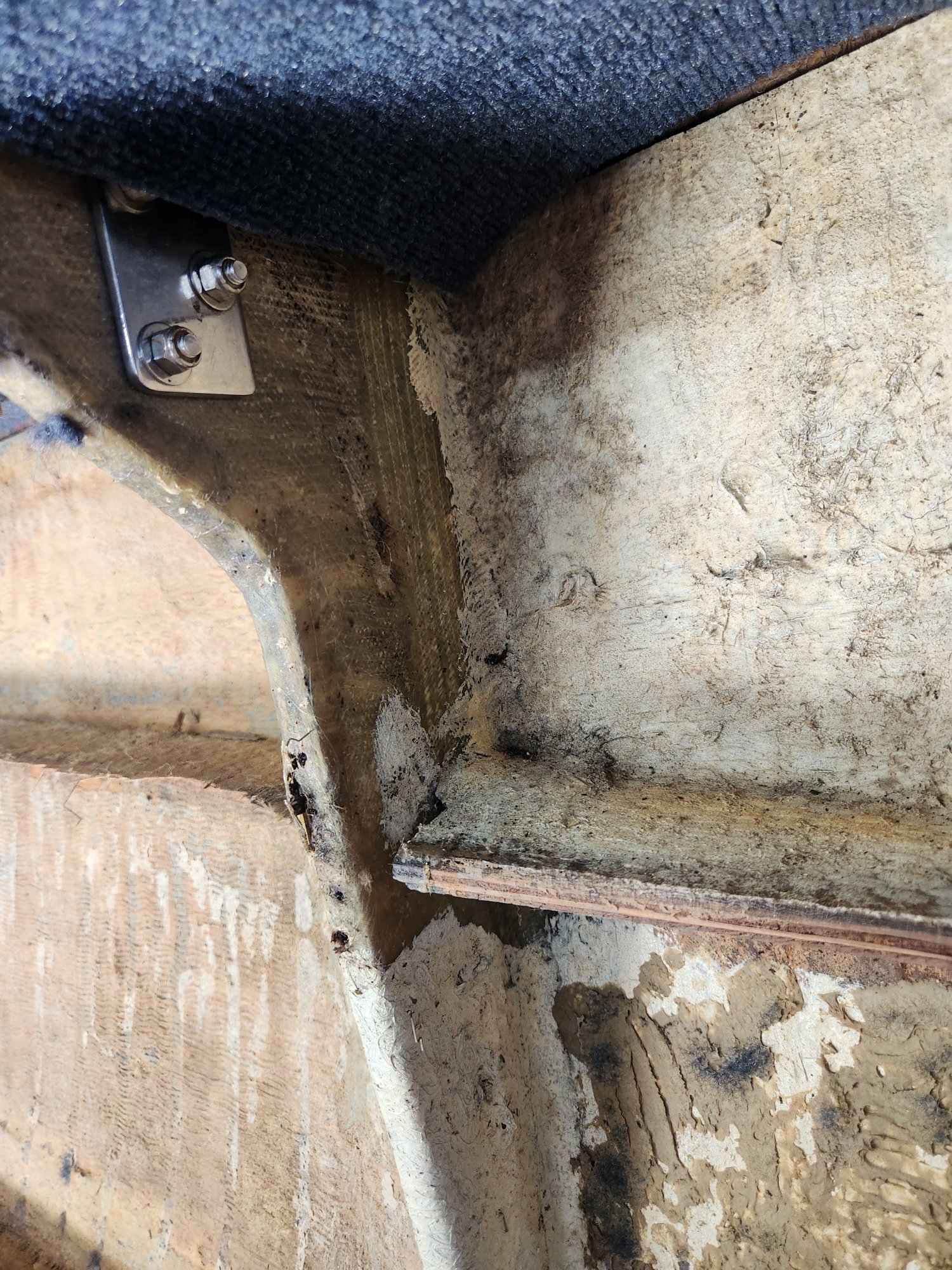

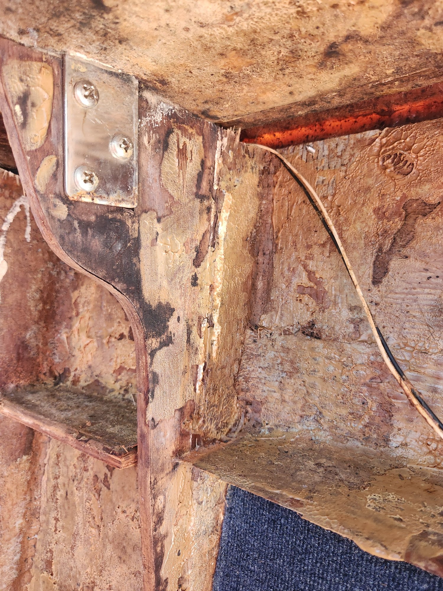

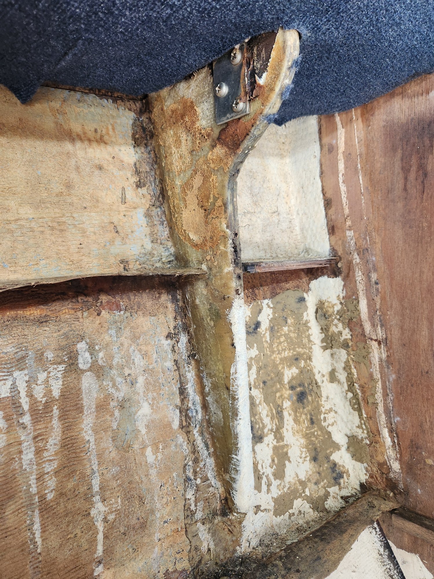

Upon removing the carpeting covering the main chain plates, I've discovered that most of the plywood is not in good shape. The port chain plate plywood was glassed over and looks gnarly underneath. The starboard one is in slightly better shape (but not glassed over?), but because I've already got her down to the bones, is it worth to replace them both?

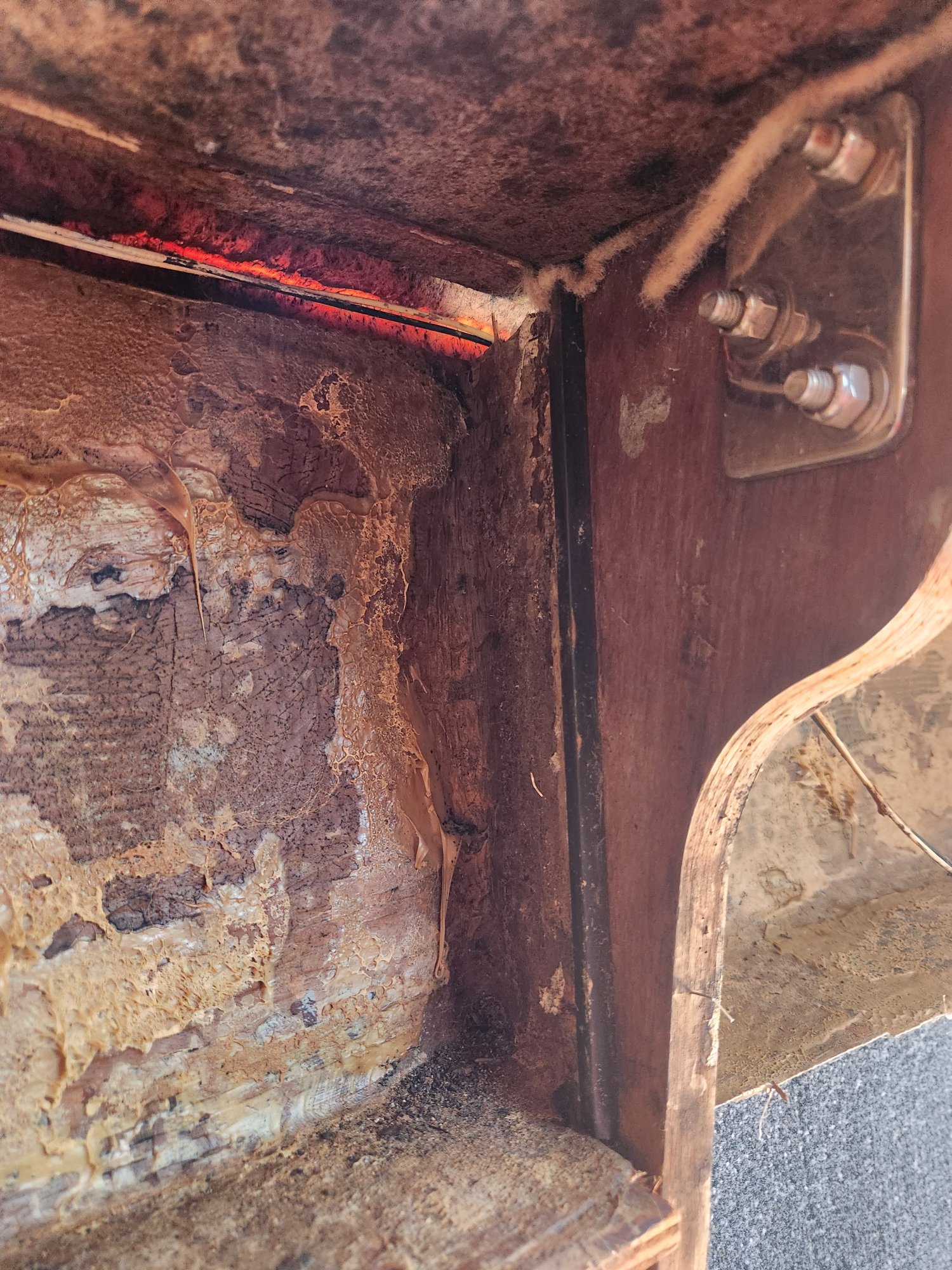

Additionally, when removing the carpeting, I had the wonderful discovery that some of the carpet glue has chemically changed and is now the texture and tackiness of melted laffy taffy. Does anyone have suggestions for easy removal? I'm hoping that a pressure washer might take it off, but I'd rather it not flow into the bilges and gum up in there. I'm planning on doing a high concentrate bleach spray to kill and remaining mold and living things inside before starting rebuild.

I'd replace the chain plate bulkheads. I had one crack, luckily it was a light wind day and the bolts kept the plate and side stay from pulling out. The PO had not done a good job of sealing the chain plate covers on the deck and water soaked into the surprisingly not epoxied end grain of the plywood.
I made new ones from high grade ply and added a layer of eighth inch ply glued to the back side as an extra measure. I epoxied the top edge. Glued the bulkhead to the hull with thickened epoxy on its edge, with the plate attached and through the deck slot to ensure alignment. Once set I used biaxial glass cloth to tab to the hull. I never got around to finishing or attempting to apply veneer to match the rest of the teak.
It'll be a lot easier for you as you don't have to remove the fiddle on the shelving.
I used butyl tape to waterproof the screw holes and deck slot under the cover plate. It's very gooey and gets compressed into the gaps but is not an adhesive so you can later remove the plate.
Absolutely! Welcome to the forum. :beer:

mineral oil will help with the carpet glue. Goof off and other similar products are mostly mineral oil.
Put a rag on the glue and wet it with mineral oil... let it soak over night and then use a scrapper to work it off. In the end elbow greese is the best remover.

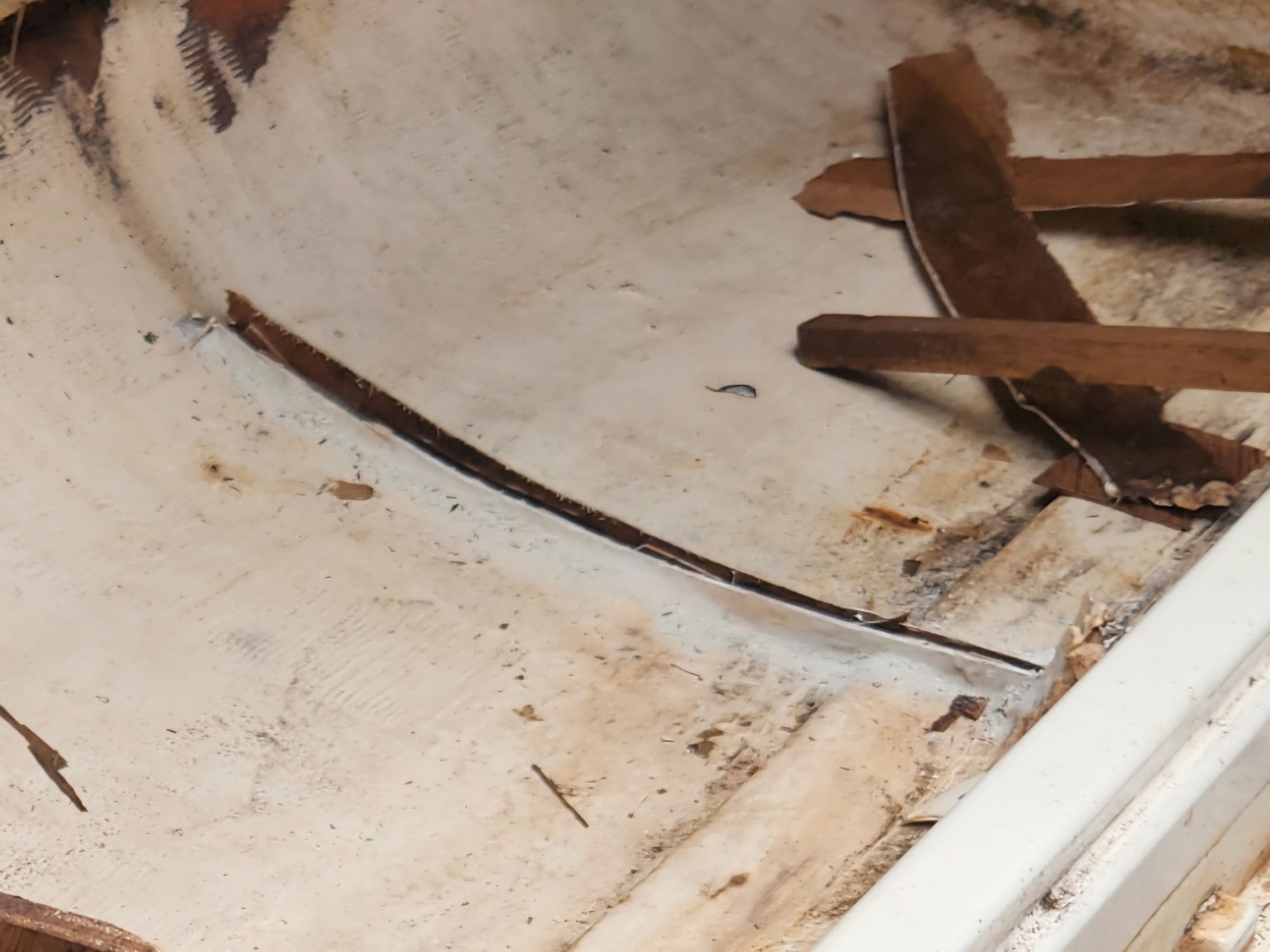

Thanks for the advice on the glue residue. It's coming off easier than I expected. Next major question. I'm going to start the furniture rebuild, do I need to grind the last bits of old glass flush, or can I leave the previous fillets as locators/mounts for new wood?
