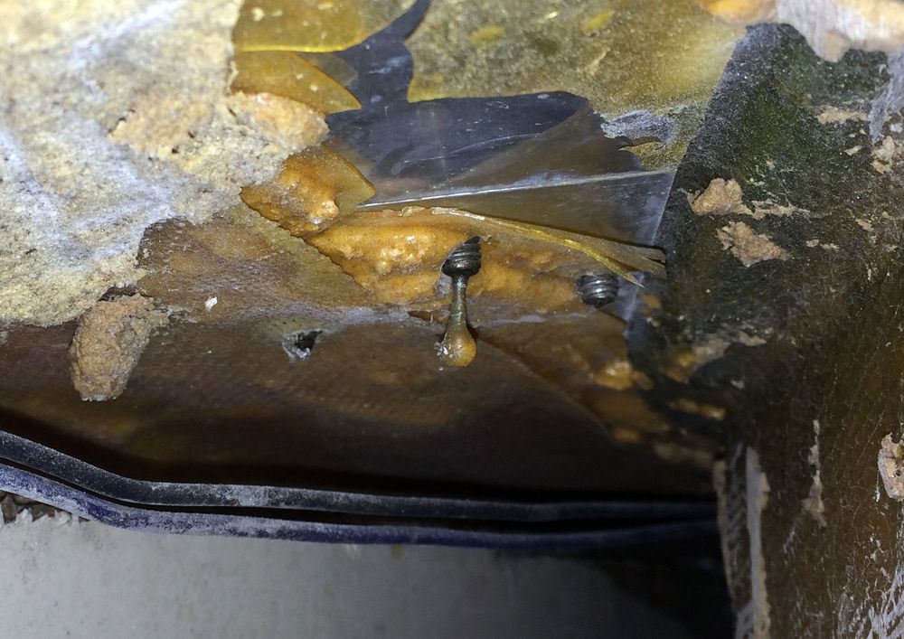

I seem to recall that the OEM gudgeons are in threaded metal plates. I need to go back and look at my old photos and see if they have backing nuts. Too many projects ago.
They use plates, but not threaded:
New Design backstays employ threaded SS plates, as do the aft ends of the bow pulpit. Incredibly THIN plates, in the case of the pulpit. More like sheet metal:
Interesting !
At least if someone needed to remove the pulpit they would not have to chop the fiberglass to get to some spinning nuts.
Did you work on the pulpit or is that someone else's photo ?

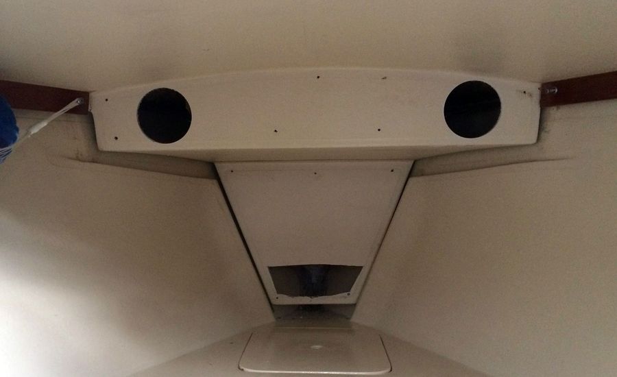

Good point about the spinning nuts! Especially because the only way to access the nuts would be to cut two big holes in the ... umm ... whatever you call the surface where these two big round holes are cut.
AFTER cutting the holes, I realized there were no nuts to deal with. Oh well. Now the boat is much lighter and faster. :thumbup:

Speed holes !
They look big enough for some speakers to hide them. So we can call that section the forward subwoofer !
Interesting. There must have been a design change somewhere along the line. I have the 87 New design and the gudgeons are threaded brass bar stock. The lower one is easily reachable. The upper one I used threaded rods to hold in place while re-bedding the gudgeons to avoid cutting the hole pictured. Nuts on either of those locations would be a total pain.

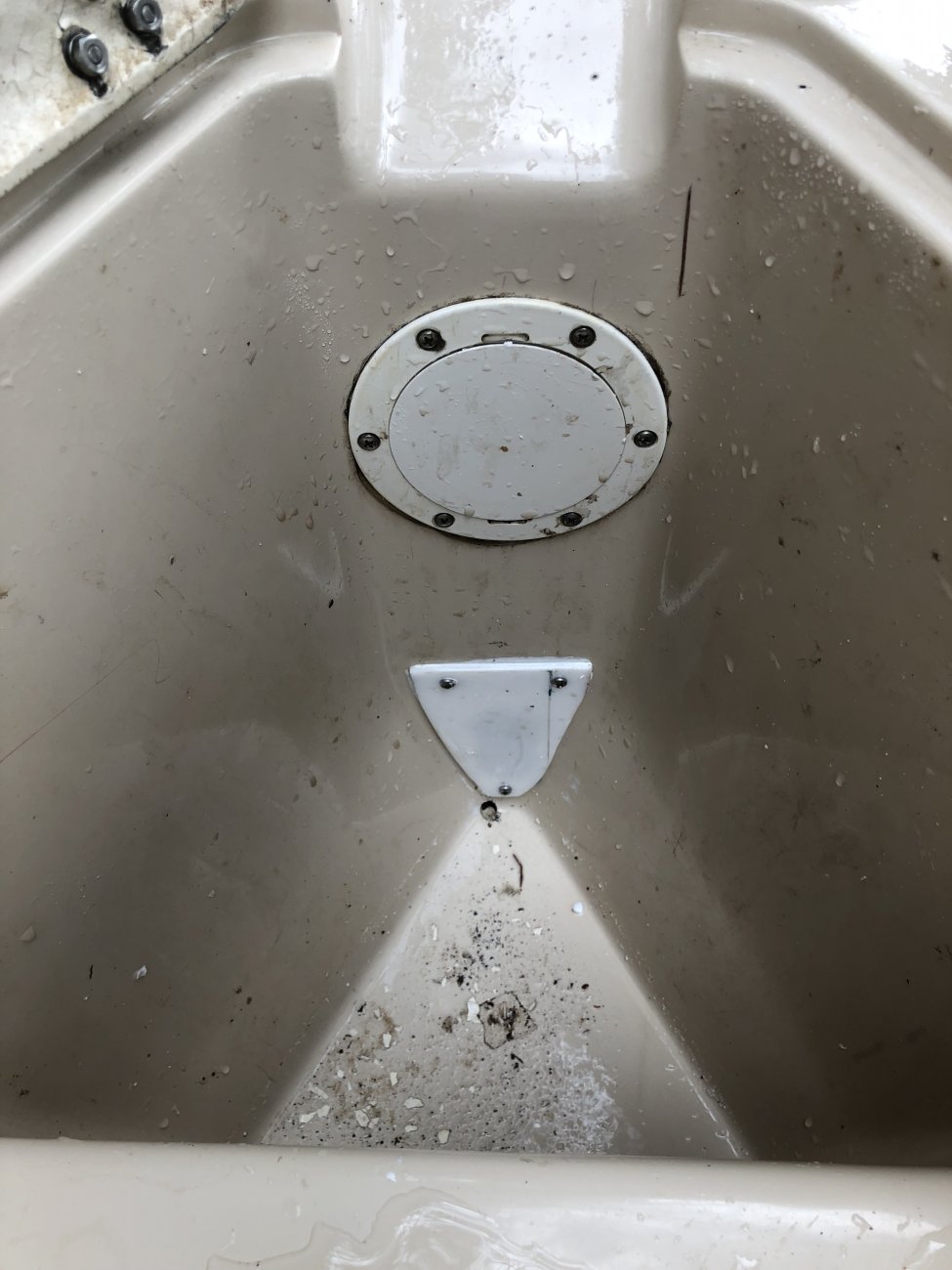

on an unrelated topic since you cut the holes is there access to the anchor locker drain or the bow eye in there? Always wonder what I would do if the bow eye pulled out and I have a very minor leak form the anchor locker drain.
I don't think so.

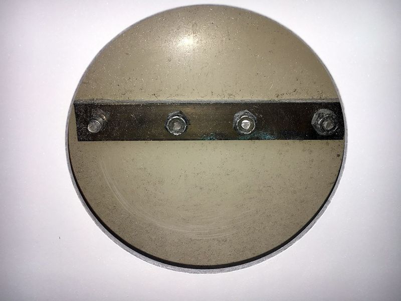

There was a guy here some years ago who used an 1 1/2" paddle bit to create an access hole for that mythical lower bow eye nut. He indicated that it was then easy to replace his rotten backing block . His pic:
Ouch! Hopefully mine does not pull out any time soon. With so many different launch ramps used in a year thought I am afraid it will be inevitable at some point. Oh well that's a tack for another time. Thanks for the picture and the replay. Sorry to highjack this thread a bit.
