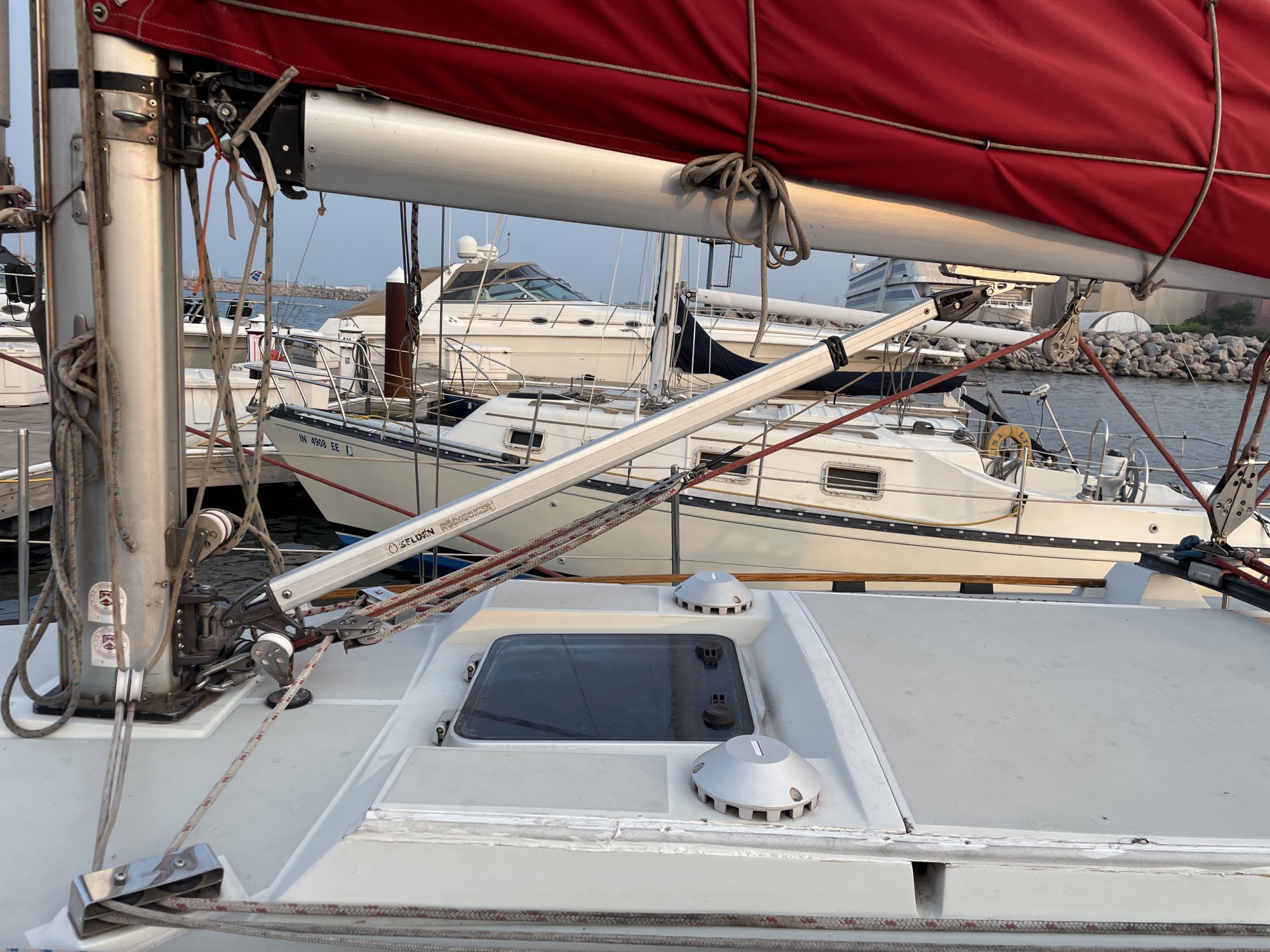

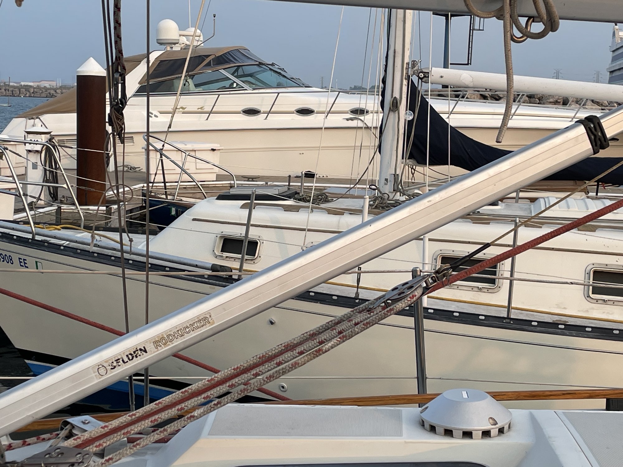

- how much does your boom weigh…? Not specifically, but these things have some sort of spring to keep it rigid. In the case of Seldon, it is a gas-charged strut. You need to order it with the right newton of force.
In my case, I found a used Seldon rigid vang from a fellow SBO member, but the gas strut was shot. I was able to order a new strut for it, and rebuild vang.
It wasn’t ordered for my boat specifically, but I knew it came off a similarly sized boat. I did upgrade the spring from the original strength to a stronger spring. I was able to make small adjustments to my mainsheet tackle to get the rigid vang in place.
