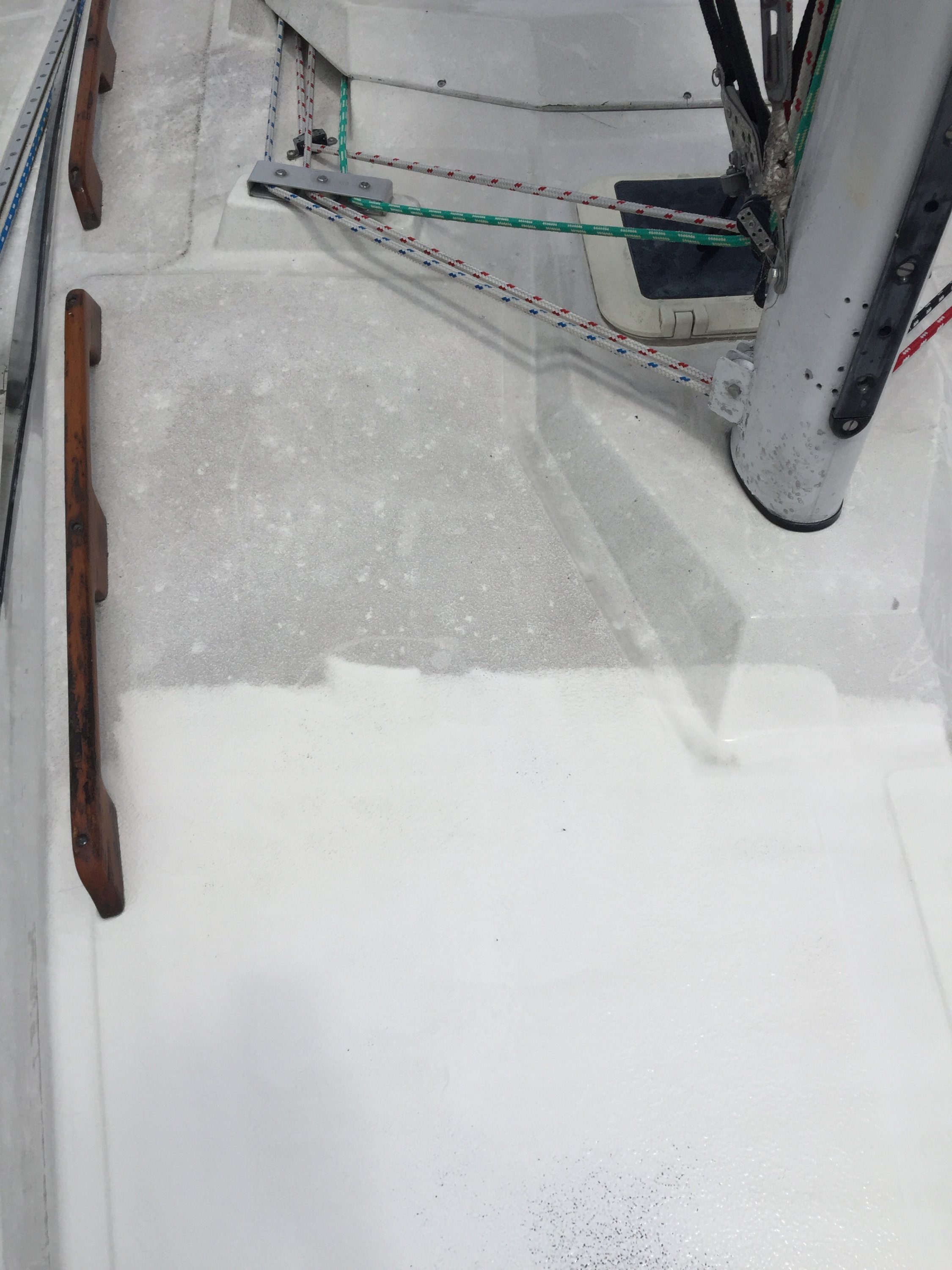

For my non skid top deck I use tile sealer the sell at home depot. The non slip type seals pours and keeps mold mildue at bay and it's not slippery like wax. I use wax on sides to keep shiny
It would be nice to know the exact sealer brane that you used as some will leave a gloss. Does it make the deck more slippery? Thanks
