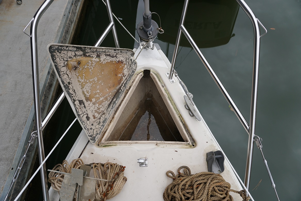

Anchor? Davinport 25lb, a smaller anchor, and a decent rode. Anchor locker? full of 2 feet of water. Good thing I found a working hand pump! Does this thing have a drain? I didn't see one. Maybe its just blocked with dirt.

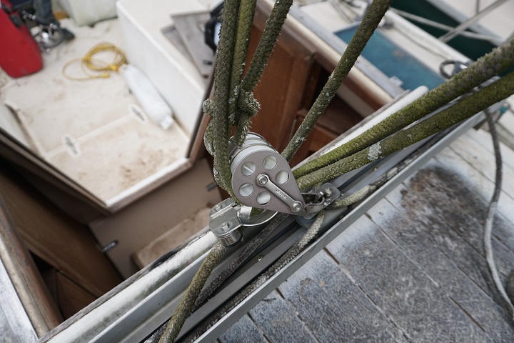

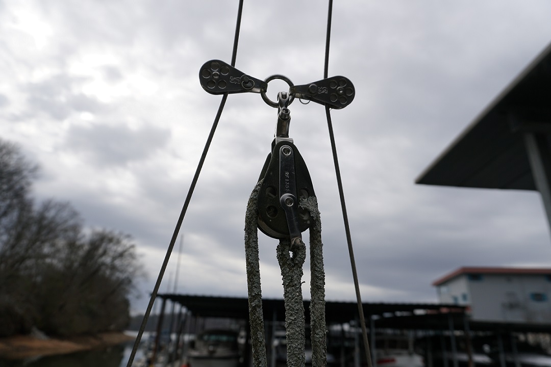

Main looks ok, and the cars travel freely. Some of the blocks even look new:

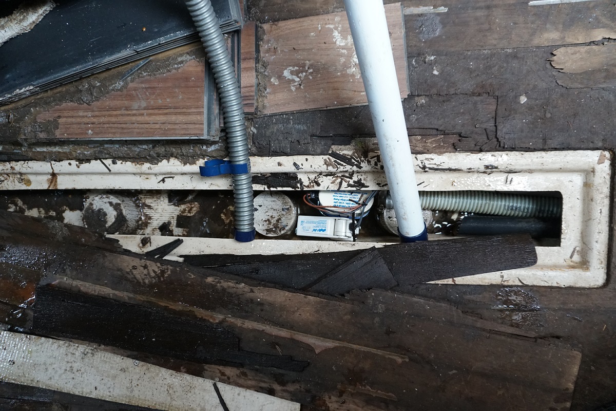

Bilge pump is new. Tested all the wiring, checked out. I put in a new battery, connected the battery charger to shore power, flipped the main electric switch, manually lifted the bilge pump auto-switch, and it ran. Good.
Bad, plumbing issues somewhere mean that after the pump empties out all the water and shuts off, most of it just flows back into the bilge. Is this how its suppose to work?

1. To where does the bilge discharge? There is a hose that goes way around to port, but then it dissapears into a place I have not been able to access, which may require tearing into the head.

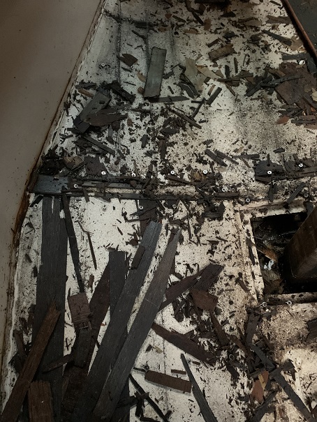

2. What to do about the floor? I assume its wood glued to the fiberglass? Try to salvage? Totally gut and replace?

The anchor looks OK but you may want some chain.
The anchor locker most probably has a drain. Look for it on the outside of the hull. You should flush and drain it until the dirt and paint chips are gone and water drains freely.
Bilge pumps exit the hull above the waterline. It is regular for the water in the hose to drain back into the bilge when the pump shuts off. You can put a one way valve in but many feel this slows the water stream down and retains water in the hose.
The cabin sole is shot. Don't waste time with repair. Replace. I don't know how that boat was constructed. But if the sole is wood it was probably built on stringers which cross the cabin athwartships. You would need a sub-floor of marine ply. I'd consider putting a carpet remnant over the sub-floor and be done with it. Replace as necessary.

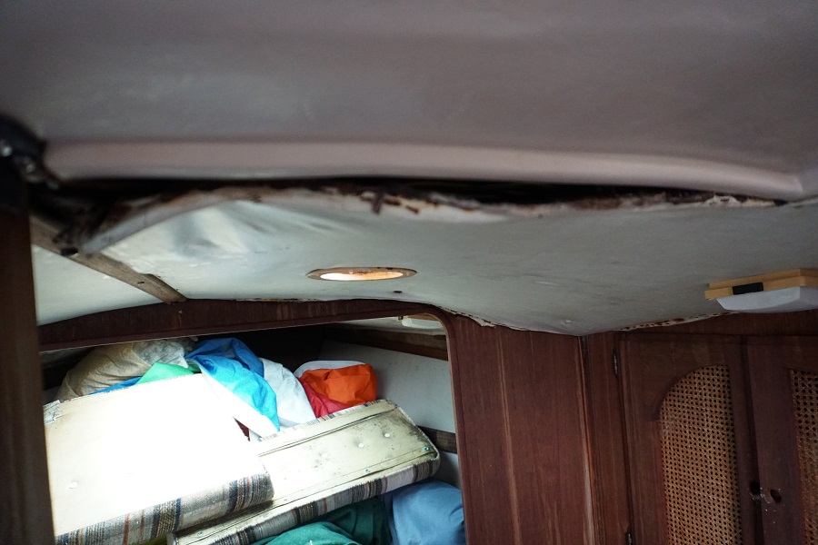

Take down the headliner. Don't bother trying to re-glue it. Consider painting the underside of the deck.
Bilge should discharge overboard. You may have a hole in the stern or one on the side of the boat. Stern is most likely. The condition of the boat may have the hose from the pump broken of clogged. You will need to find both ends of the hose and securely attach it to the through hull so that water from the pump dumps outside of the boat.
I would gut all the damaged wood. If you still have enough solid wood left you could patch it. There is nothing wrong with dumping all of it and starting fresh. A big concern it that the wood the forms the inner frame of the boat may be rotted. This needs to be removed and replaced. The boats outer skin is held in shape by the inner frame. Some boats use wood to construct this inner frame some use fiberglass.

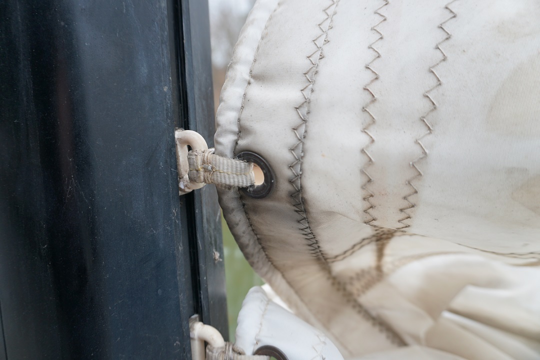

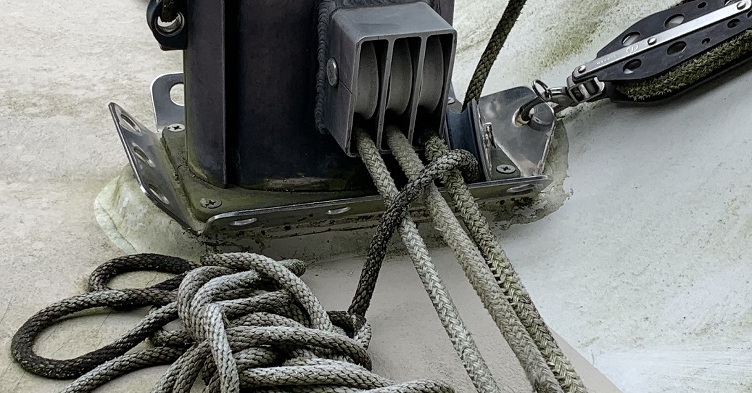

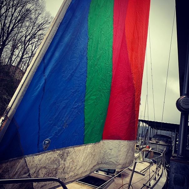

Got the big 155 Genoa up, back on the furler, all things work as expected except the wench. The wench won't grip the line unless I apply pressure, this is difficult. I may still look for a asymmetrical spinnaker but the 155 is probably a very nice light air sail.
With the help of some internet friends, I discovered that the boat is setup for a spinnaker pole, with halyard, and topping lift ran through mast, mast pole travel car, but not a pole. There are mounting points for holding the pole on the deck, but the pole is missing. That's fine, I don't actually want to fly with a pole anyhow. Because I would like a big asym, I'll probably end up using one of the halyards for the pole, if its strong enough, since its already run through the mast and ready to go.

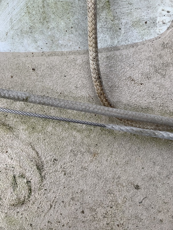

More research let me get the headsail up, and apparently it has a wire halyard that transitions to poly line:
Is the wire suppose to come this far out of the mast? If this is fine, I won't worry about it, but in order to keep the headsail up, its going to have to stay like this.

Literally just scooped it out with my hand. No stringers, just a false glass floor which had plywood screwed down and teak on top. Will replace with plywood. The real question, to varnish?, epoxy?, stain and leave natural? How to finish?

Yes the wire/line (rope) halyard is a thing from the 80’s. The wire comes out of the mast and down to the winch or cleat at the mast base as the sail goes up.
Sep 8, 2020
15
NerwPort 27 Lakeshore Marina
Sorry for the autocorrect. Winch slips, I'll have to research that.
I was wondering if leaving the splice end exposed would be not good? Maybe its fine.
Jul 7, 2004
8,534
Hunter 30T Cheney, KS
They screeech something awful when they don't work properly
24,519
John eventually whether hidden or exposed we all turn to dust.
Use the halyards and sail a lot. When you get home drop the sail and secure the boat safely away. Your wire/line spices should retract into the mast, if they run through the mast when you drop the sail. If they are outside the mast nothing can be done to hide them.
Eventually we all replace our halyards.
When I refit my mast, I changed the halyards to line. I like the feel. Eventually they will wear out and I will need to replace. I intend to have as much fun as possible with them as long as they last.

The cabin ceiling plywood is in great condition, with mold covering the vinyl hopefully easy to clean. After a few weeks of the plastic covering, I have detected two leaks through the deck hardware, one forward port, and one aft starboard. There is also a concerning hole in the deck just below the mast plate. It's L-shaped, doesn't seem to leak, but seems to have been cut from the inside. I can't figure out why this was done, or if it was original to the boat.
I took the floor up completely, and vacuumed the entire boat. The cabin sole just scooped away by hand, only being held together by hope. Scrubbing the V-berth, it is vastly improved. I painted all the wood with diluted Tea Tree Oil which smells much more lovely than the vinegar I used in the initial cleaning. The water tank which is situated under the V-berth may be usable, but after 40 years, and unknown neglect, I have elected to replace it, probably with a bag type unit of larger volume.

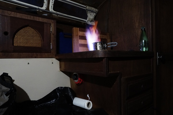

I got the stove working! A great triumph, celebrated with morning Coffee.

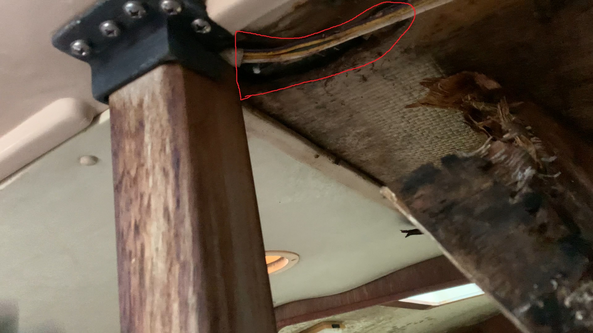

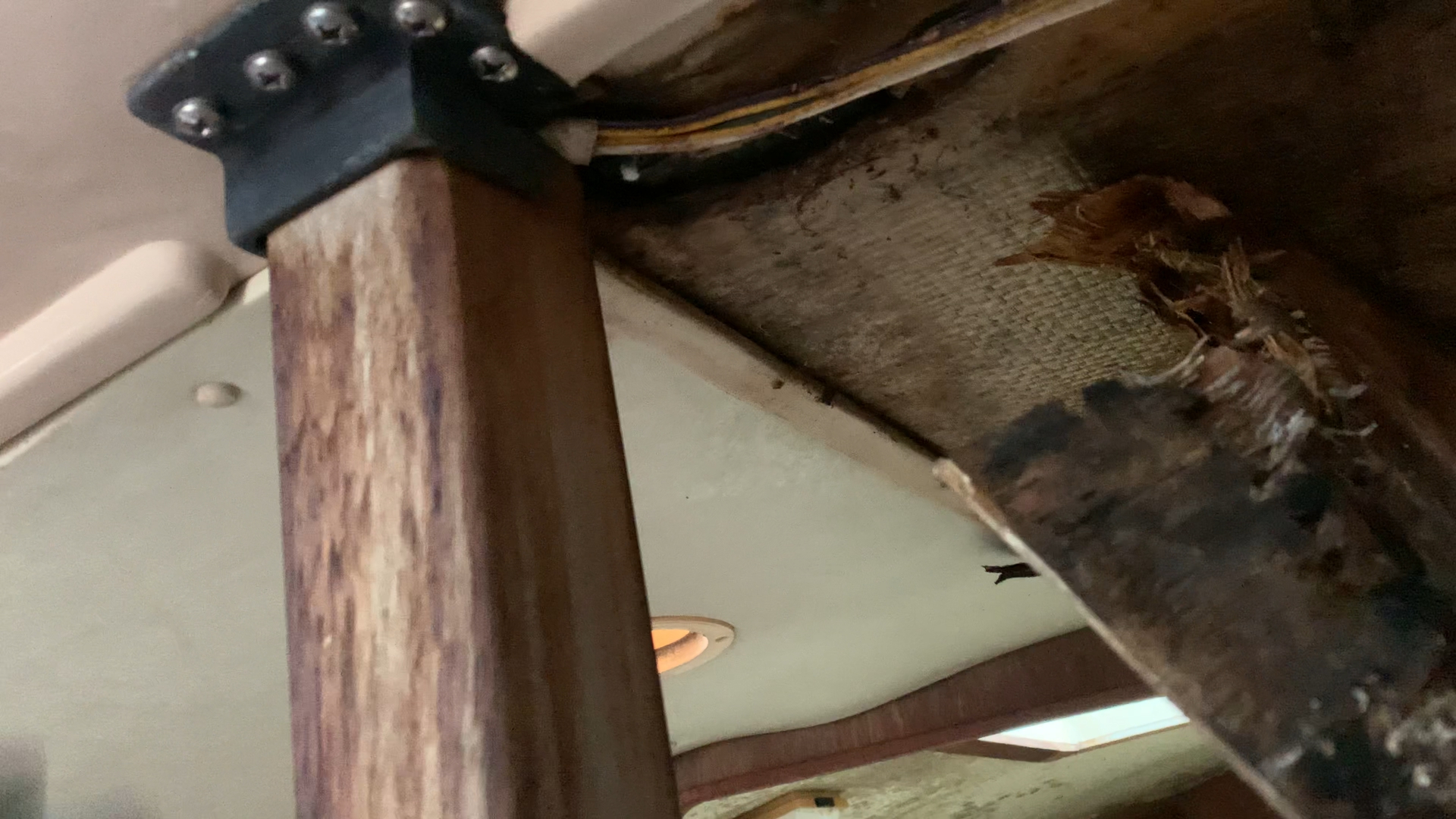

Only one additional panel of interior wood will need replaced due to rot. That is a success I feel.
Final question for the day, how to deal with the paint on the underside/interior of the fiberglass, which is pealing away in some places? More research is needed.
Likes: kloudie1
Sep 8, 2020
15
Can you provide us with a photo?
This is the best photo I have currently. I can get you a better one tomorrow. The hole in the fiberglass extends from the mast support beam, just above that wiring, to the right, in this photo, some 4 inches. There is wood above the hole, it is not rotten, and it doesn't seem to leak.
I am scheduled to have bottom paint done next month, when they will de-step the mast, and my plan was to simply glass in this hole?
