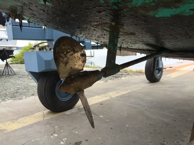

I decided to got through with the purchase of a 1986 Hunter 31. The engine runs great and the survey checked out okay with the exception of the prop shaft being disconnected from the transmission. The previous owner reported that there was a strong vibration. I know that the cutlass bearing was replaced and only has a couple of hours on it but the surveyor noted approximately 1/32 of play between the bearing and prop shaft. The boat is currently on the hard getting a bottom job so my first step is to pull the shaft and have it taken to a machine shop to make sure it is straight. If that checks out, I'm moving onto cutlass bearing and alignment. Surveyor said they mounts felt secure and does not think they are bad. My question is, with the boat already on the hard should I go ahead and replace the entire strut. I talked with the hunter store today and the strut comes with a new bearing so I would save on the labor to remove the old one and install the new one. I can't spot anything wrong by eye with my strut but I really don't want to put the boat back in after only doing the cutlass and then have to pull it again to replace the strut. If anyone has any history with strong vibration caused by a bent strut it would be greatly appreciated. The previous owner noted the vibration / shaking was so bad he could get it to full RPM when in gear. Thanks in advance
