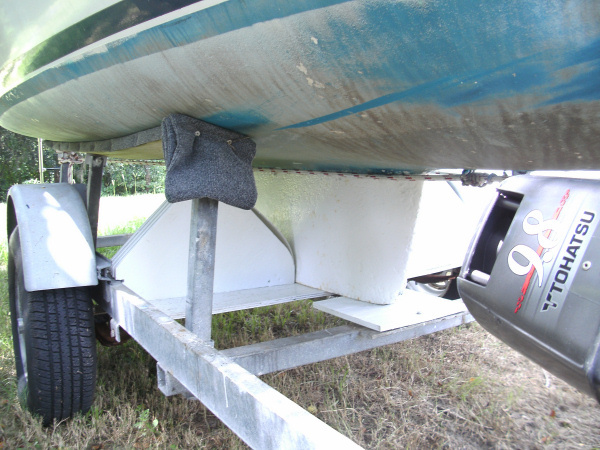

I have posted a few photos on my page illustrating my latest attempt to improve trailering. It worked well the first time out.
More illustrations are available by clicking on my name and going to my photo albums, one of which with the same title. This is made of 19/32" AB plywood, glue and screws, painted with Rustoleum oil base. The surface the keel slides against toward center is covered with plastic salvaged from a 55 gallon drum. The design can be modified of course; this evolved as I was going along and was done with a half sheet of plywood plus scrap. Essentially it incorporates the idea that once the boat is drawn to the winch as you haul the trailer out the trailer comes upward engaging the keel to center.what are they made of and how did you secure them? what does the bachside of them look like? Looks VERY helpful

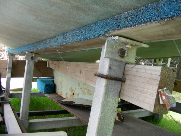

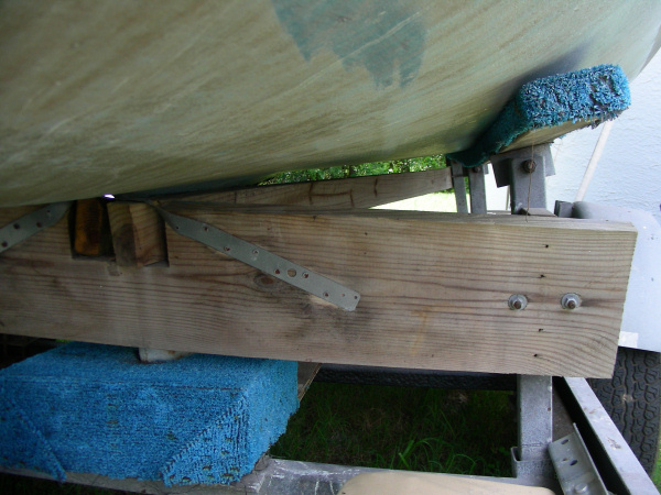

Jim, I've been using my version of your idea for years, and it's worked very well. I used (non pressure treated) 2x4 guides, though, and after breaking another (with the help of termites) in the manner you described I undertook this experiment. If this doesn't prove itself I'll go back to your version (with treated lumber of your suggested dimensions).It looks functionally similar to the solution I developed for my h23 trailer. I bolted a length of 2x8 onto each bunk slanted down to the keel board immediately forward of the wings to make the keel slide down to the center of the trailer. Yours is nicer looking. The only drawback is that it does not work until the trailer to high enough for the keel to be trapped between the bunks - I once had the keel settle down on one of the bunks as I pulled the trailer and boat out of the water. I put it back into the water real fast!

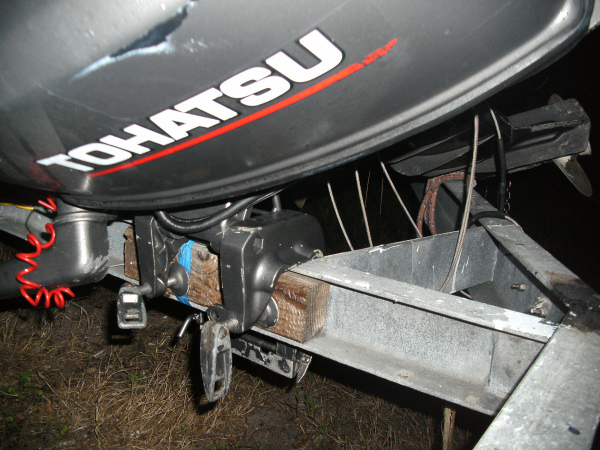

It looks like you've added something to support the outboard on the front of the trailer. Could you show/discuss that modification?
