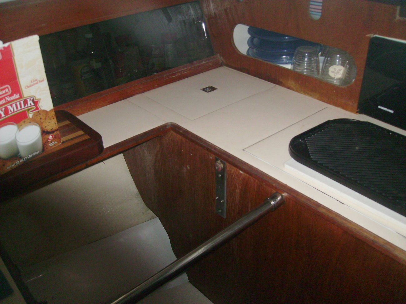

the attached photo shows my microwave in the upper right recessed behind the icebox where I cut out the wine glass bulkhead. you could also hang the microwave from the jibsheet car track bolts in the overhead

Fwiw, a super compact microwave is likely to be so LOW wattage (450-700) that that the length of time it would have to run to get anything even warm would be a huge power drain, not to mention more trouble to use it than it's worth. Try to find one that'll fit a workable space that's at least 1000w. Fwiw, put mine on a shelf behind a dinette seat...set it on the rubber "waffle" shelf liner and used quarter round around the bottom.Granted it was a powerboat, so we didn't heel much, but It did NOT move--even when the boat got tossed around by a monster wake.
