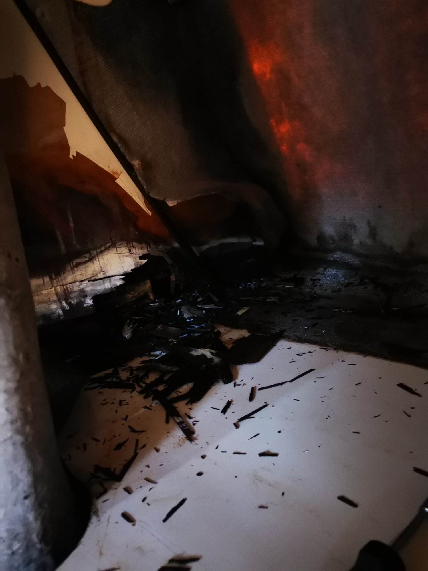

I have this weird leak at the stern of the boat right in the middle behind the engine all the way at the rear. It completely rotted the wood piece that's back there, and I'm wondering if anyone had a similar issue and what it might be?
May 27, 2004
1,699
Well, I'll play twenty questions...
Is the "exhaust thru hull" near the wet area?
Does the wet wood taste 'salty'?
Is there a cockpit/scupper drain fitting in the vicinity?
Is there a hull/deck joint nearby?
Are there any deck fittings, i.e. cleats, chain plates, etc, above or near the wet area?
How close to the wet area is the binnacle?
Has it rained a lot lately?
Is the pic a screen grab from a horror movie?
Do you have a wet/dry vac? :biggrin:

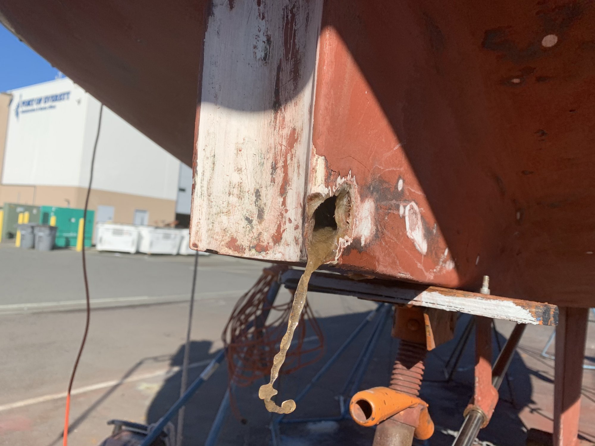

@LeslieTroyer recently repaired damage to his rudder. When we explored the damage, we discovered a crack that really was a hole and a volume of water that was leaking into the boat.
Until you get the boat out of the water, you may never know what really is going on.

I am chasing the same or similar symptoms in the same model and year (H31 1985). I replaced cockpit scupper hoses pre-launch and was confident I had it beaten as one hose was clearly shot and had visible holes when flexed slightly. Doesn’t look like it I’ve cured it yet as under way, starboard tack, the site of previous repairs to the through hull area doesn’t appear to leak. This is easy to access as it’s in the rear of the quarter berth. I could see water in the hose a few inches up when heeled to the port side. The starboard through hull is behind the fuel tank and was a merciless b^*tch to replace the hose. I’ll try and slither down there when on a port tack and take a look today. There is a history of leaks around these through hull areas on H31-34 boats of this vintage.
