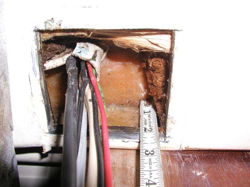

10,256
Mast Support Beam
Tons of info in the H-34 files. The 31 and the 34 both have that Achilles Heel .. The crack is most likely the compression post punching up into the horizontal beam. The wood inside the horizontal beam rots and then nothing is there to resist the compression of the mast, so the compression post cracks the horizontal beam.. Allen and Scott covered it pretty well.
Picture is looking at the place where the compression post would normally be. It has been removed and a hole the exact size of the post was cut in the bottom of the beam. My cross beam had collapsed enough that the little PVC conduit was trying to take the compression load. It had split and the caulking had failed. Not an easy job but it is straightforward.
