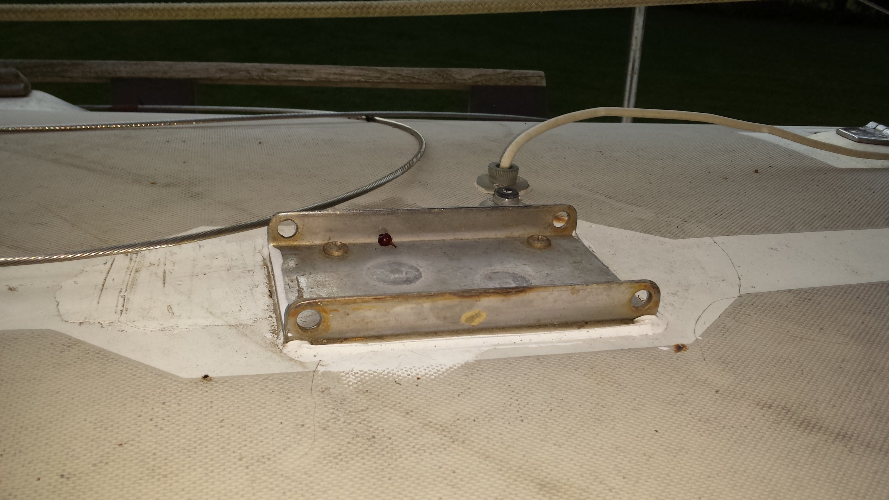

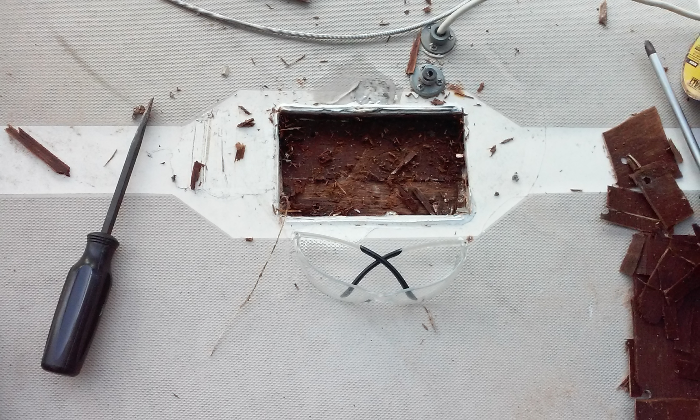

First, I've cut out my mast step to match the footprint of the mast hinge bracket. I can see that the plywood rot will extend out further than what I've cut. Should I cut maybe 2" square around what I've already cut until it feels fairly dry or should I get strait to cutting out as far as the furthest crack from what I've already cut? How big a deal is it that I am going to have to cut into the grip material and is there anything special I need to know in dealing with it?

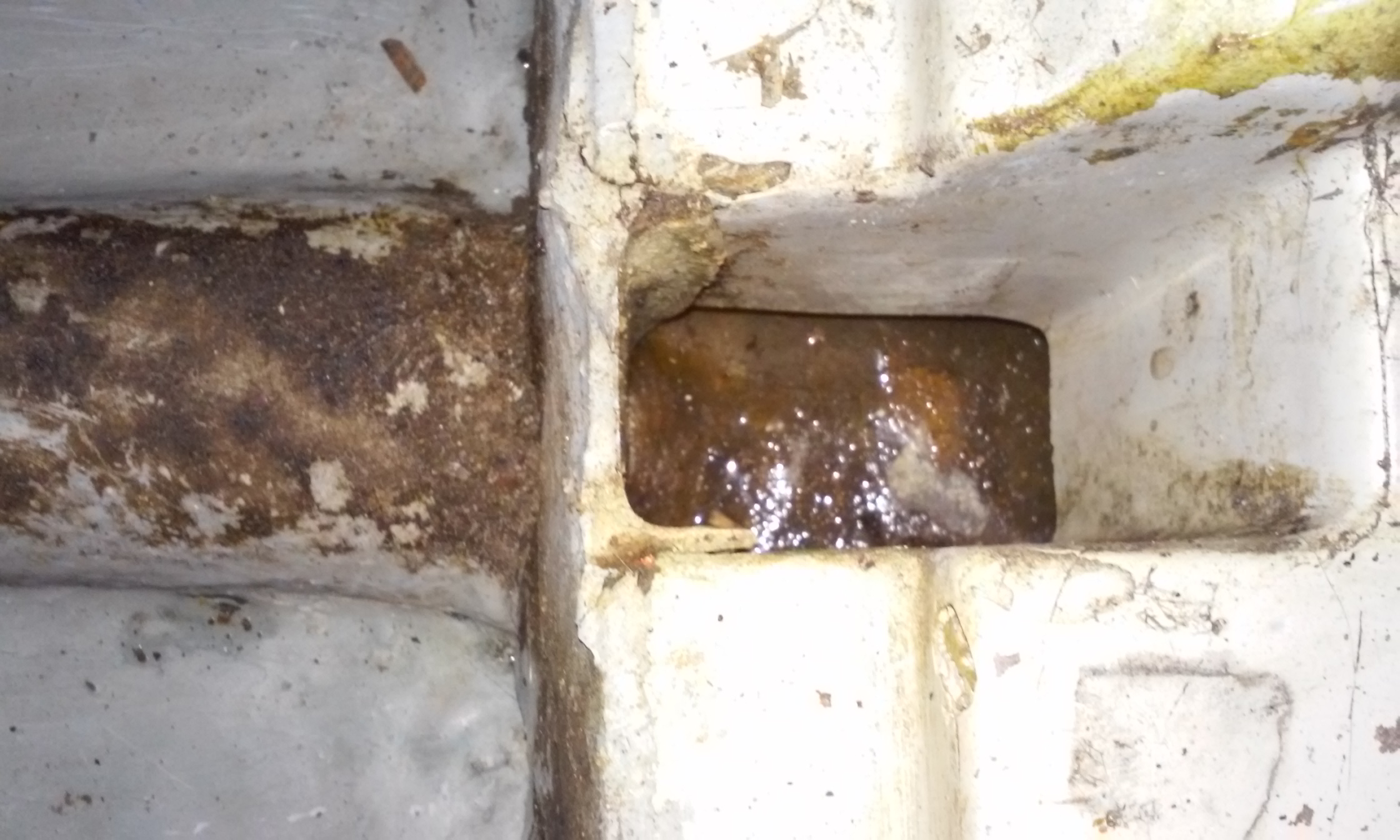

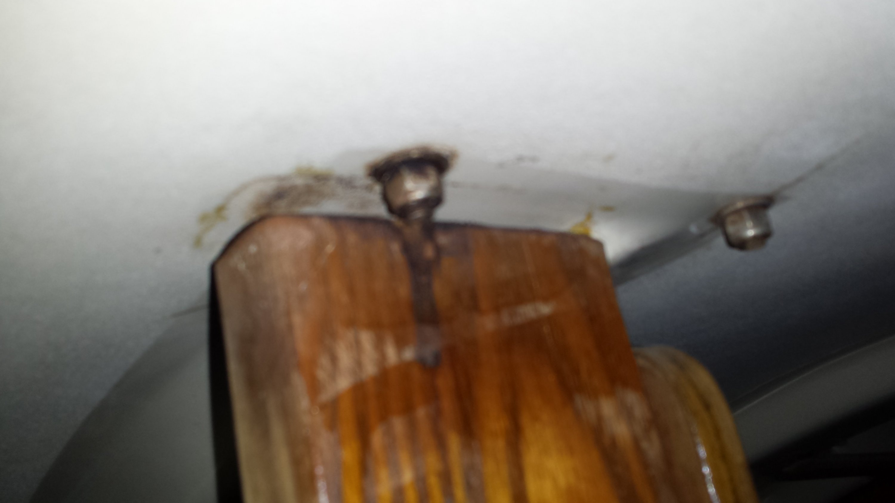

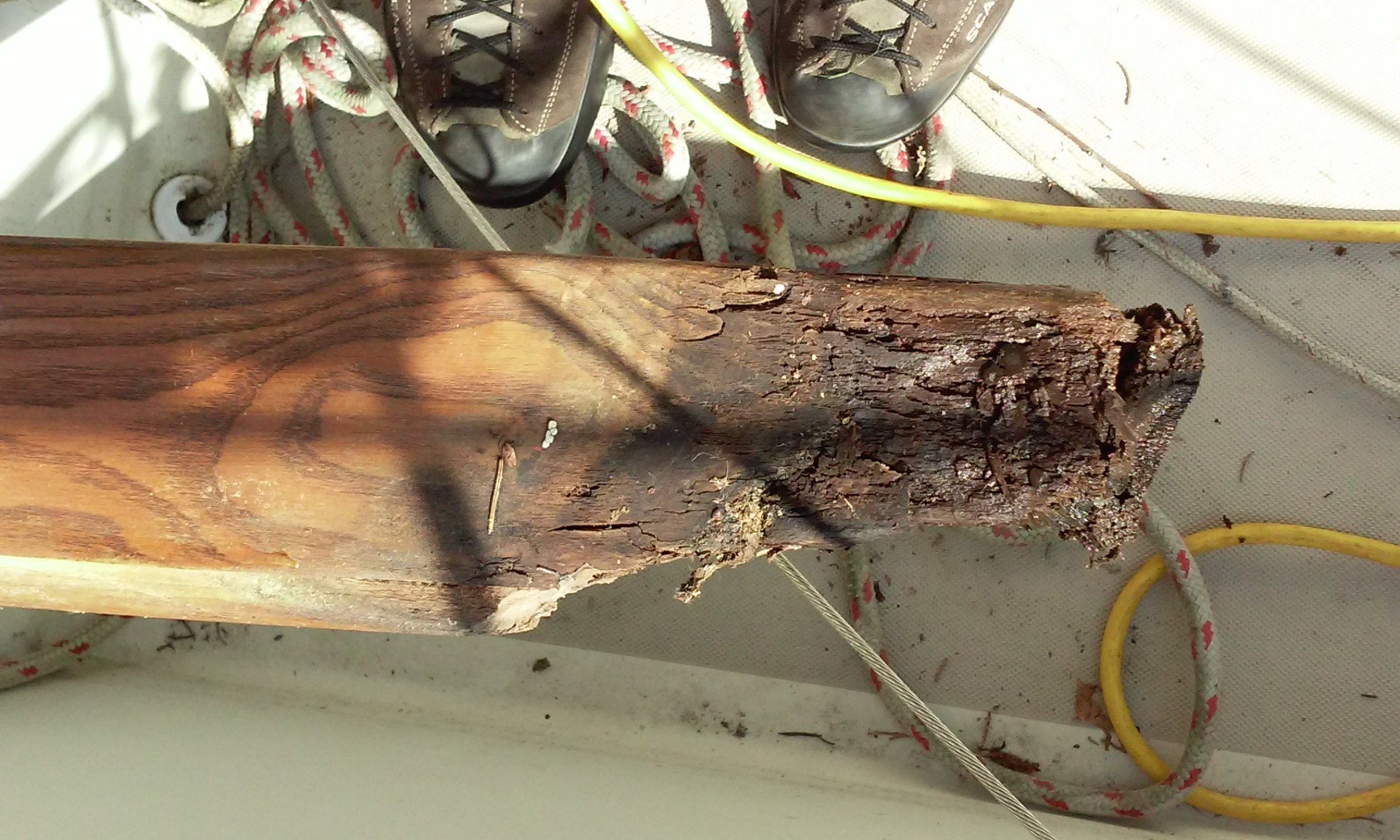

Second, water had filled in the compression post hole in the cabin floor. is this normal? As you will see in the pictures it rotted out the bottom of the compression post causing all the issues.
