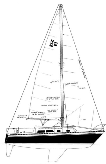

We just bought this wonderful boat. A previous owner extended the boom and re-rigged the mainsail sheet for single handing. We don't like how the locking cam cleat for the sheet at the end of the extended boom doesn't work well. Maybe we would rather bring the sheet through the dodger and give up the single handed set up. I was wondering if some other owners of this boat could show us photos of their boom so we can see the original position of the sheet, or maybe someone has it going through a dodger. Would love ideas of how to rerig it closer to its original design.

Here is an image with the mainsheet rigging mid-boom.
While a mid-boom rig is feasible, you compromise some sailing functions while gaining more cockpit space without the boom intruding.

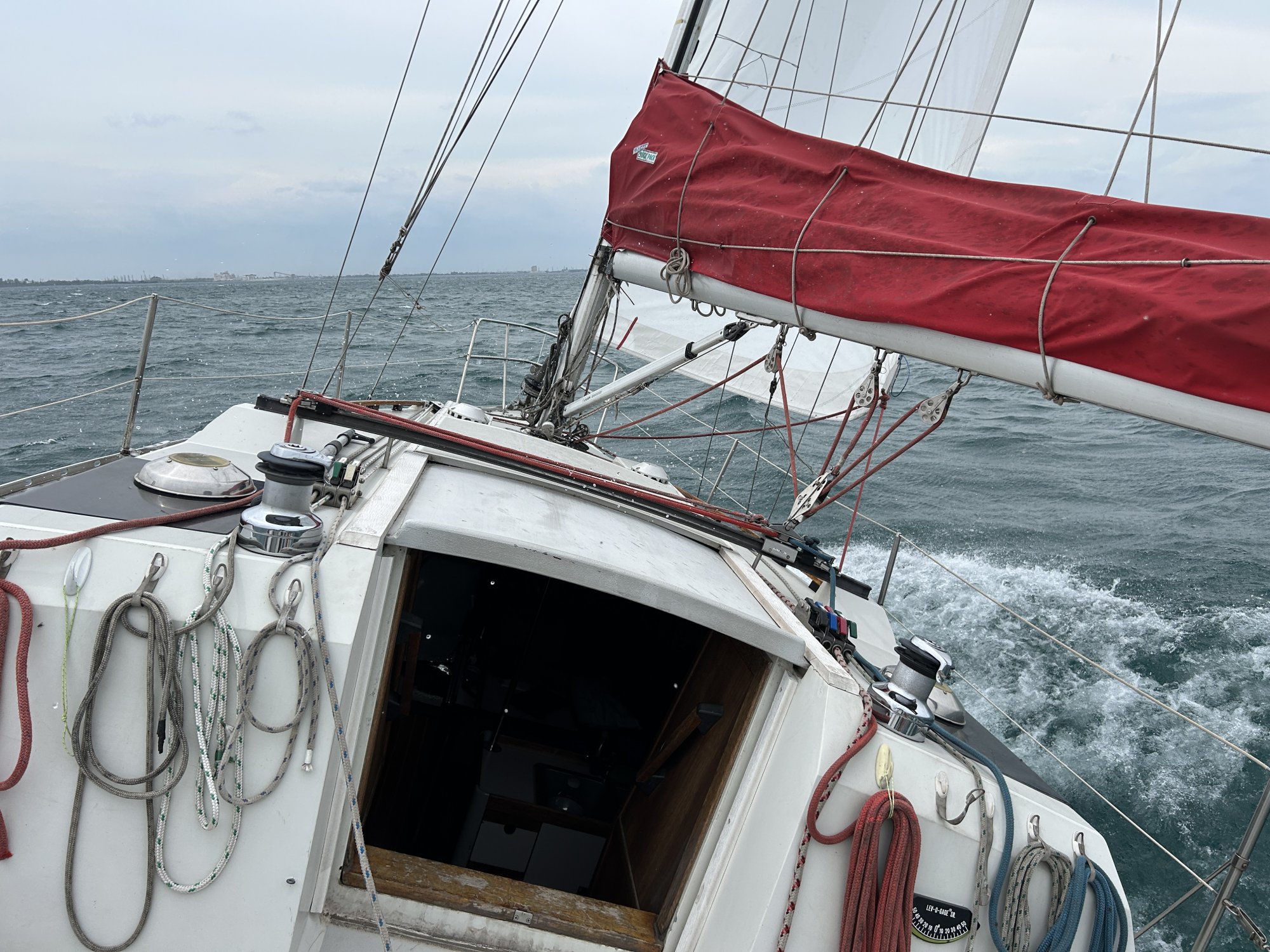

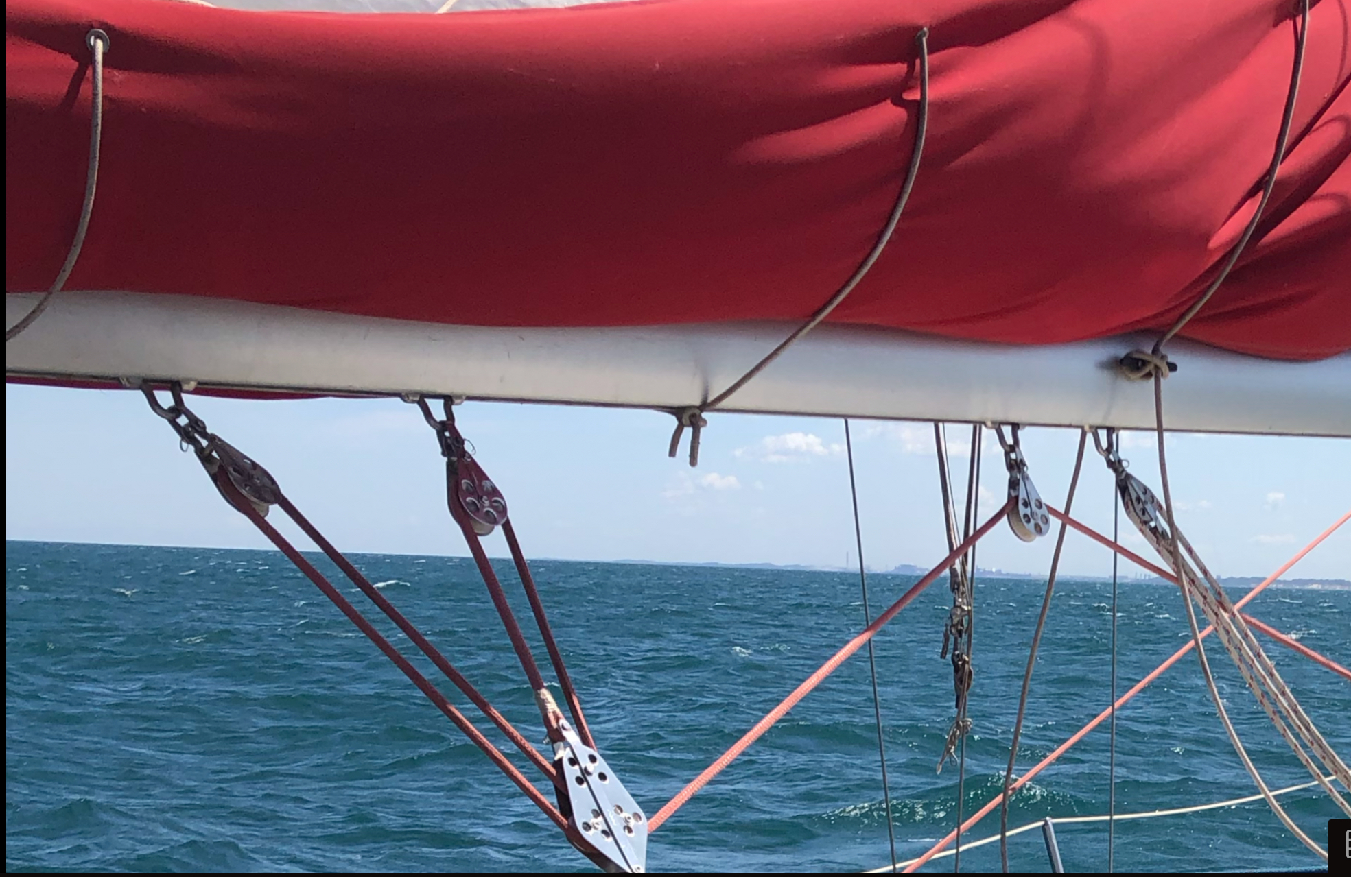

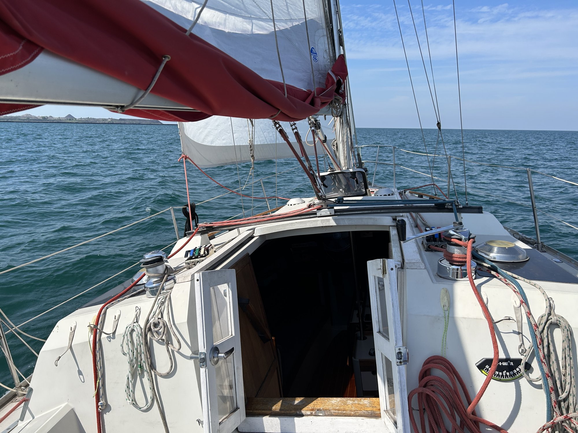

Some photos would be really helpful to understand the current mods.
I have an O’Day 322, which is also a mast-head sloop. My boat has mid-boom sheeting, with a traveller and 6:1 mainsheet.
You see the arrangement in these photos.
The last photo is a closeup of the mainsheet, but there is also a vang on the far right of the shot (white flecked line). I have replaced that vang with a rigid vang after that shot was taken (you can see the rigid vang in the first 2 photos).
My mainsheet comes back to the cockpit as do my traveller lines.
