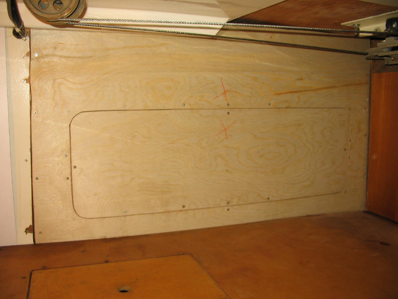

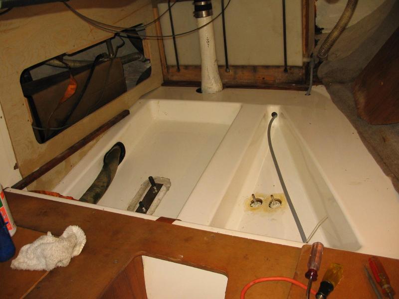

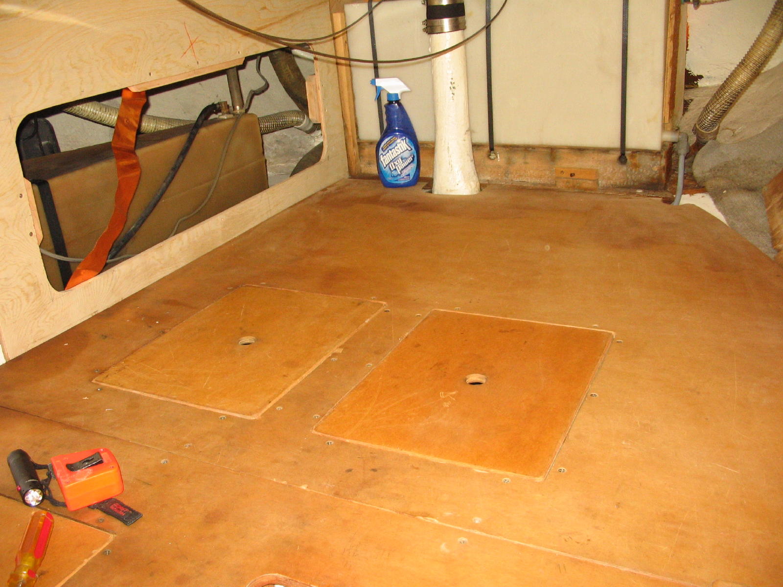

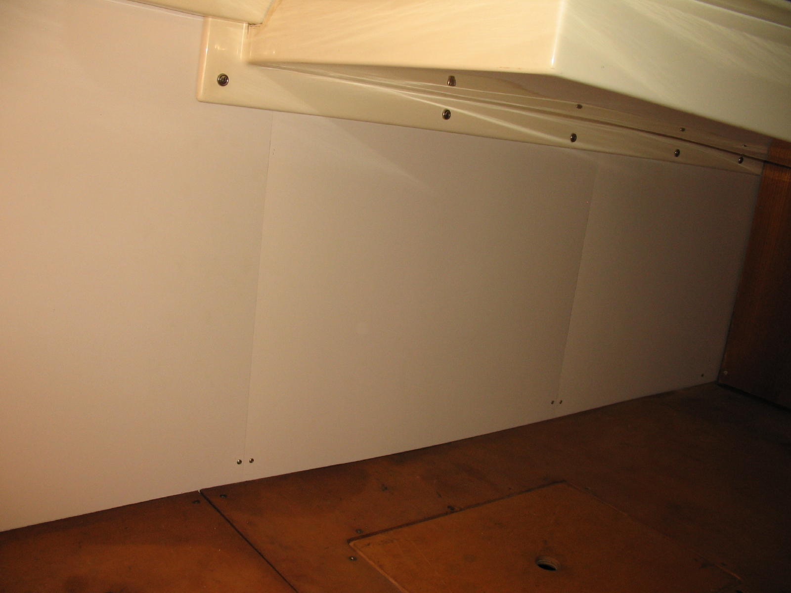

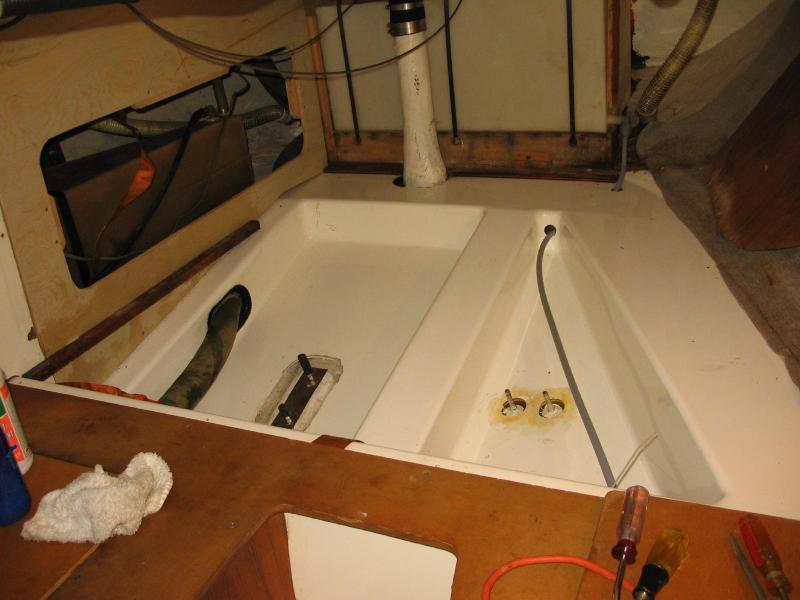

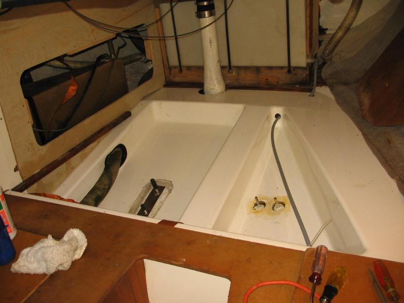

interesting. your aft cabin for the batteries and fuel storage is a little different to mine. I think I like the pictured set up better then what I have.. thanks for the picture and info.

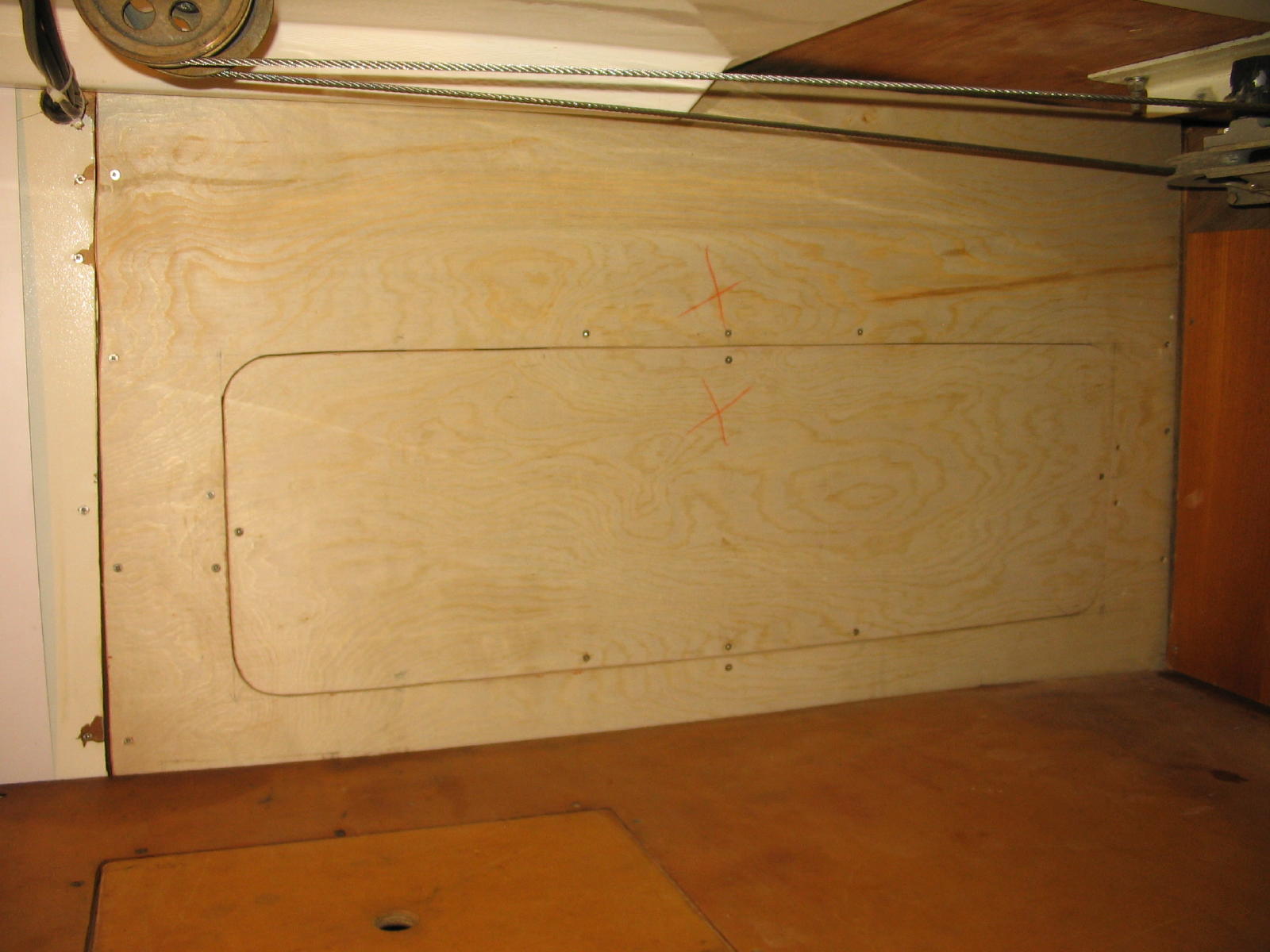

FYI, my 34 is also an 84. Unless PO has made mods, tank configuration must be same as yours. Picture was taken from the stern cabin. Batteries are on the starboard side in-between tank & hull so not visible from angle of the picture, ...and admittedly a little hard to reach through the opening, unless I crawl in. But tank fittings are easily reached and fridge compressor cn be serviced from there if need be. Attached pics will give you a better idea of that mod. You can siphon out the spilled fuel with a small hose inserted all the way to the bottom, near the inboard front corner of the tank. Points made in previous posts are all good. As for overfilling in the fall with the idea of avoiding condensation, we have all been there and done that. No condensation to speak of with our poly tanks ! It is the rise of temperature that causes the spill. Generally in the Spring, but the unusual temps we've had lately might have caused it. You may want to pump some fuel out with an oil extractor to avoid a greater spill with Spring temps. Good luck

FYI, my 34 is also an 84. Unless PO has made mods, tank configuration must be same as yours. Picture was taken from the stern cabin. Batteries are on the starboard side in-between tank & hull so not visible from angle of the picture, ...and admittedly a little hard to reach through the opening, unless I crawl in. But tank fittings are easily reached and fridge compressor cn be serviced from there if need be. Attached pics will give you a better idea of that mod. You can siphon out the spilled fuel with a small hose inserted all the way to the bottom, near the inboard front corner of the tank. Points made in previous posts are all good. As for overfilling in the fall with the idea of avoiding condensation, we have all been there and done that. No condensation to speak of with our poly tanks ! It is the rise of temperature that causes the spill. Generally in the Spring, but the unusual temps we've had lately might have caused it. You may want to pump some fuel out with an oil extractor to avoid agreater spill with Spring temps. Good luck
thanks for the pictures.. i like your access hatch and plan to do the same to mine starting this weekend..
