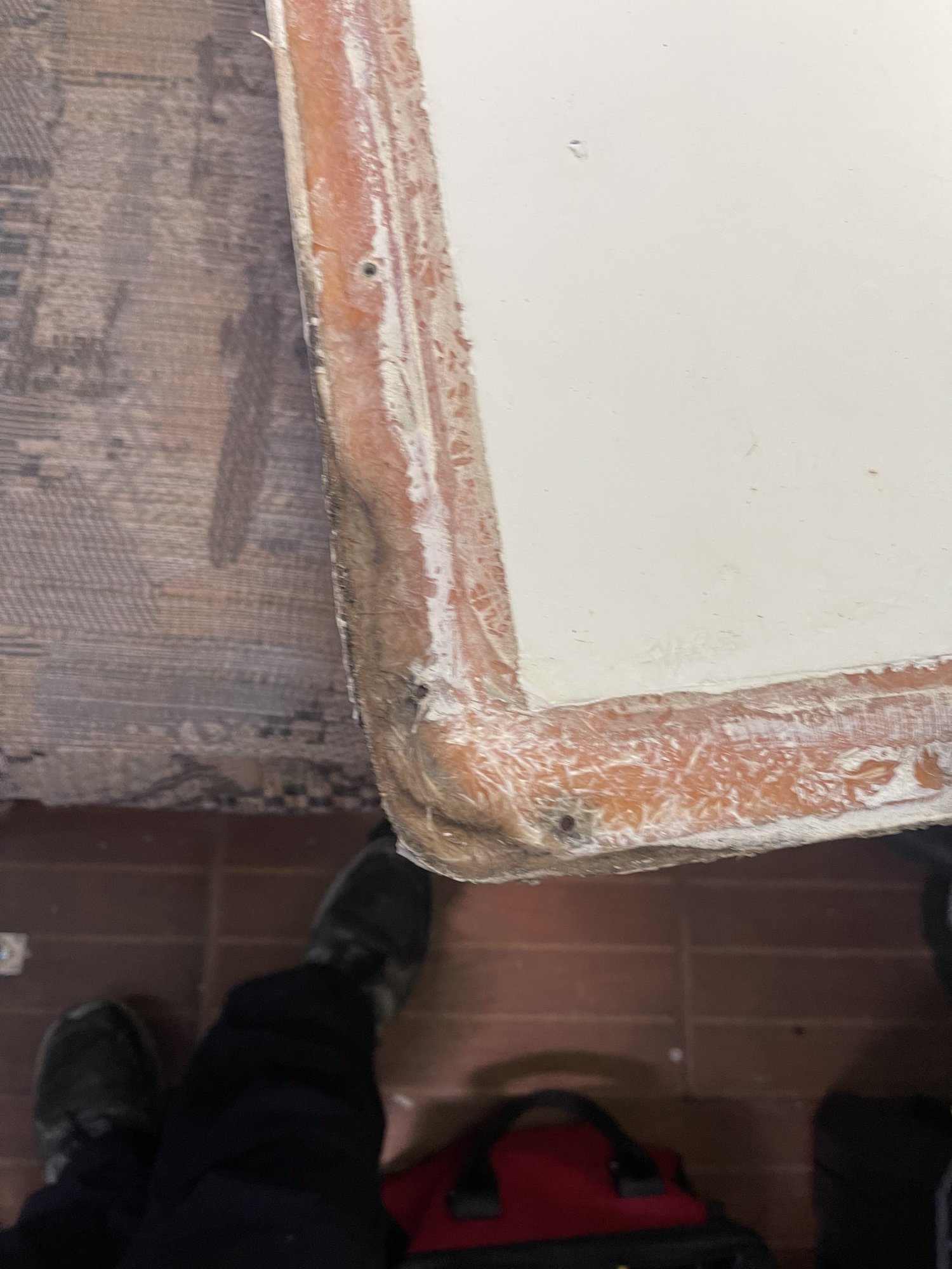

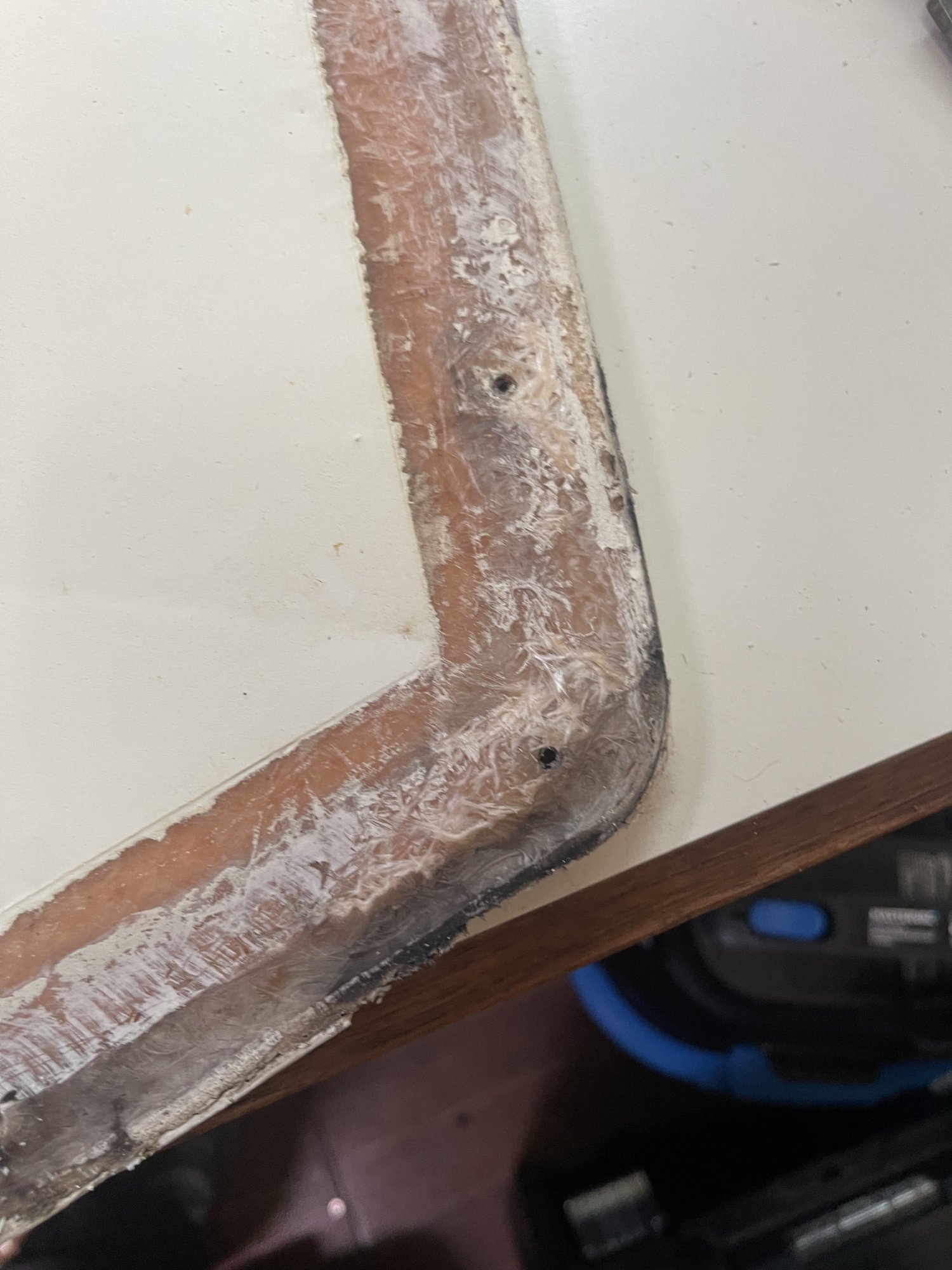

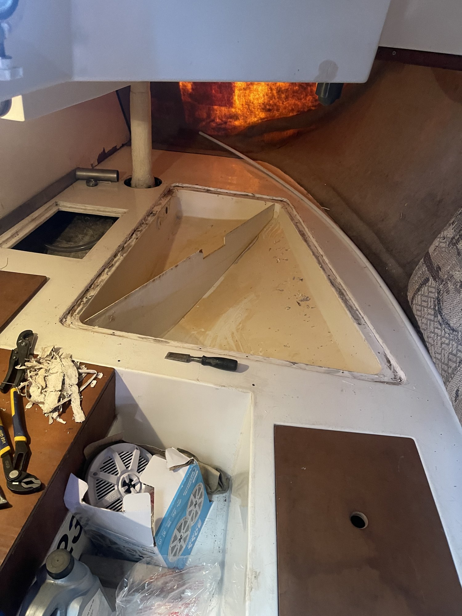

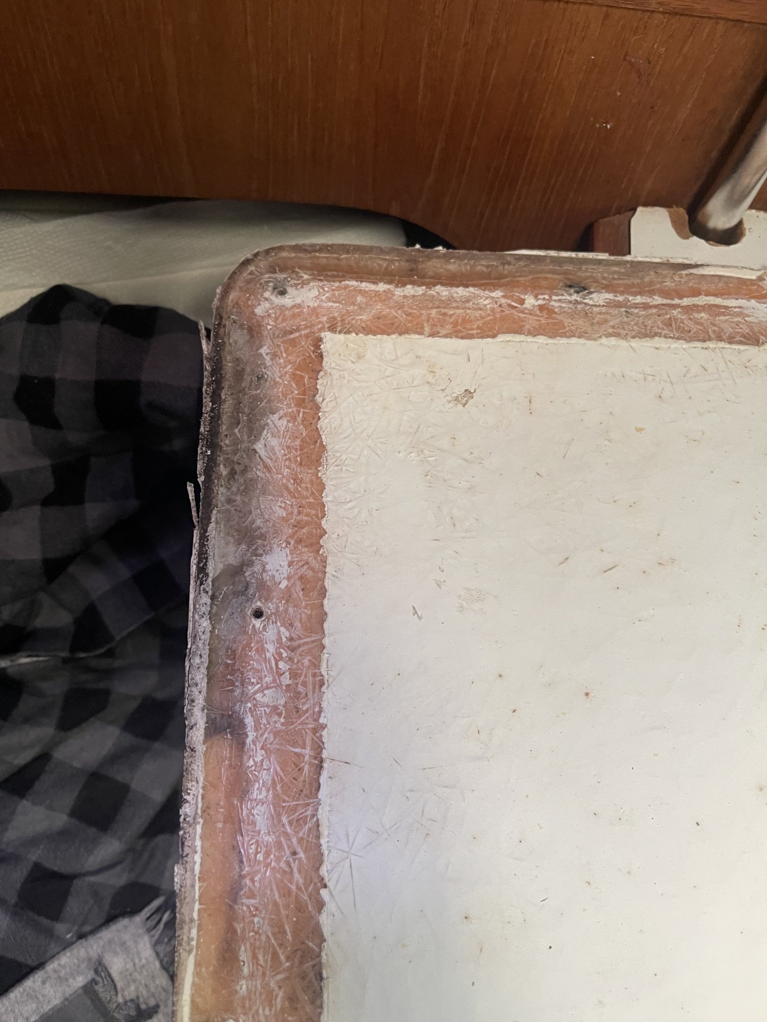

Today I removed the lid of the freshwater tank, I found multiple places where it was leaking. A previous owner had sealed the lid under the mattress so water found another route, sideways between the layers of Marine Plywood exiting at the wall on the bedside opposite the Fuel Tank. Sealant removed, Tank and Lid Bleached, and Reseal tomorrow.

It was no big deal. Pull all the hardware, and cut the sealant around the lid. Using a wide chisel (1") in the centre of the front edge, flat site towards the lid, pry up and brace with wedges/tools/etc. work your way around the lid. From start to finish the lid was off in 45 minutes.

Final Update: Tank cleaned, sterilized, and inspected. 2" wide Butyl Putty around the lid and reinstalled. I had to go up 1 size on 6 screws that wouldn't torque down. The tank was filled 2 hrs ago and no leaks.

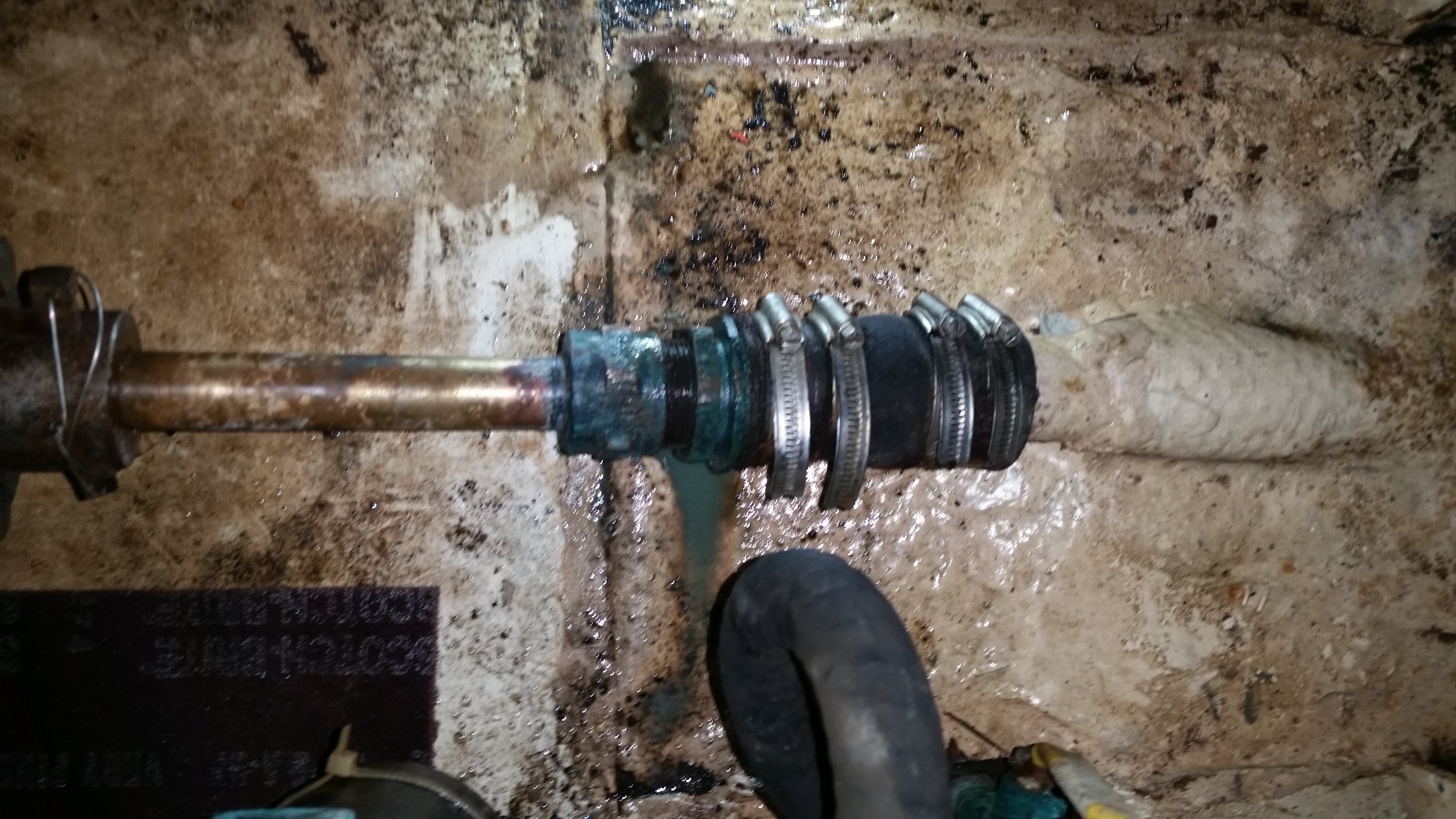

Hunter H31 Thames River Yacht Club

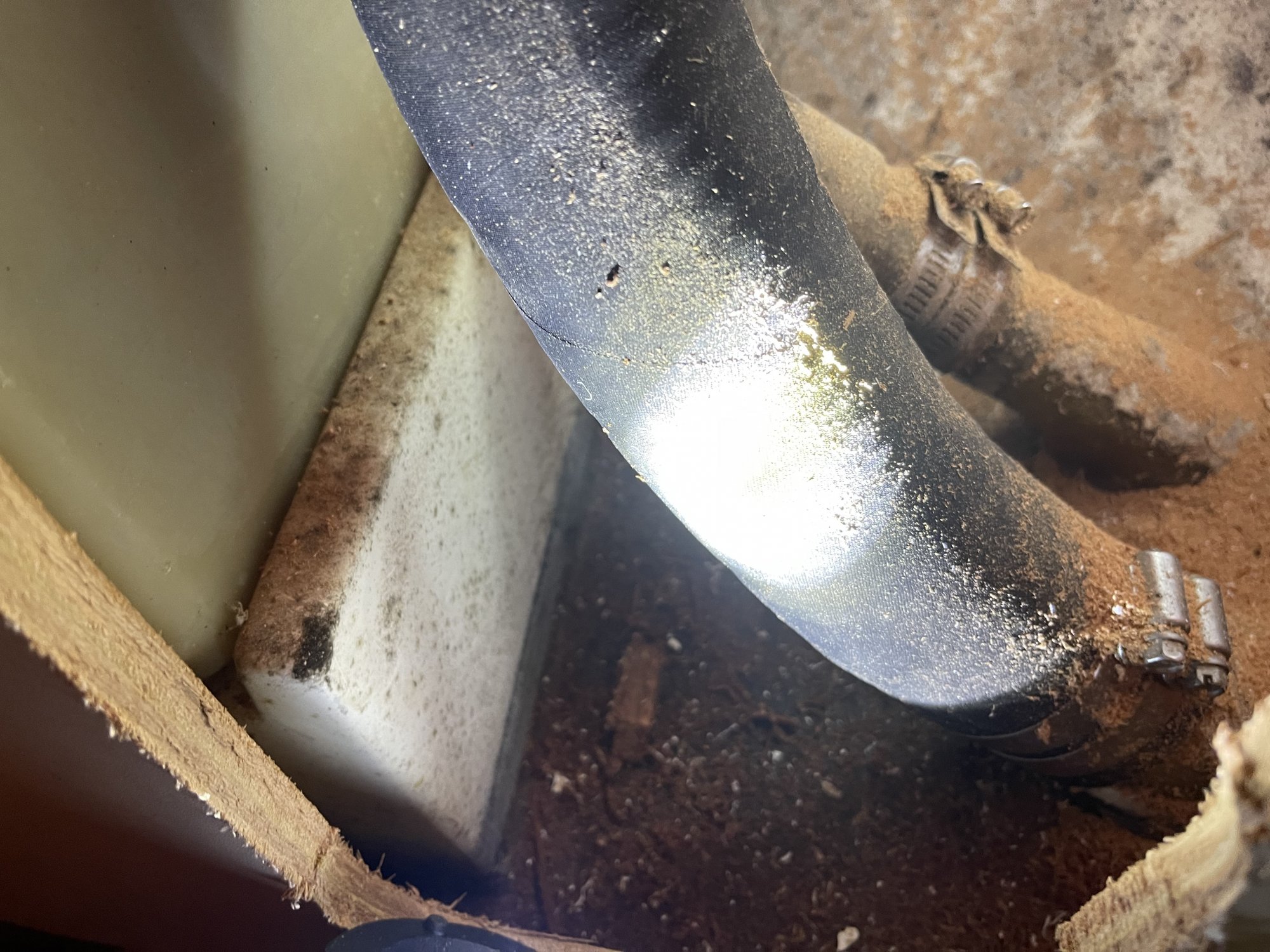

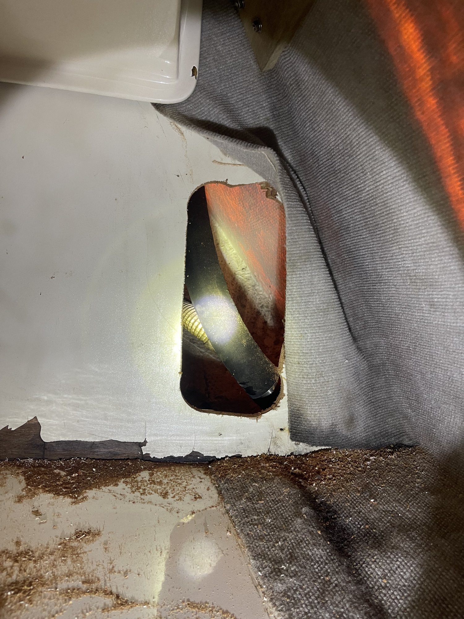

Update: Second leak... After fixing the Water Tank I noticed that the Bilge pump runs after every outing and I was still getting water in the back corner of the 3/4 Berth coming from the other side of the wall. After verifying that it was not the lid to the water tank I have now cut an access through the wall behind the Fuel tank. NOTE: If you choose to do the same measure carefully, The Fuel tank is .5" from the wall on the other side. There are two Through Hulls behind the Fuel Tank, Starboard Deck Scupper and Wet Exhaust. The Wet Exhaust hose has a split just above the Through Hull which not only leaks when the Diesel is running but also any time that Through Hull is under water.
