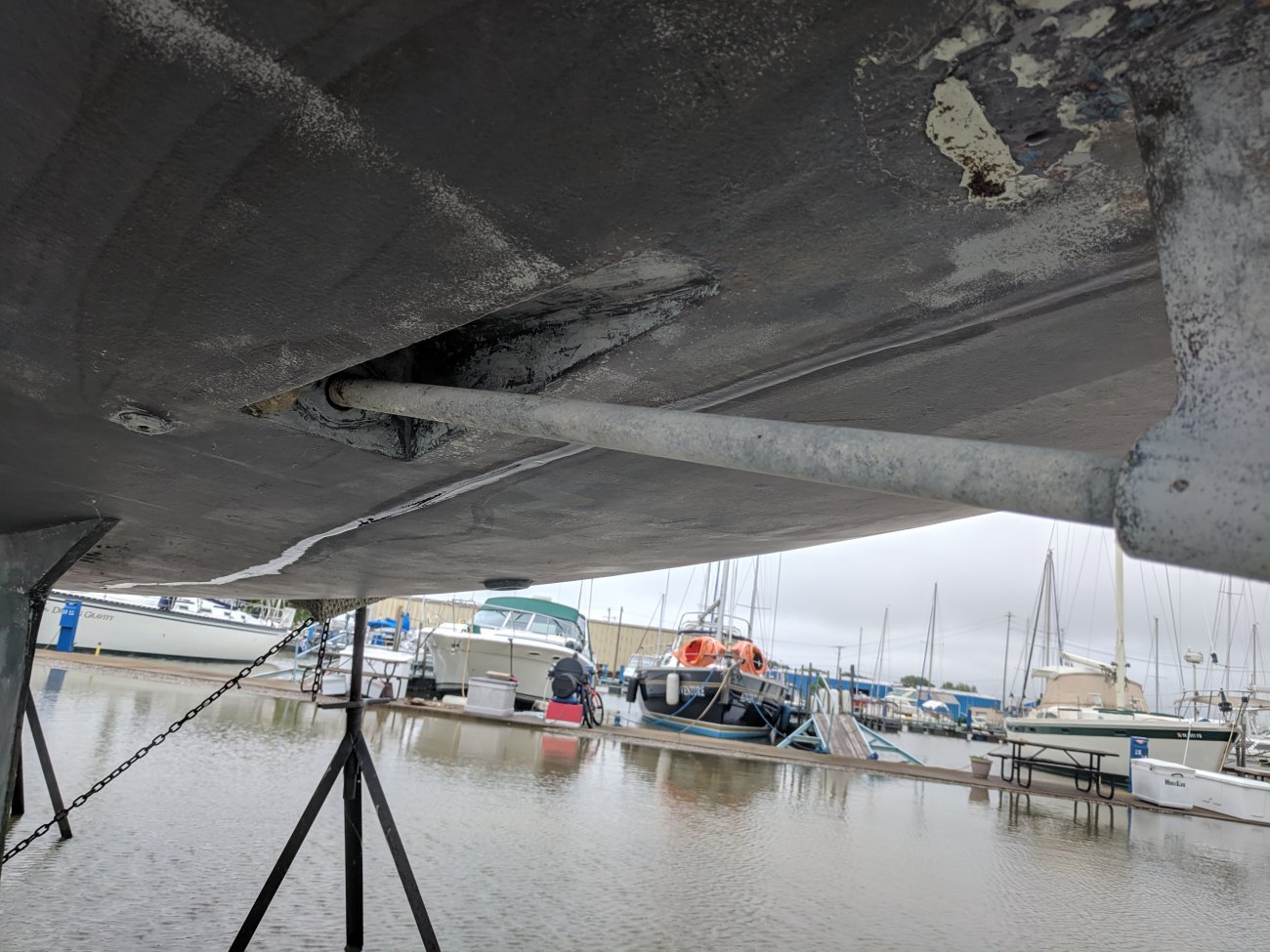

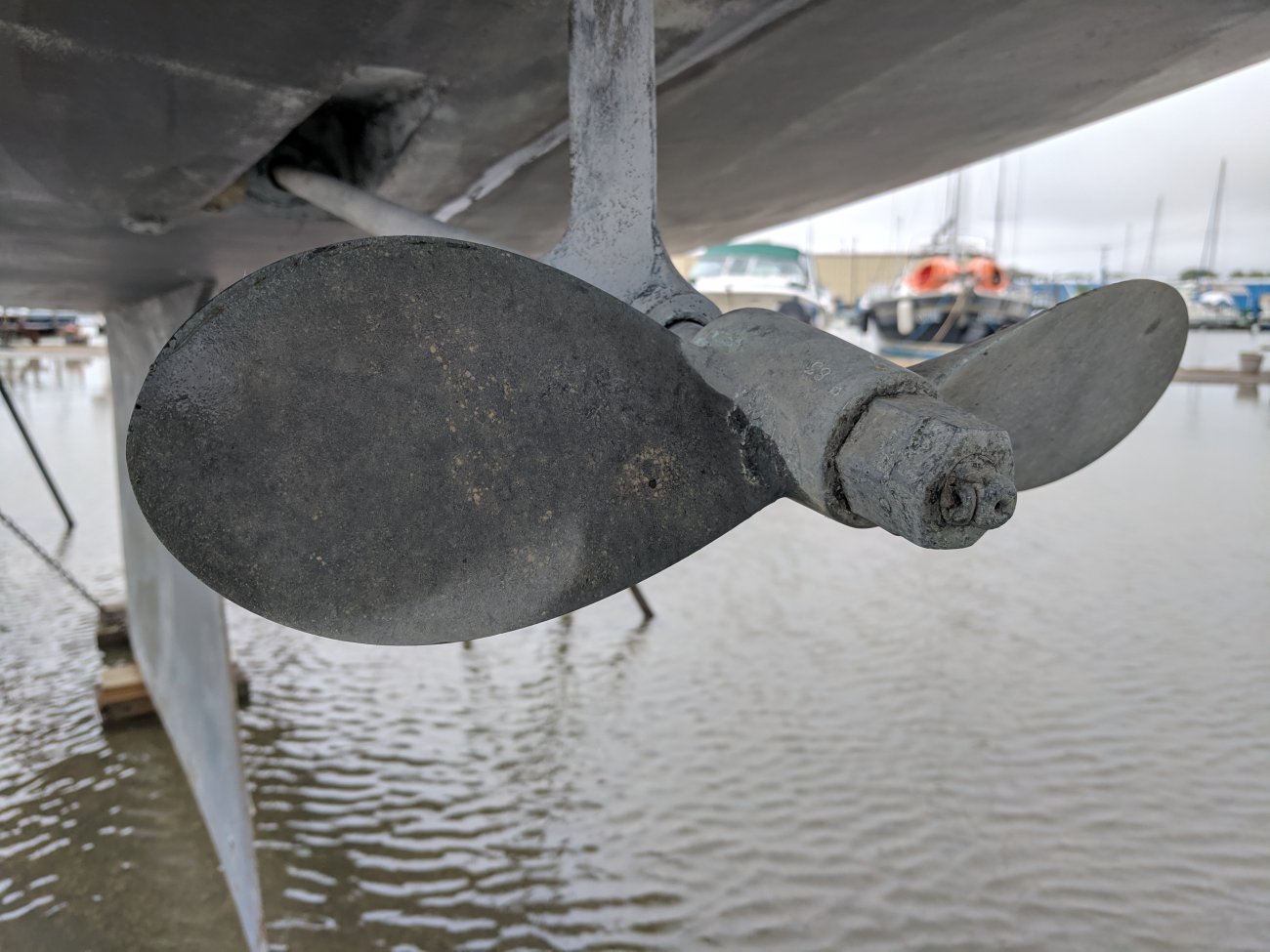

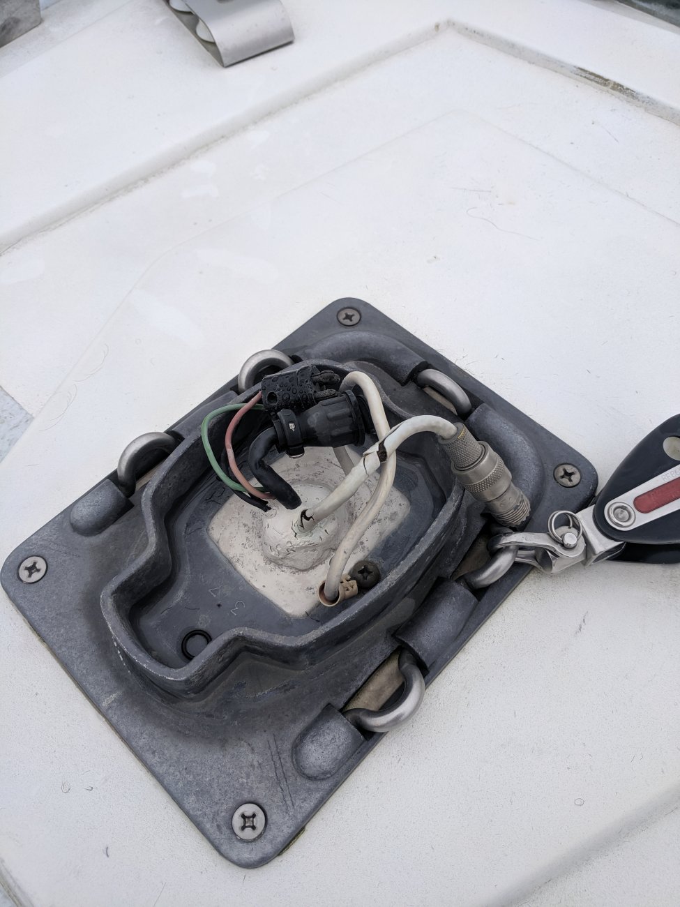

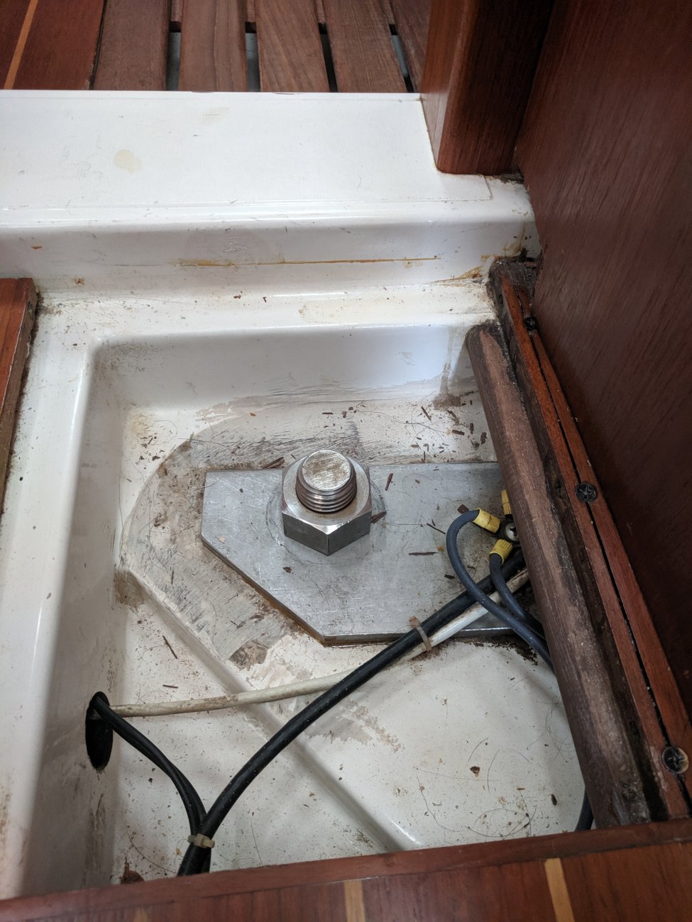

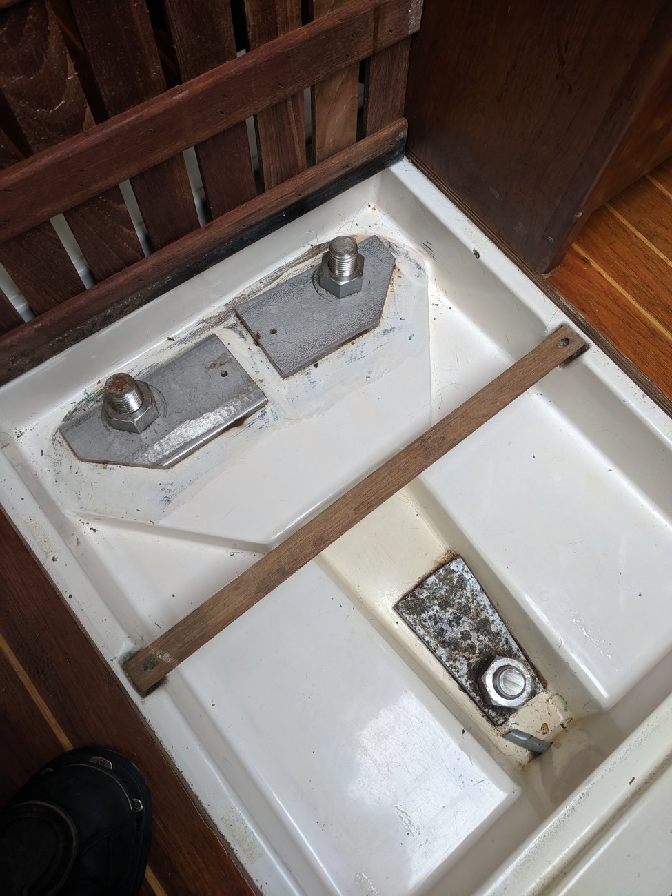

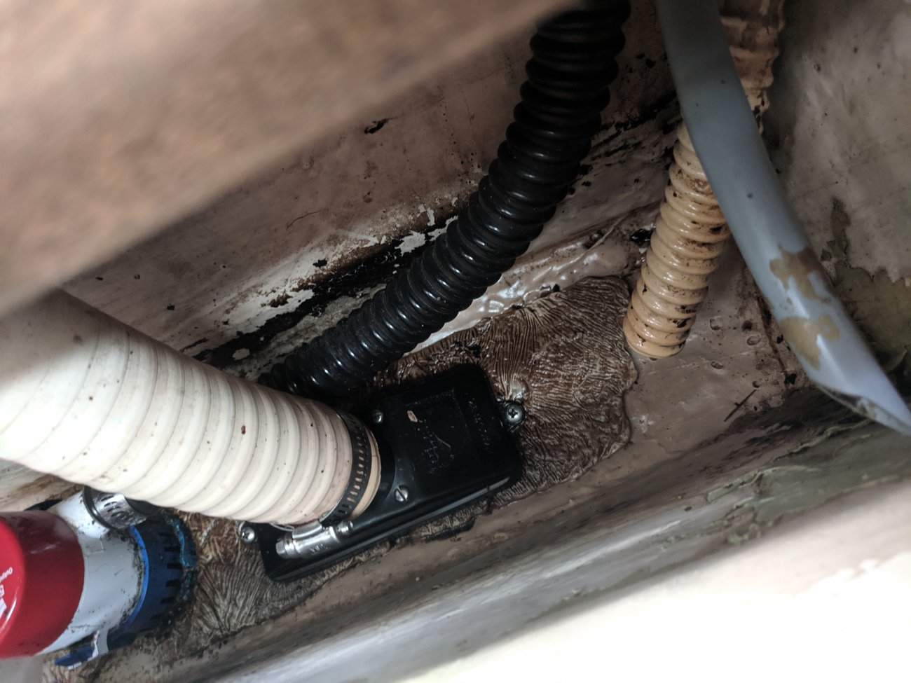

Video of the hull outside.
Here are some pictures from today.
1. Bilge - notice the shine. There's a diesel smell.
2. Mast step
3. Prop
4. Shaft
5. Foreward Keel Bolts
6. Aft Keel Bolts

I looked at those keel bolts and thought "they've been painted". Then I remembered that some boats sail in fresh water. Doh!

Looks pretty good .. Stove as you note is a problem.. The compression post beam is dented .. beginnings of failure.. looking at the mast step, it looks as if the tube that the wiring runs through is not sealed and may be too short, allowing any water pooled in the step to seep into the cross beam which decays the wood inside and leads to the beam crushing.. an extension on the wiring tube and fixing the wood inside the fiberglass cross beam are both going to have to be done.. The post itself looks OK (inside will be obvious when removed to access the beam) but the beam definitely is in early stages of being crushed. The repair is not too bad of a job, (not a trivial one either) especially with the mast down..

The actual compression post is inside the pretty wood post outside the head . The only way to see the actual compression post is to remove the linoleum covered bulkhead in the head. Or pop the post out as in this owner mod post https://hunter.sailboatowners.com/mods.php?task=article&mid=25&aid=7376&mn=31_83-87. I wouldn’t sweat that too much. BTW I didn’t see any zincs on then prop shaft. I carry two, there but I’ve not sailed on freshwater so I don’t know how important that is there.

Boat looks good. I’m still concerned on the movement of those anchor plates and would have a professional rigger inspect (the person/company that will install mast and standing rigging). Failures at this point are likely not covered by insurance (depending on exclusions in your policy). Also for the mast step/plate where mast head wiring is, there should be a stub up of pvc tubing. This needs to be sealed well to prevent damage to compression post as Kloudie stated while also allowing for drainage around limber holes.
