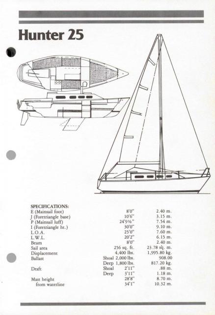

I was able to spend more time navigating the website and found the Specifications page for the H25 from a 1981 brochure and it has the mainsail specifications identified.

H25 sail dimensions (not rig dimensions), for the '25' not '25.5':
Main-- luff, 24.8; leech, 25.8; foot 8.0; weight 5 or 5.5 oz
110 jib -- luff, 27.16; leech, 24.58; foot 12.82; weight 5.5 oz.
I have those for storm and light-weather sails as well; or you can find this info available on the excellent Sail Warehouse web site-- just search for your boat.
