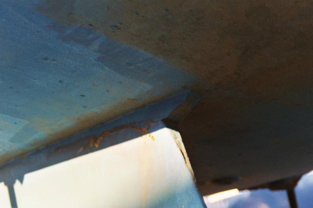

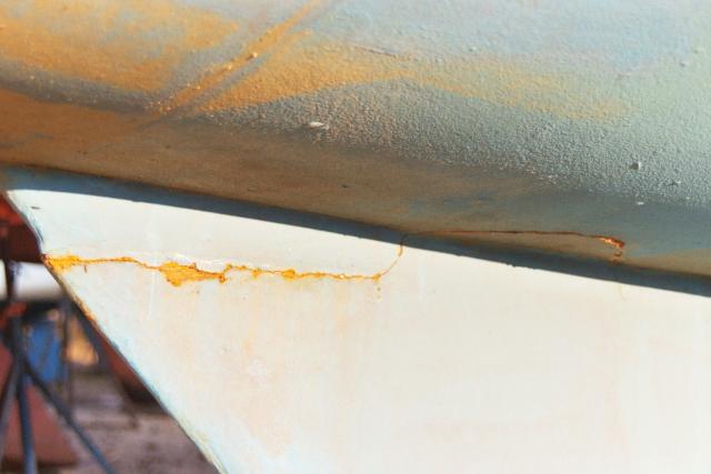

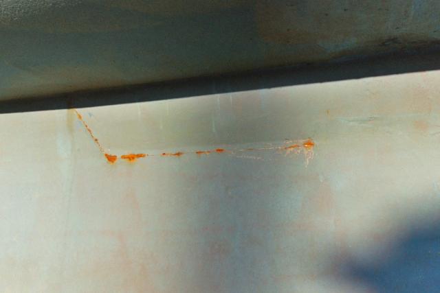

missed the hull/keel comment in your second post. The keel is notched out in the middle of it for the glasswork the constitutes the bilge area to fit. There are "massive" bolts and stainless plates at the forward and aft ends to hold it in place.
Attached are several pics of the hull/keel joint on my H34 when I bought it. A competent surveyor should be able to distinguishe what is good or bad about this area on the boat you are looking at.
