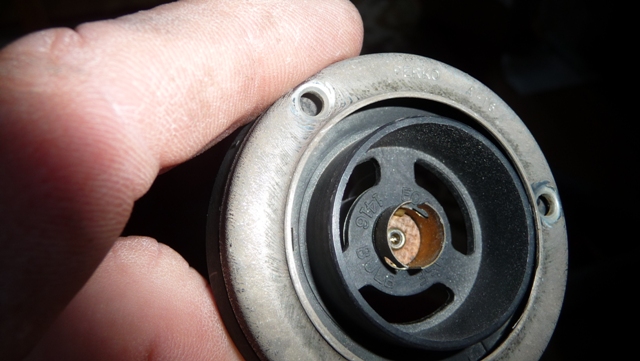

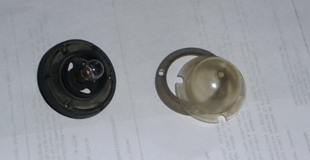

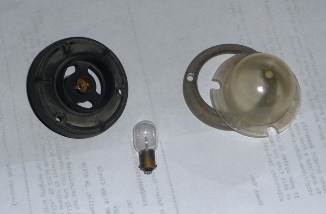

Several months ago I asked if anyone knew the size/model of the masthead light bulb for the h27. No one knew and someone suggested I report the size if/when I found. After a long summer with no anchor light, I finally paid a marina hand to climb the mast and replace. Originally I had planned to just replace the bulb with an LED, but since I could not determine what LED bulb to have on hand and since the existing fixture is like 27 years old, I decided to go with a new LED fixture (Seasense LED Mast Lite - 4 inch). The original fixture is a Perko and it rests on a 5 " stainless steel pedistal on top of the mast. The original bulb is a 1416 (see pic). The pedistal (pic 1) is round on top with 3 hole for nuts and bolts to hold the light. The base of the pedistal is oval that is attached to the top of the mast by 2 machine screws. The fixture is shown in Pics 2, 3, 4, 5. To attach the new fixture to the pecistal, it was necessary to drill one new hole, as original 3 holes did not match new fixture. As far as an LED replacement bulb, the nearest seems to be the Dr. LED GE90 Star, although I'm not sure there is enough room (height) for LED in the original fixture. Hope this helps some of you.

I think the lack of a response to your first query is due to very few H27 owners having replaced the bulb lately and the fact that older boats tend to wind up with lots of non-factory replacements, so may be different than yours. The light on my H27 had been replaced with a unit that took a BA15 socketed bulb (standard 12v 1156 automotive bulb). Yours was probably (maybe) original and has a BA9 socket (minature 12v auto bulb).. and now, if I'm reading your post right, now your H27 has a non-factory fixture and eventually an LED bulb as well :D Same type socket?
Sometimes you just gotta go and look at the darn thing to figure it out ;)
