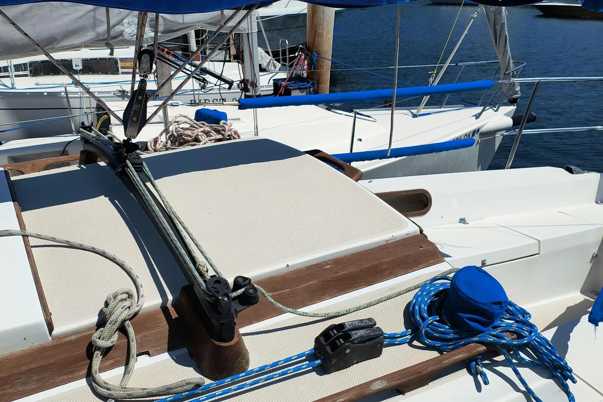

I noticed that there is some daylight between my curved main traveler bar and the wood riser that it sits on, on the port side. And some of the flat head screws do not tighten, indicating they are stripped. The system held together this weekend in white cap winds, tacking and gybing, which is when I noticed it.
I would like to replace the wood blocks but cannot find a source. Catalina Direct sells a $1300 main traveler upgrade, which might be nice, but I don't want to spend that much.
Does anyone know of replacement wood risers?
The picture (not my boat, but same year and similar layout) here shows the wood risers on the main traveler ends.

I am not familiar with that particular traveler but it probably is thru-bolted to the cabin top with the wood serving only as a spacer. If the screws are stripped and the traveler did not come off, that is probably the case. Look for a way to tighten the thru-bolts .. loosen the screws that are in the wood then tighten the load carrying thru-bolts then retighten the wood screws?

I would first look at the method of attachment of the traveler to the wood block before planing to replace the wood block. In the picture the detail is lost in a shadow.
