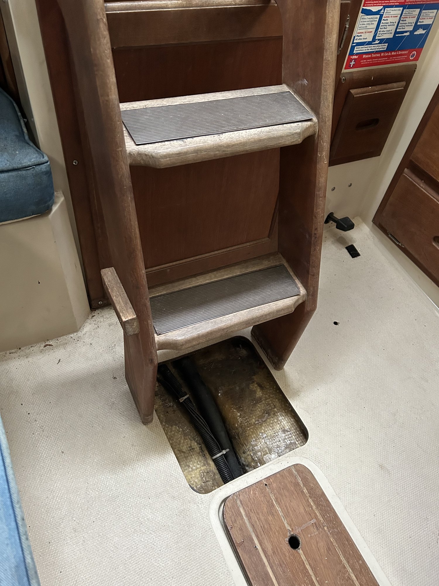

1984 Catalina 27 floor board under the stairs. Mine is missing. Ideas for replacement? Thanks.
Jan 7, 2011
5,677
Oday 322 East Chicago, IN
Temporarily, you could cut a piece of plywood or other material to fit the hole. It won’t match the others, but no one will twist an ankle coming down the steps.
You may be able to find a piece of teak and holly sole board at a nautical flea market and cut the replacement out of that so it matches.
Lastly, assuming there are only a few small floor boats like that, you could find some other wood you like, and just make new floor boards that match and just replace them all.
Whatever you do, you should varnish them on all sides to seal the wood.

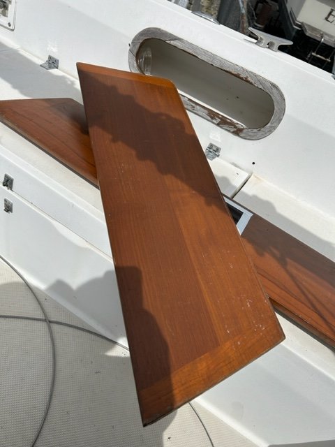

Thank you. Regarding the teak and holly sole board that is in the photo, (not the missing piece) is that likely marine plywood with a teak laminate?

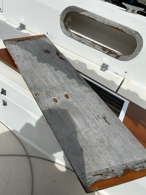

Also the floor board (I think sole is the same term as floor board?) in the photo which is about 5 feet long, is slightly warped so it never really sits flat. Is there a way to fix the warp?
Yes, I would think it laminate of some sort (pretty thin) over marine ply.
It's 3/8 " plywood with a thin teak and holly veneer, last 4X8 piece I bought was $300 about 10 years ago.
Pretty hard to straighten the board I think…that one in particular is pretty long and narrow. It may be possible to steam it, and clamp it between two thicker, straight boards and see it is holds flat. But my money is on it warping anyway. It should be sanded to remove whatever varnish is on it (particularly the bottom) so it takes the steam. But it seams like a lot effort (making a steamer, etc) for poor odds of it staying flat.
For those little bits of sole, I might be thinking about some sort of vinyl laminate over a piece of ply you could make yourself.

I'm a little confused by that void in the picture that doesn't show any support for a replacement panel. Was there a rim that has been removed (and you have it ready to insert)? Or will you need to build a recessed platform for the panel? Or does the fiberglass hull provide the support?
Good eye Scott. Also, not how that one doesn’t have a border of smooth glass around it….I wonder if someone cut that out for some reason.
