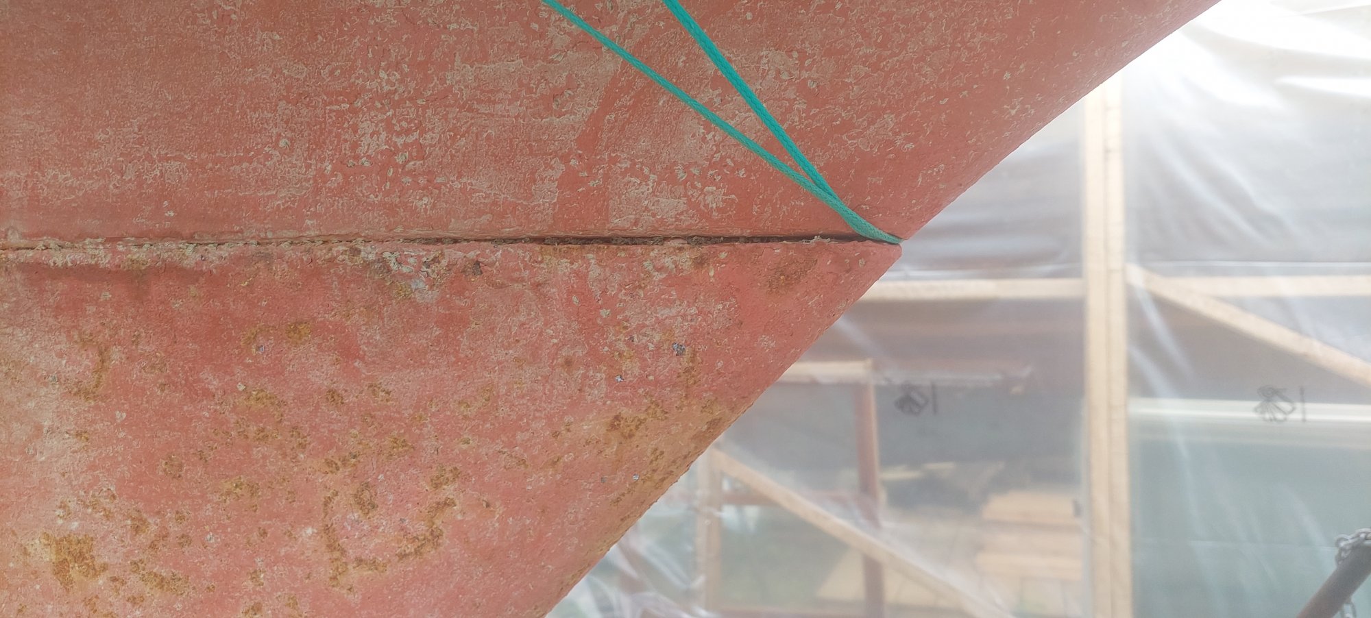

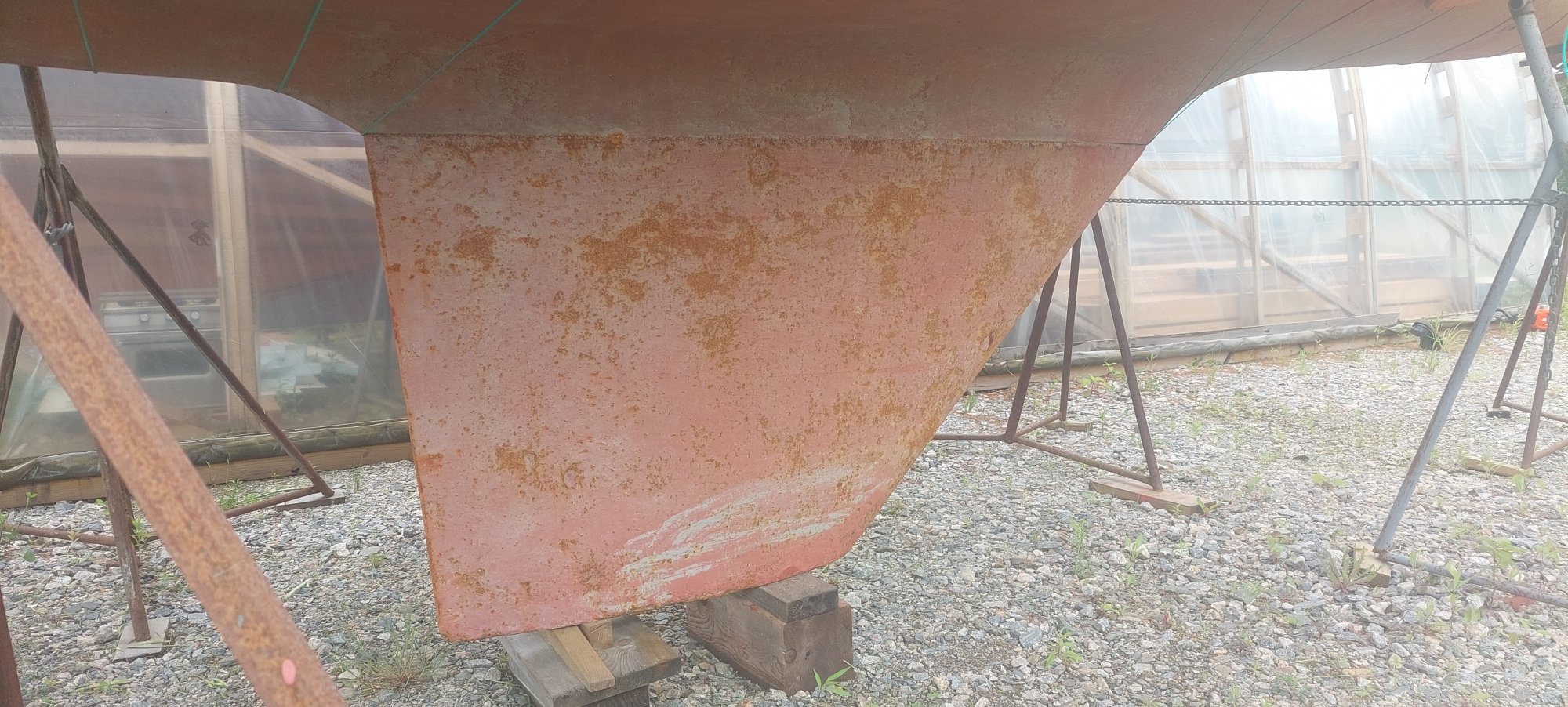

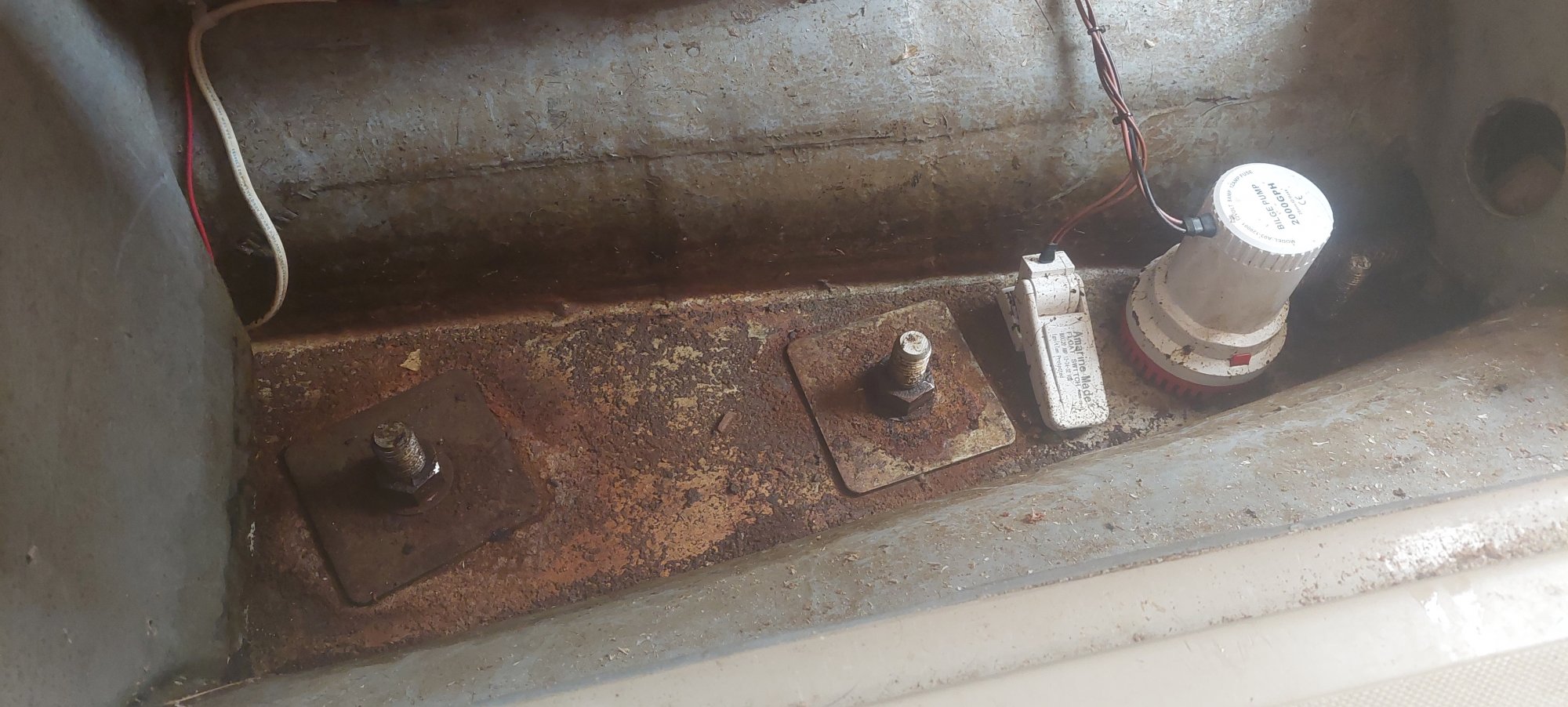

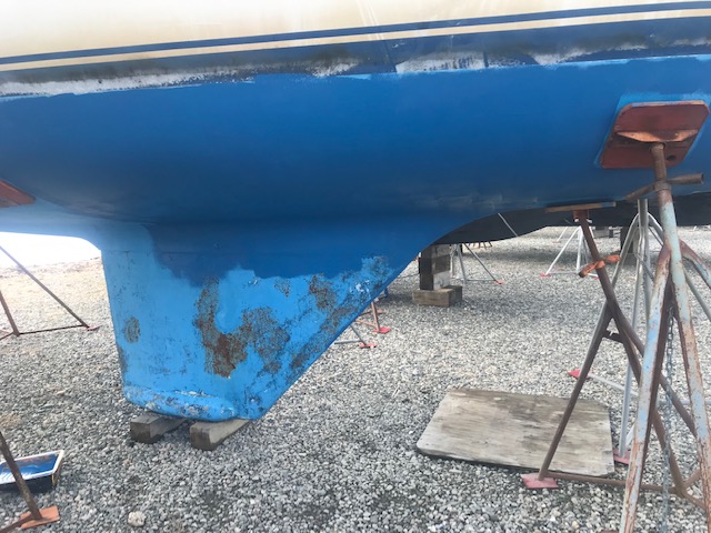

It's the 'deep' keel and there's a definitive seam showing the joint. The boat is on the hard and there's no streaking showing tho there is some generalized patchy rust showing thru the almost disintegrated bottom paint. The keel bolts look pretty good - a light patina of rust but not that crusty stuff of real corrosion; more discoloration. Current owner has never adjusted them and hauls it yearly for winterizing and reports no movement during that process. That said, as I was searching around here I found this post - Opinion on Keel Crack - and am wondering if I should prioritize dropping the keel to get a good look and smoosh in some fresh 5200. Ideas or recommendations?
