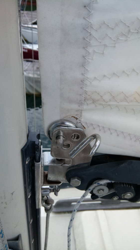

@Db421 when you take the pictures be sure to getimages of the boom at the mast, the top of the mast, the end of the boom as to the “drooping “ with the sail, and a shot of the whole rig with sail up. These images will help in diagnosis.

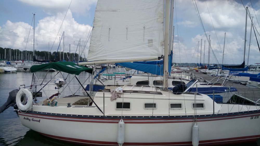

I am by no means an expert on sails, but looking at the rigging configuration my guess, and only a guess, is that the sail has been stretched. Due to the traveler being in the cockpit and pulling straight down near the very end of the boom I would guess that it would be very easy to over tension a system such as this. It is hard to tell by the pictures, but the angle of the boom compared to the mast looks to be more than 90 degrees. If that is the case then I’m fairly sure that the sail is indeed stretched or it is cut wrong. I would tend to go with stretched, as I doubt that a sail maker would cut a sail wrong.

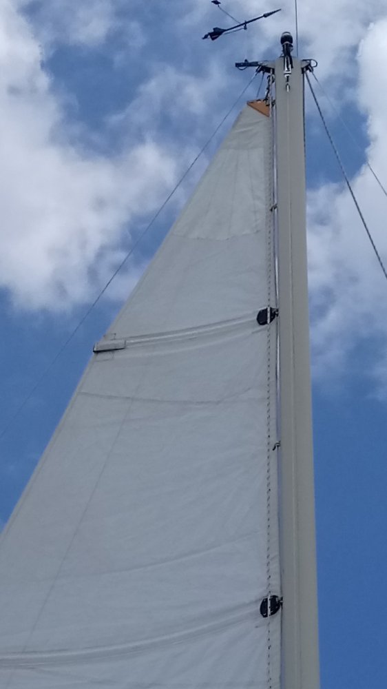

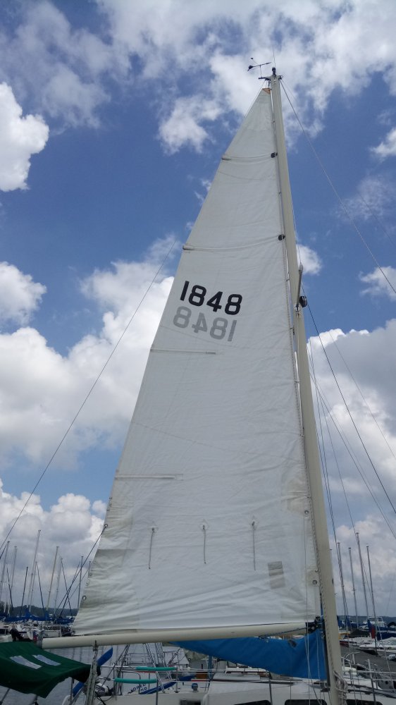

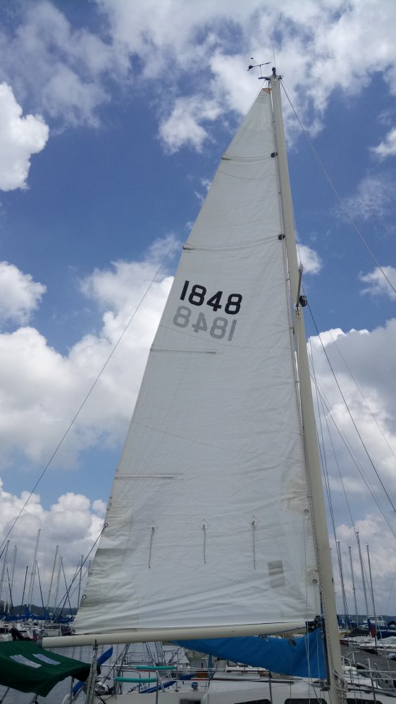

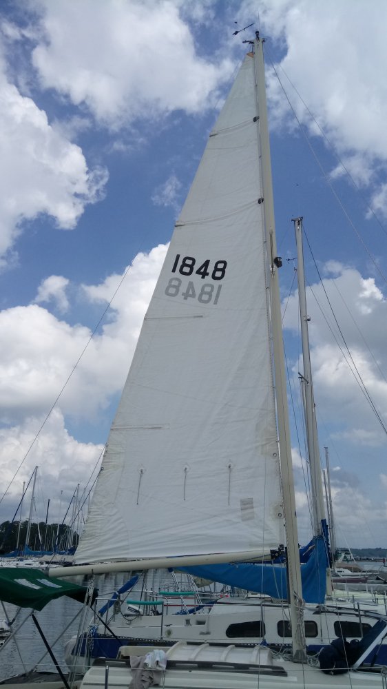

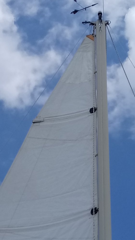

I had a main sail with an exaggerated version of your concern. In my case the bolt rope had shrunk. I sent the sale to a loft (Island nautical) they simply removed the threads/stitches that held the bottom of the bolt rope in place, then pulled the sail to a nice shape and re stitched the bolt rope in that position ( it mover almost 8 inches up) . I would try two things before I had a loft look at it. #1 loosen your out haul, you have horizontal wrinkles just above the boom, you don't want those (also looks like your using a reefing line to keep the upper leach tight. the top 1/3 of the sail looks great...so did mine. Then I would tighten down the tack/goose neck very hard. this will bring the front of the boom down and get you better sail shape. its OK to use a 2 or 3 to one purchase to tighten the bolt rope/tack/goose neck. its very difficult to hurt the sail by tightening the bolt rope.
8,150

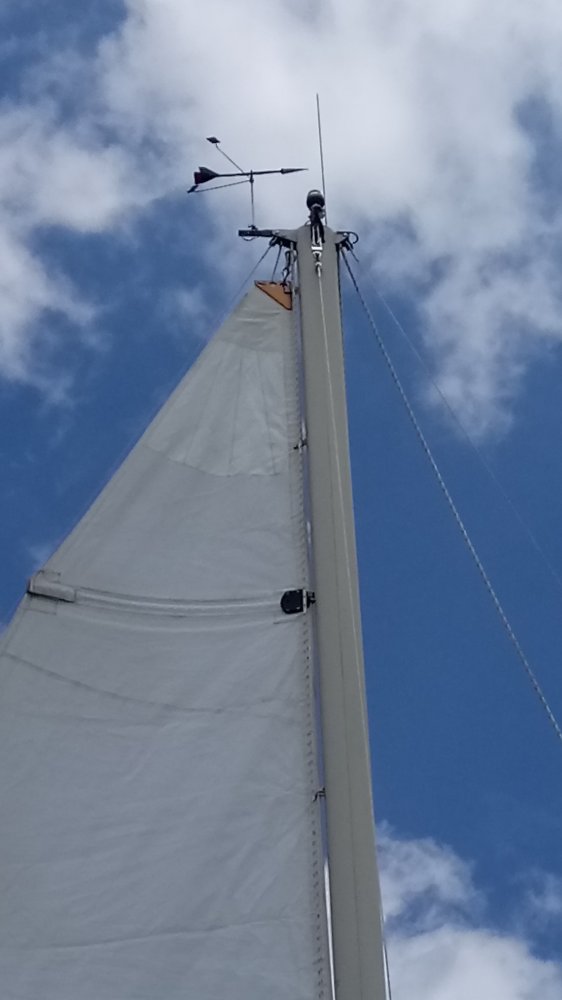

The sail luff curve doesn't match that of the mast. The mast curve may be inverted or it just looks that way in the photos. The boom can and should be lowered on the mast. I think for your boat that is the equivalent of a cunningham. But what stands out is the second reef line which is way too tight. That is where things seem to go wrong. And it seems like the luff isn't tight. Some wrinkles along the luff in light air are considered fast. There is almost no wind in the pic and they are present. What happens in more wind? In part this is because of the boom position (Which you've said doesn't change anything) and put on more halyard tension. It seems like in the pictures that the halyard can't go up any further. If the boom were set lower I think you could put more tension on. How stretchy is that halyard? It should be ultra low stretch.
But the luff curve. Before considering easing the bolt rope you need to see if there is any extra bolt rope built in. I don't see any. Maybe you could try easing the lower aft shrouds and tightening the forward lowers. Maybe put a little more backstay on. This would add some pre- bend to the mast which should match the way the sail was built. What concerns me is that the middle of the sail has the largest gap between the sail and mast and the top and bottom the least. Pre bend might exaggerate this but you can't go the other way (Invert the mast bend) so it's worth a try. You do small adjustments and see if you like the sail shape better. BTW having the boom angle down is not in of itself a problem unless your pals are making Viagra jokes.
