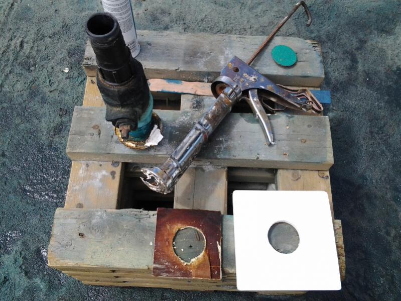

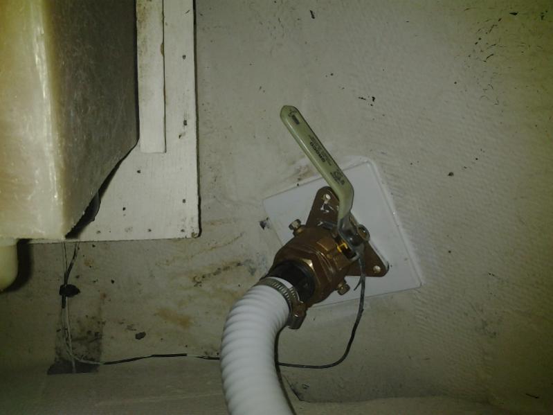

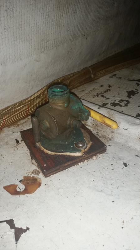

Same issue with my 83 model, noticed a leak and traced it down to the fwd seacock which base was rotted and wet, short hauled the boat the next weekend and replaced as shown, pretty bad of me to have let it get that bad

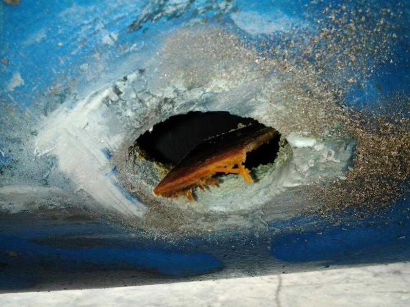

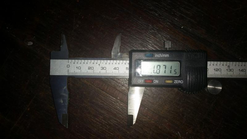

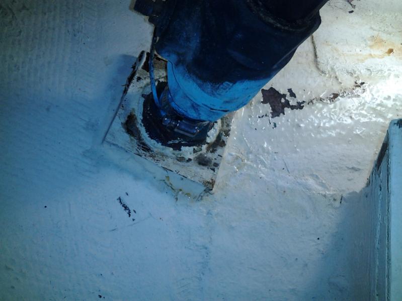

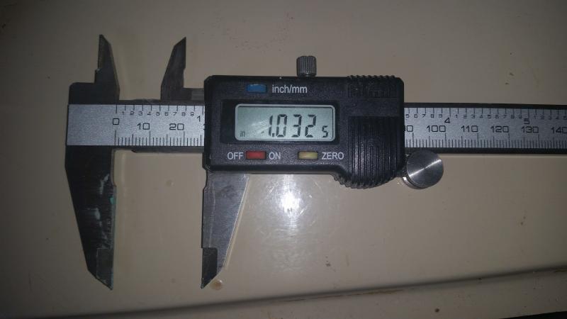

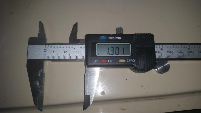

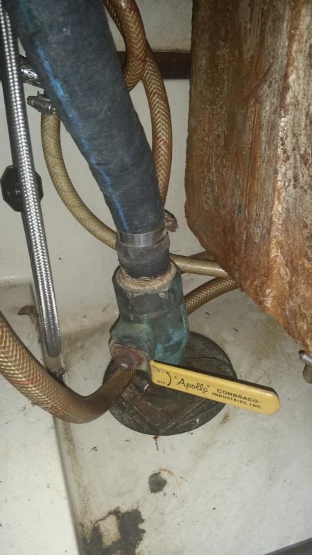

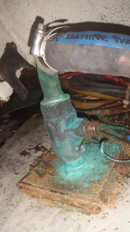

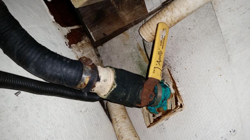

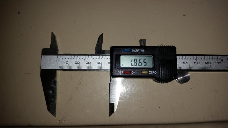

Photos attached - WARNING These images may disturb some viewers...
  • Head Intake - Measured 1.03" - 3/4" NPT
  • Spare - Groco SV1000 Measured 1.3" - 1" NPT
  • Galley Discharge - Measured 1.87" - 1-1/2" NPT
  • Waste Discharge - Measured 1.86" - 1-1/2" NPT

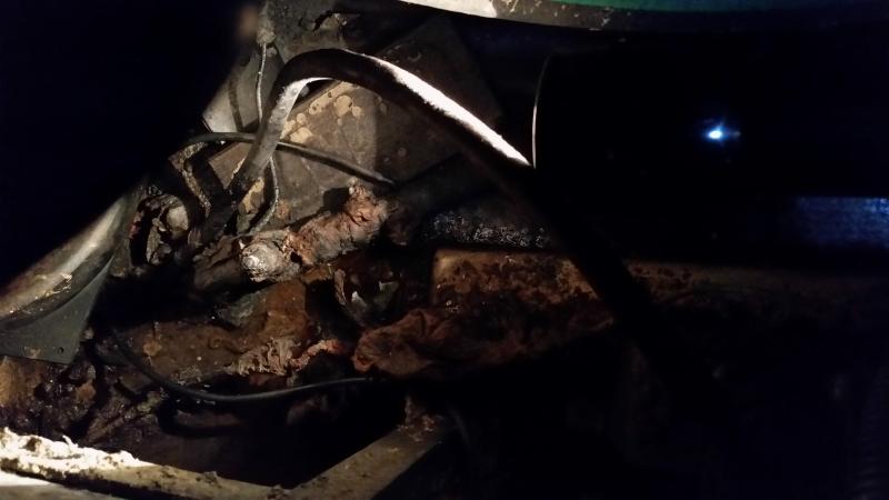

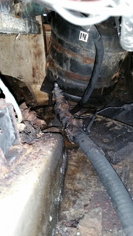

  • Engine Intake....:eek:
Even if I could get back to the engine intake without disassembling the exhaust system - I'm not sure there's anything left to measure... My plan is to install a new thru hull/seacock in the forward/starboard section of the engine compartment. Right next to the impeller on the Yanmar 2YM15. Then pull and seal the old one. Seems reasonable right?
Any additional comments, thoughts, words of encouragement....?
