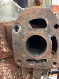

Jul 20, 2020
54
Hunter 30 1001 Nyack NY Hudson River
I replaced the exhaust elbow last spring, and turned a relatively easy project into a debacle. I learned that I should have removed the exhaust manifold with elbow attached and then proceed to attempt removing bolts, rather than squeezing into small engine compartment draped over engine and trying to loosen cooked in bolt. One bolt broke off and I tried to drill out broken bolt with extractor kit. That became a disaster and I stopped my attempts after almost destroying manifold. I searched high and low for a replacement manifold for the 2qm15 and found one in France for $350 plus shipping (heavy), but decided to try my luck with a fabricator down the street. Fabricator worked his magic (cast iron not easy) and done in a week. Replaced exhaust hosing also.

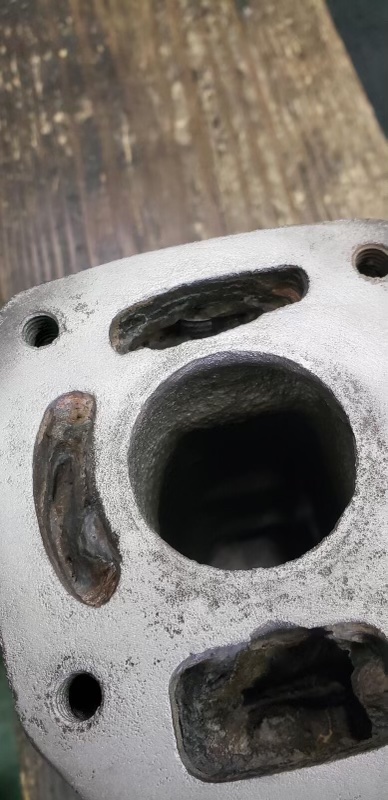

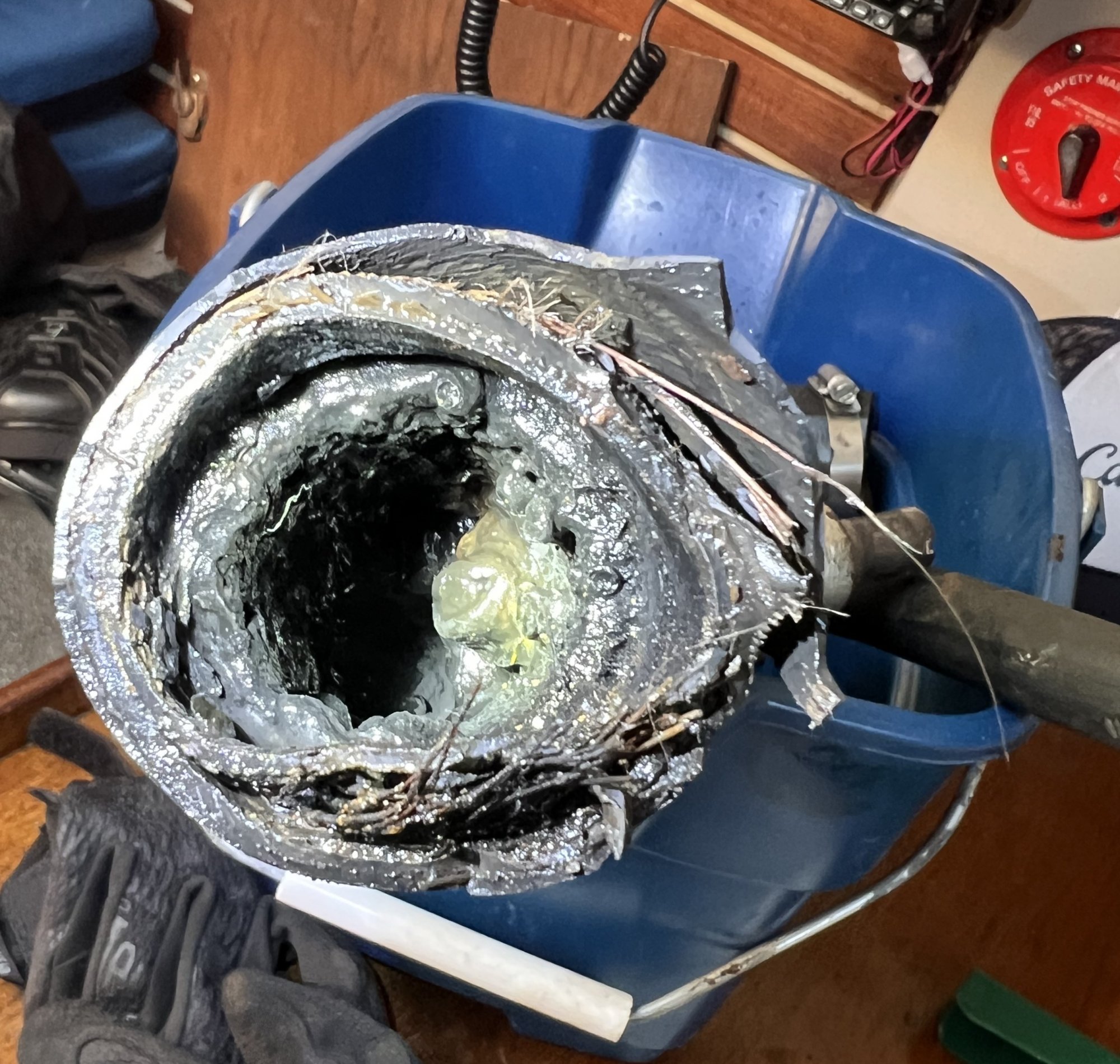

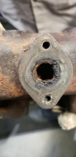

Feb 14, 2024
4
Lancer 30-5 Marina del Rey
Thanks all! It ended up being both the manifold and mixing elbow that had failed. The diesel shop found extreme corrosion and clogged water jackets while attempting to separate, clean and save the parts. Thankfully a friend had a low hour 2qm15 on a dolly in his garage so we were able to locate the replacements, clean them up and install in a couple days. Aside from having to slide the engine over a bit on the mounts to remove the manifold it was all pretty straightforward. It fired right up after install with full power band, no smoke, more water and a now louder, unobstructed exhaust sound that will definitely take a little bit of getting used to.
Photos of the clogged parts below:
