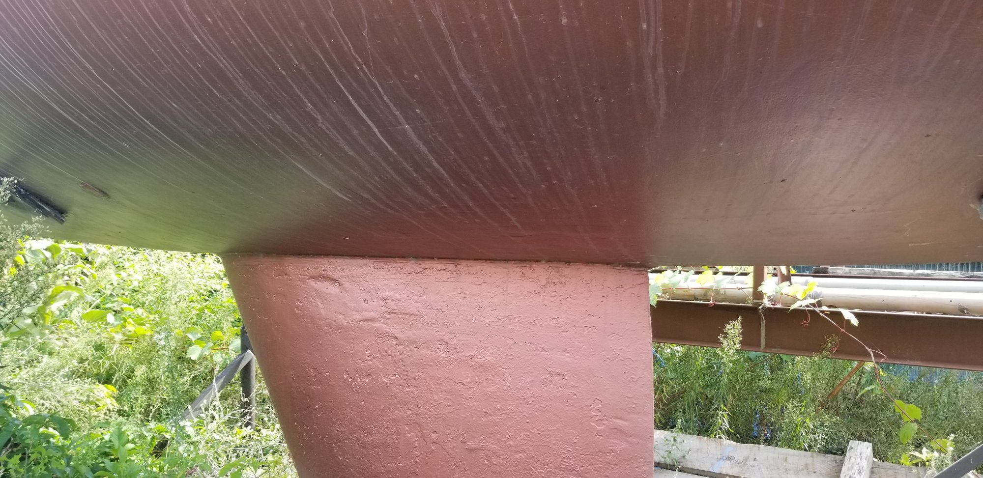

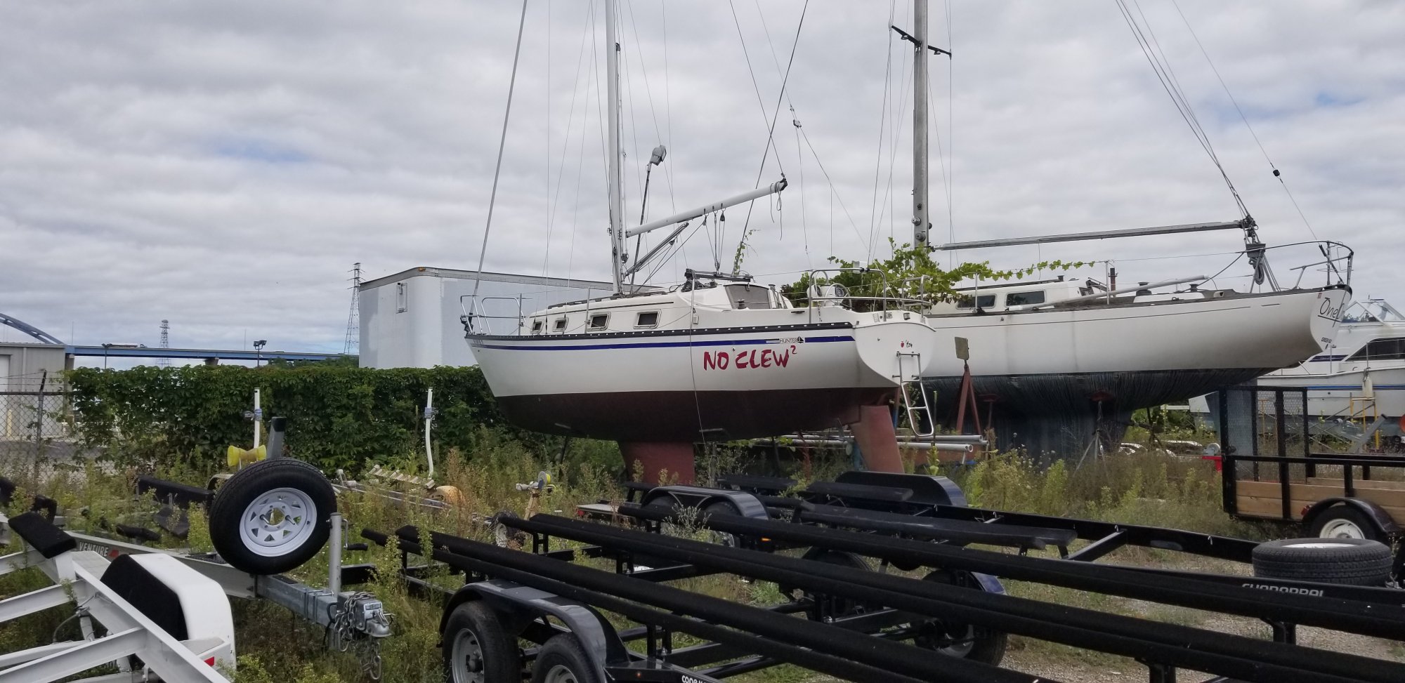

I am looking at buying a 1981 Hunter 27. There is alot of neglect as it has sat on dry dock for 2 years. It appears the bilge keel area may have been reworked. Is it worth getting a survey? It seems that it is sold as is without being in the water or engine running. Bad idea? They are asking $1500.

I like these types of projects. I have been considering the options. The biggest concern is the logistics of getting the boat to where I can work on it. Which this would be easiest to put it in where it is at and motor/sail it to my club 10 miles away. That would require draining the tank and refilling and conditioning the fuel system, getting the engine running. Getting it in the water and hoping it doesn't have any leaking issues.
The other concern is how much deterioration there may be in the keel area. My tapping skills indicate it does not seem too bad. Walking on the deck didn't not present any soft spots. But what do I know.
I would need to get a yard trailer to put the cradle on at my club for end of season.

I'm not seeing/understanding your concern with the keel. If this boat has keel problems I wouldn't buy it. What engine does it have in it? Should be a yanmar, that's what originally came in them. But I think in 81 they were putting in the GM series, not the YS series. Both are pretty simple diesels. I'd want to know if it runs. Without a running engine, or one that could be made to run easily, I wouldn't buy it. Did you try to turn the motor over to be sure it isn't seized? Still got the original aluminum fuel tank? Those only last so long, I'd be wary if still the original tank.
Your financial advisor is right. This boat will cost a lot more than $1500 to get sailing - just in parts...

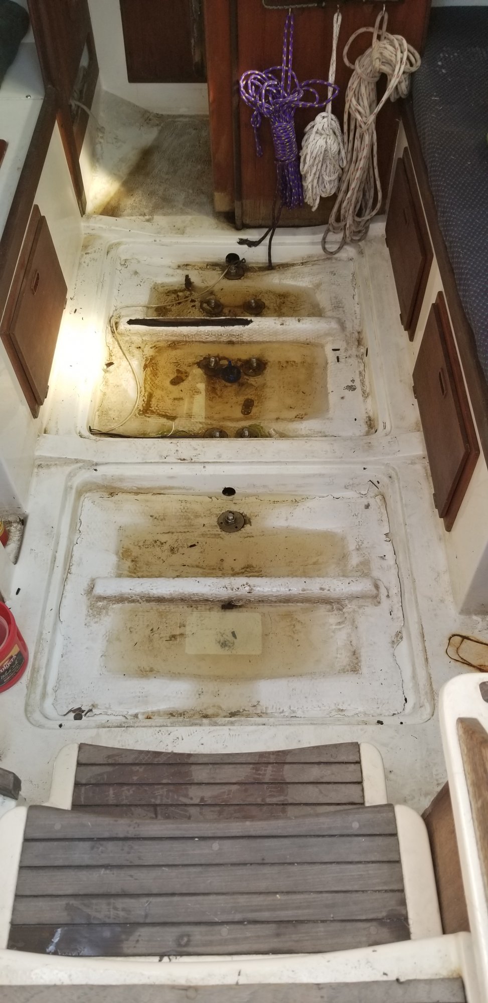

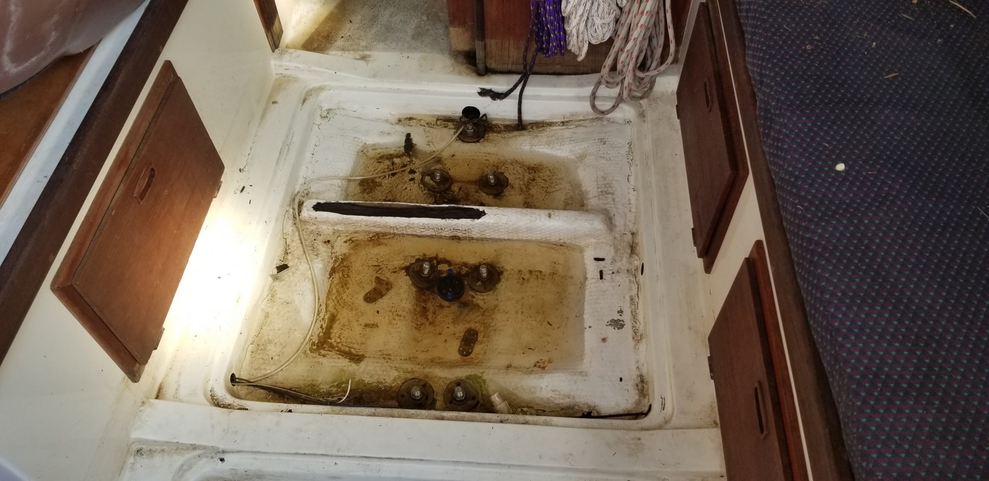

The water in the bilge didnt come through the hull. It came through the deck and at lesst two years of doing so. Unless it is obvious were it came through, I'd assume that it worked its way through the core.

The water in the bilge is obviously rain water. My 84 H27 had some leaks around the port lights and the hull to deck seam. I tightened all of the deck seam nuts and changed the port light seals and that problem was solved. I would have someone look at the engine as that would be a deal breaking expense. If it has the original sails, you will be looking at about $2000 for new ones. Look closely at the two overhead hatches, because the plastic supports and dogs are prone to breaking. I replaced both of mine with good quality used hatches. Personally, I would never buy anything but liability insurance for this boat. Liability insurance is all that a marina requires. Overall, I think that the H27 has good bones and is worth saving.
Yes, that's what I think also, possibly the hatches get left open. Certainly check all the through hulls and replace gate valves & re-bed as needed. I have also re-tighten all my hull to deck joint bolts and tightened & re-bedded stanchions, I have one more leak to figure out and she'll be dry.
