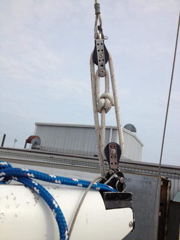

My '82 H27 has a reef line on one internal side cleats and the outhaul in the center that terminates in the cable as you said. It has a mechanical purchase system internally to help with the load. On the other internal side cleat is my adjustable topping lift. I should be at the boat later in the week. I will try and snap a picture or two for you.

I took a pic of how mine is set up. The blue line is tied around boom for storage, it is the reef line. The cable hanging is the outhaul, and the White line as you can see is the topping lift. Hope this helps.
