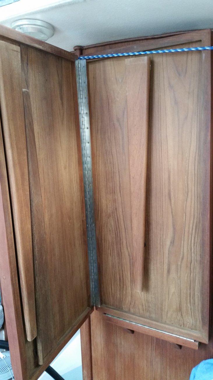

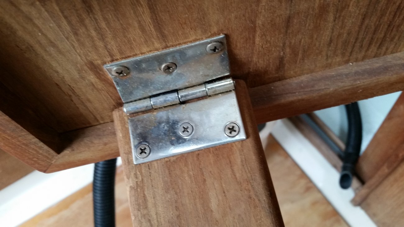

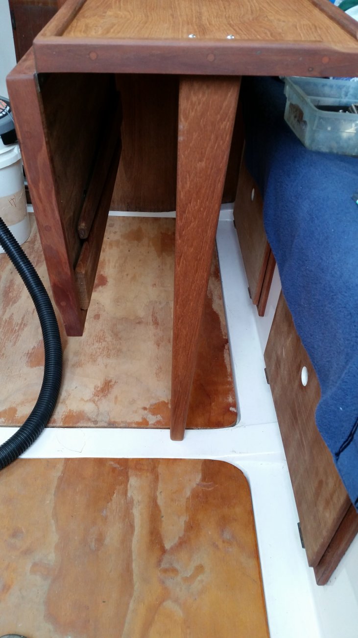

20160108_135051.jpg 20160108_135118.jpg Here are a few photos of our table: The first one shows the table on the wall with the leaf swung open. I have since added a latch on the bulkhead to hold the table instead of the bungee cord. The second pic shows how each of the three legs are attached. The last one shows the leaf hanging to allow easy passage to head and v-berth. With leaf up, it is comfortable for 2-4 people to dine or play cards. A very well designed saloon table for a smallish boat.

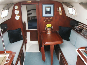

Funny how for all the photos I do have of my boat, that's not one of them. I single-hand and eat at the nav table or in the cockpit.
Here is one from someone else's.

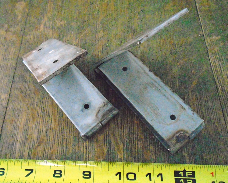

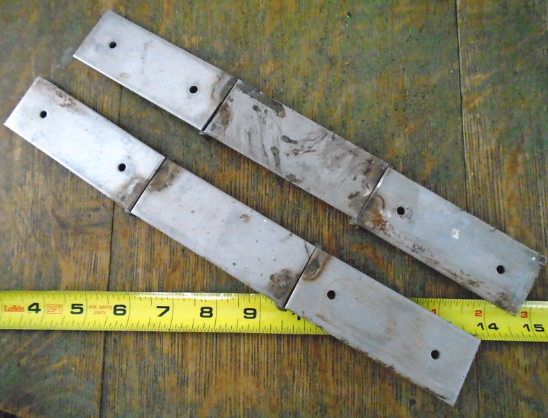

I have a pair of original-equipment Hunter-made folding-table hinges that I'm not going to use. They look old but are intact and very usable. They each have three leaves and two hinge pins, meant for folding the table downwards and then inwards against the bulkhead (so that the bulkhead edge finishes above the little stick on the wall that held it when it was down). This was necessary for the H25 because of low headroom - the table was longer than the stick was high off the sole.
If you're going to rebuild a table like the original and want these, let me know. I was gonna list them on eBay but I doubt anyone will know what they're for.
