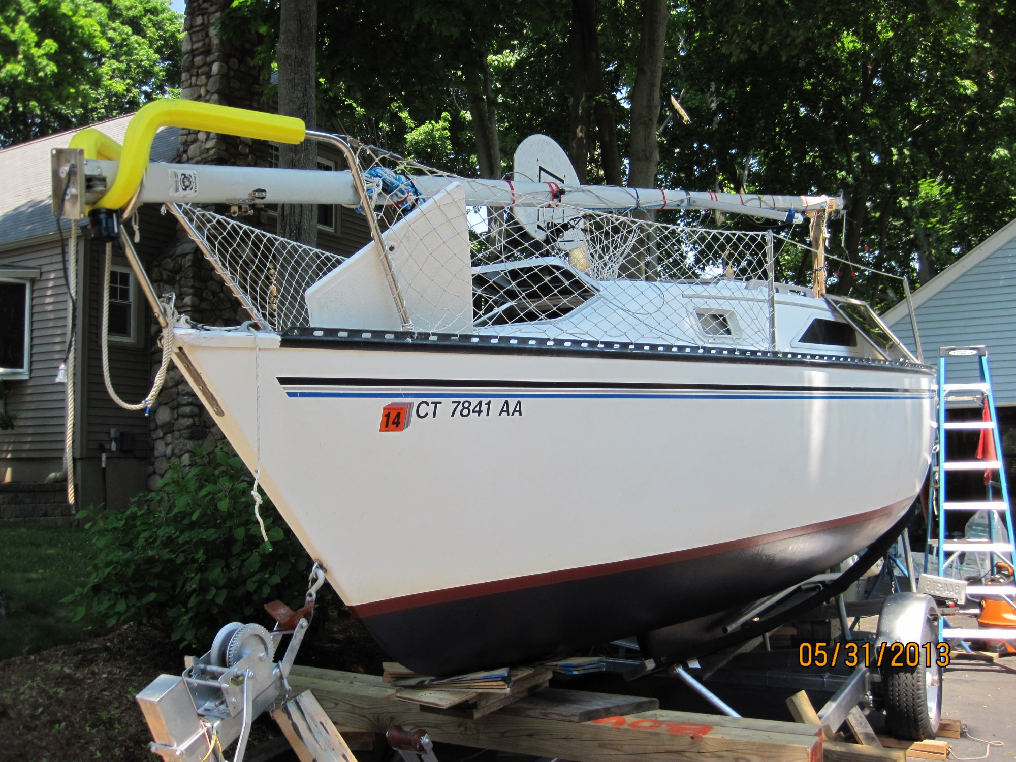

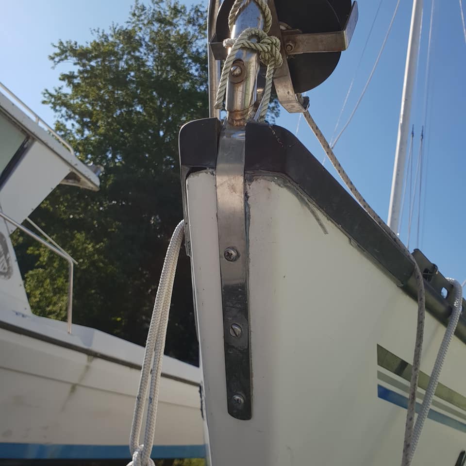

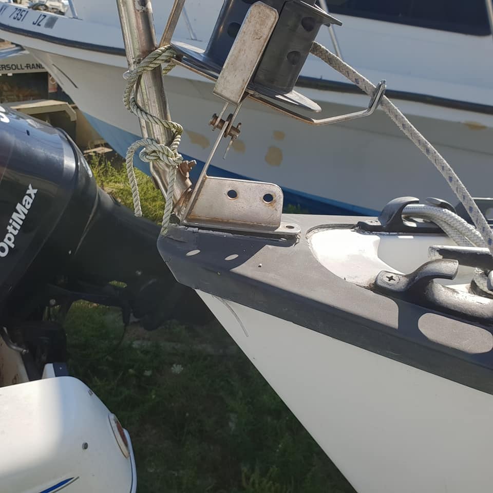

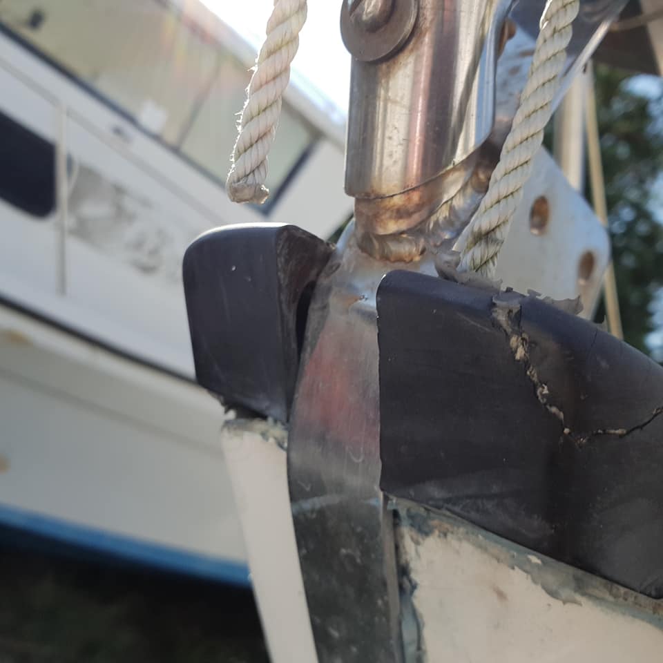

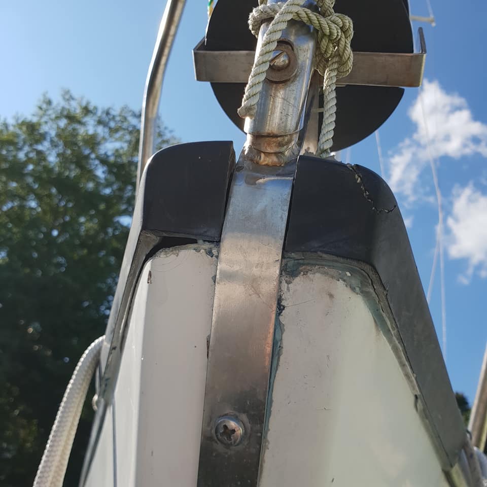

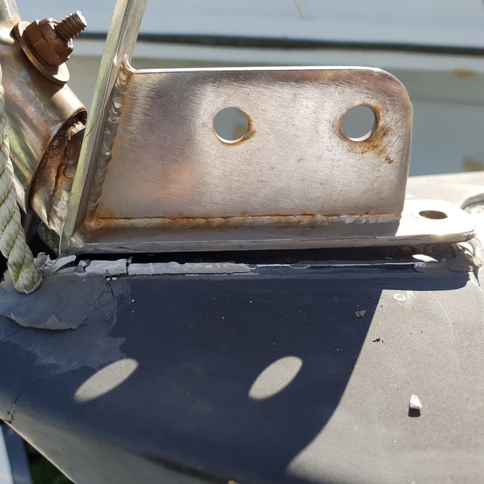

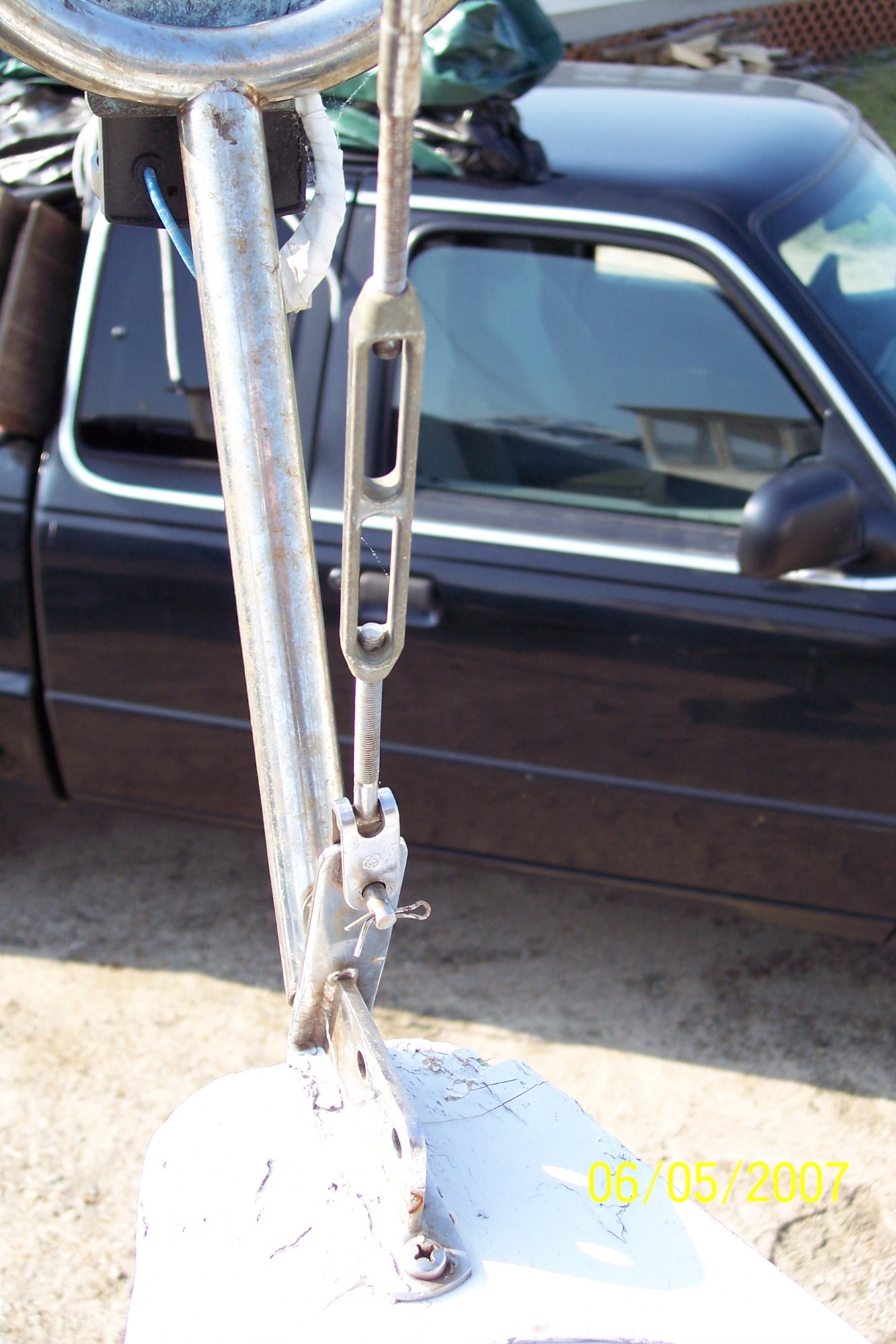

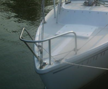

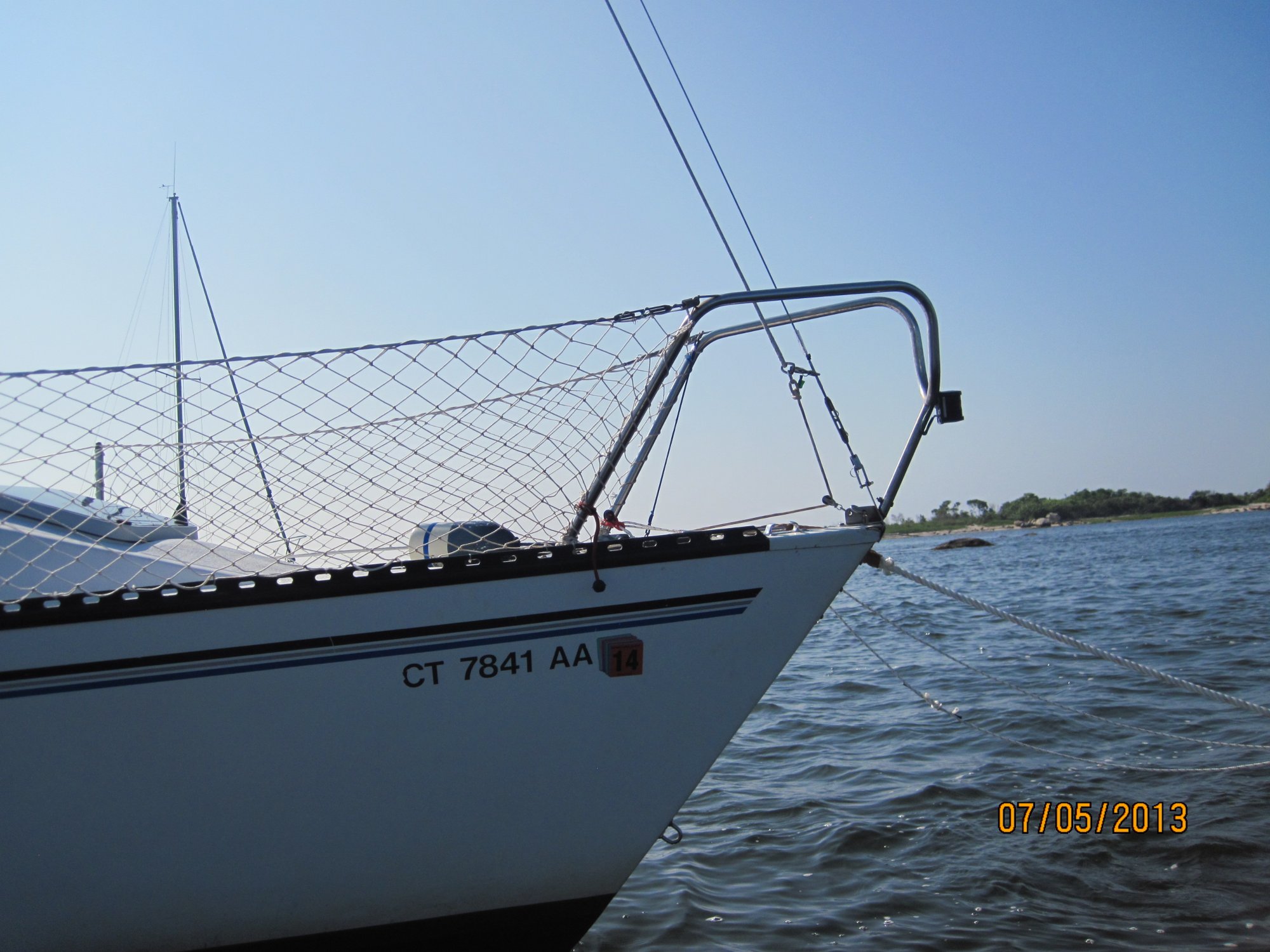

Can someone please post a photo of OEM 1981 Hunter 22 forestay chainplate. I think what I have is aftermarket and made for the roller furling, but I could be wrong. I think mine may have gotten bent from a collision, and before I replace it, I am just wondering what OEM looked like.

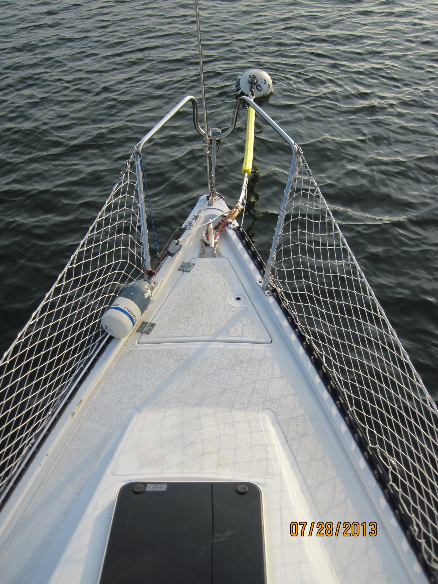

Also... wondering what do people do for roller furling. I am told my setup is not good, that the tang is too long, that I need to get more clearance from the bow pulpit support to shorten the tang and move the furler body down closer to the deck. So I guess I have to modify the bow pulpit support to put a "C" curve in it. to get it around the furler? Thoughts.
