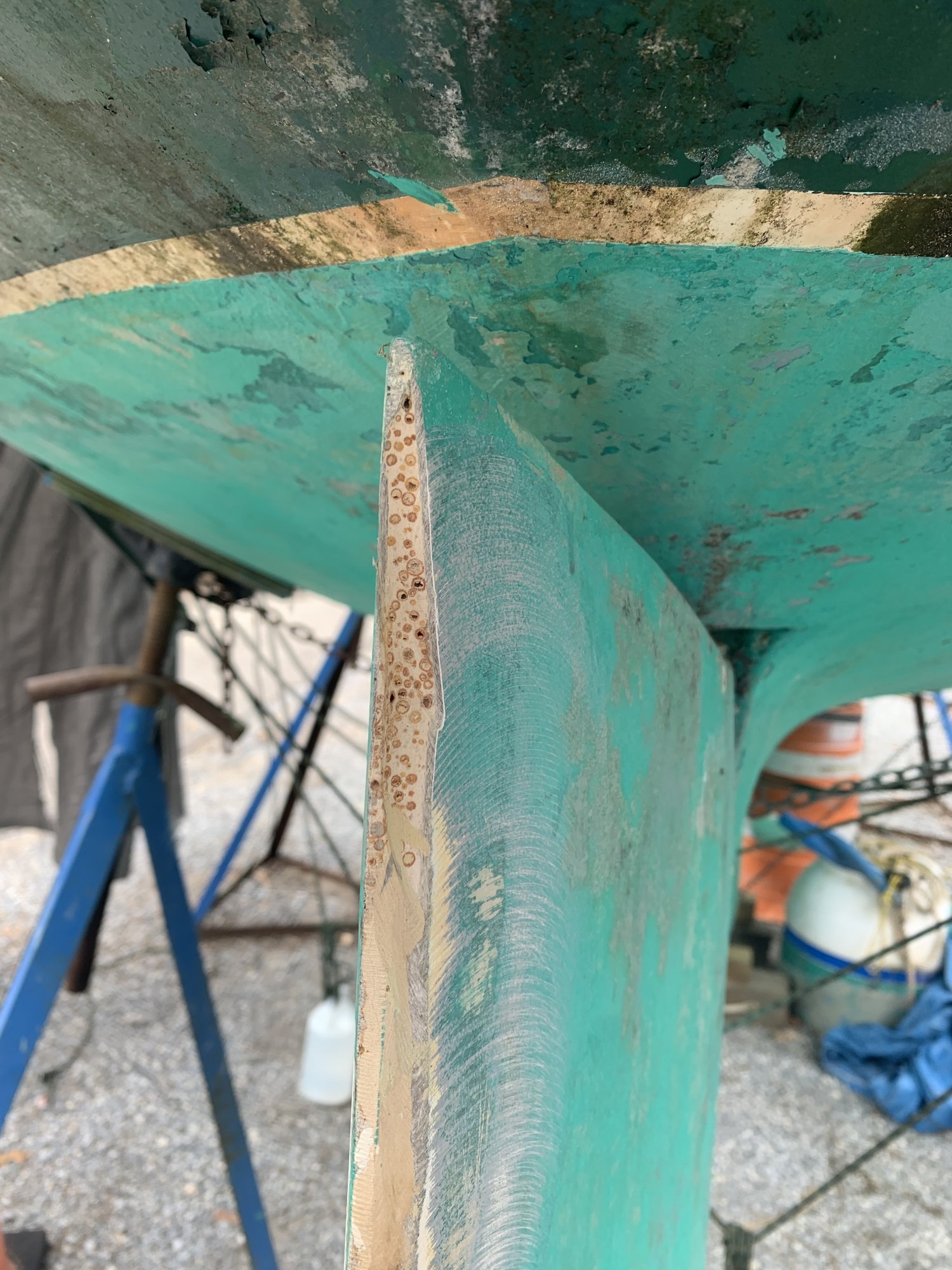

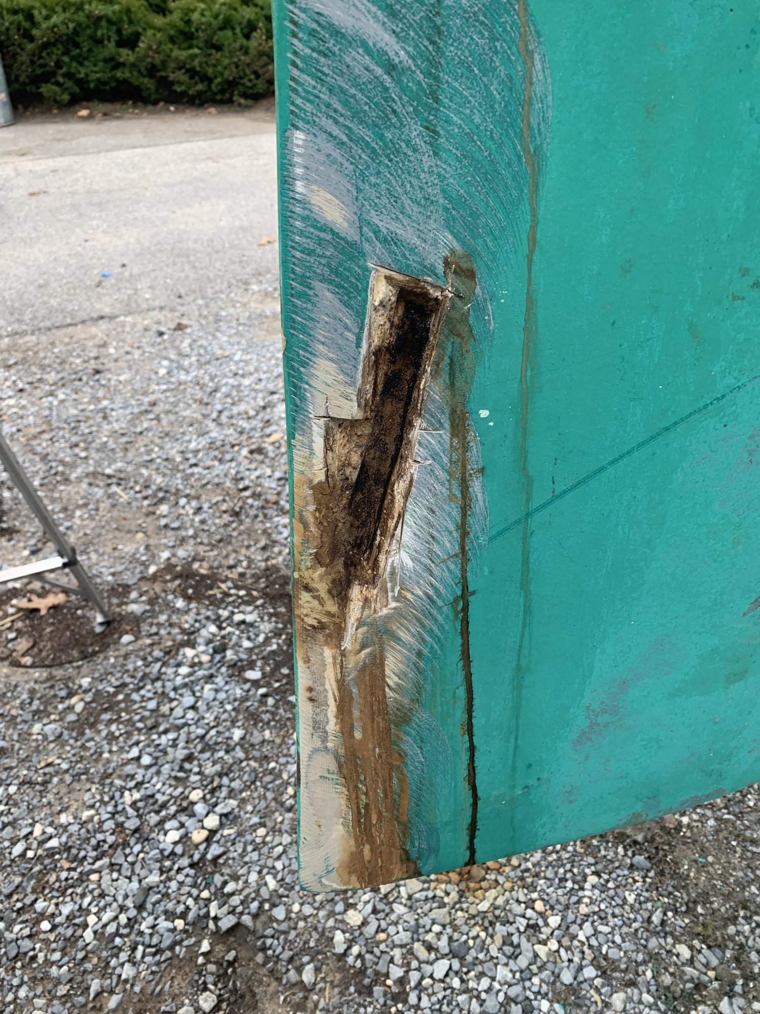

Hello Sailors,
My 1986 Catalina 30 rudder has a slight water leak. Any suggestions.
Thank you
Trixster,
Glen Cove, NY
From the pictures it looks like some amount of destructive investigation has already been done to the trailing edge of the rudder and to a lower section near the leading edge? It’s hard to tell but if that’s rusty color in the lower section I’d assume the steel supports inside the rudder are compromised, and the rudder will need to be at least cut in half to further evaluate it and potentially replace the steel.
David,
Thank you. It is pretty much the same story my advisors were telling me. thank you for the guidance.
