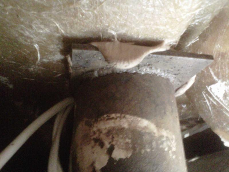

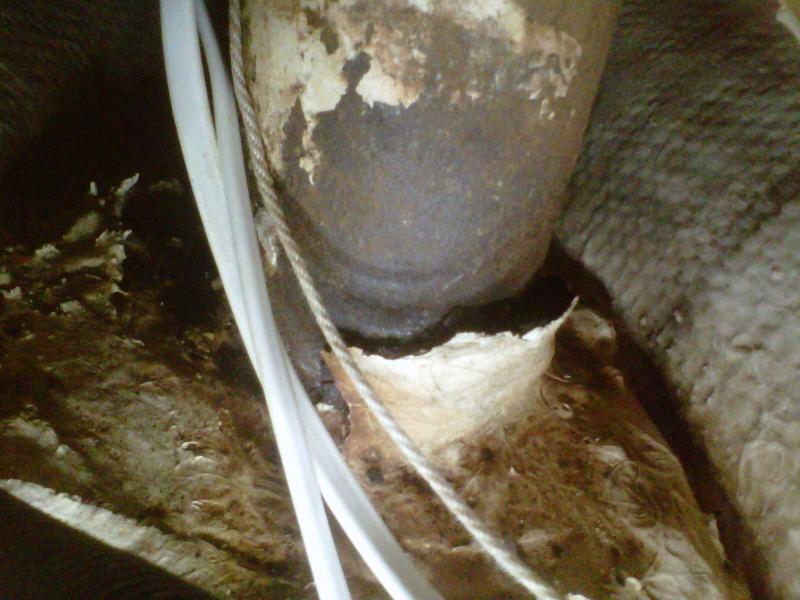

So many thanks for coming back because just over the last few days I had been thinking about adding extra support around the steel tube that supports the mast compression between the cabin floor and the bilge surface.
I posted a pic before ... but here again. Because my tube is still good, I am not planning on removing it. Instead, with the mast up, I am thinking to loosen the shrouds and stays to "floppy", then place some hydraulic jacks down low to force the deck and the mast up just a bit. Add a little more pressure to the jacks for several days as the deck hopefully will gradually lift. With the new say 1/4"-1/2" extra vertical gap, then I'll wedge four short pieces of 1.5"x1.5" IPE wood around the existing tube. Finally use a large pipe clamp or something else to cinch the IPE tight against the tube so they don't ever work loose. Then no matter what happens to the steel tube, the mast compression force will still be supported in this area. I am keeping this section of the bilge totally dry. And IPE (also known as iron wood) is incredibly strong and is highly rot resistant. Should last as long as I own the boat anyway. I am reasonably sure that my wood compression post between the deck and the cabin floor hasn't rotted as yours. Also I think that the deck core underneath the deck stepped mast is also OK.
My concern with this project has been how much slack I can have in the shrouds/stays without concern that the mast might somehow get loose and topple. Your info suggest that this really isn't a deal breaker. Again thanks for the status report.
