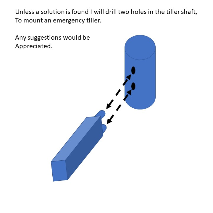

My 1980 H27 has an emergency tiller post exiting out of the front of the aft seating. The emergency tiller device its self was lost well before I got the boat. The tiller post is smooth, with no teeth and the inside of the shaft is filled with what appears to be cork. So if you actually had the emergency tiller how would you attach it to the post. Does anyone have an image of the original before I just create my own monstrosity to do the job?

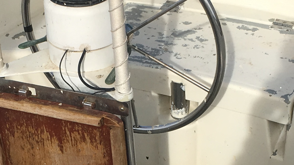

The stainless beercan looking thing in the middle of my seat is the emergency tiller post... No way to attach to it that I can see. But two holes and a tiller handle would do the trick... Don't judge the paint... I'm working on that this weekend if it doesn't rain. The previous owner painted it with what appears to be house paint. - it's a bummer man.
That thing is attached to the rudder and spins with the wheel...You can see how that might pinch the underside of fat little leg if you weren't paying attention when steering...

CC 30 South Florida
