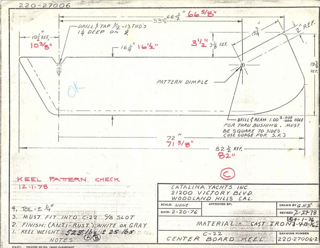

Does any body perhaps have that sort of thing close at hand?

Others will chime in with some dwgs, I expect, good luck with your plan, although I believe you'll need more than SS sheets, and you'll need the proper ballast weight (550# or so) to make it sail-worthy....may be better off searching for a keel off a trashed boat, or even ordering a new one...wonder how did the weldments fair in this tragedy?

Please someone help me with the keel pattern.

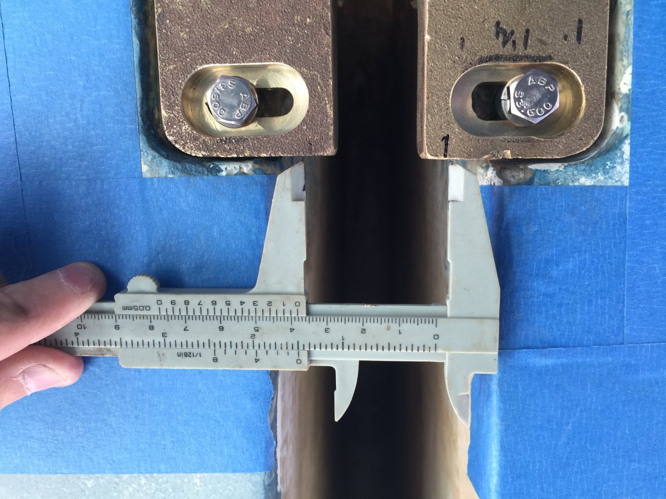

and a couple other views that might be helpful-- added a last minute photo of my hangers with calipers set to my keel width-- right at 1.5" I can archive the foil dimensions as well if you really want to go that far ;)

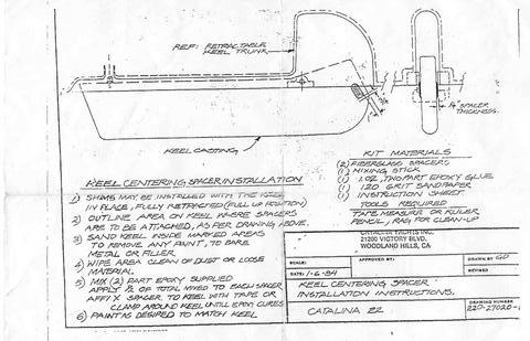

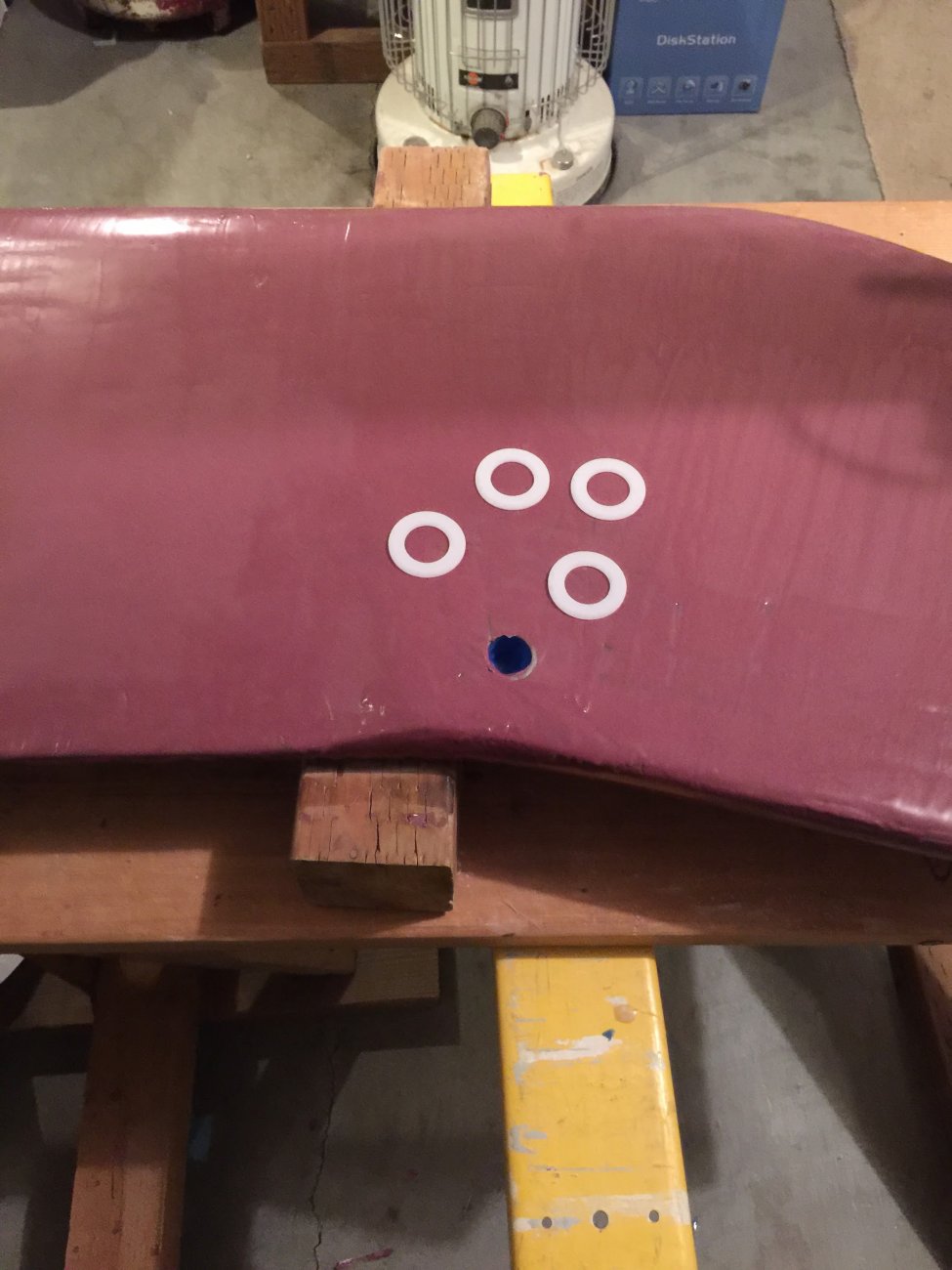

Most swing keel, daggerboard and centerboard (non-shoal keel) boats are very sloppy with their boards up. It's kinda like driving on ice with bald tires

Can be — but if he’s willing to spend the time it can be tight as a drum: just a lowly spacer with zero play

If I had to go the new keel route it would be as per diagram above but I would create the bulb effect at the lower edge with welded on strips for the extra low down weight, use good old solid mild steel and have it really thoroughly galvanised.
Surely you could sell the stainless to cover the costs of a new item as described in the drawings?
