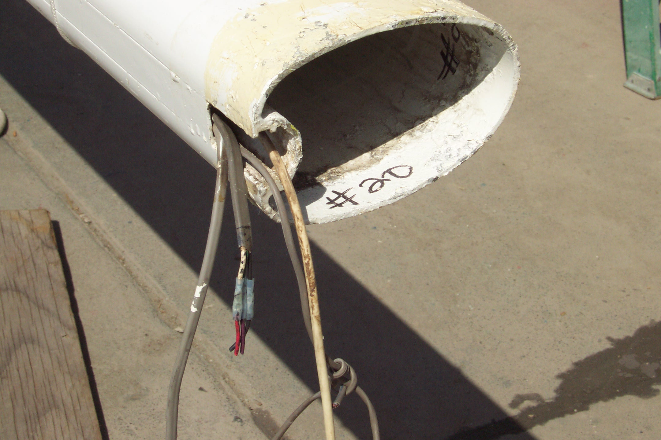

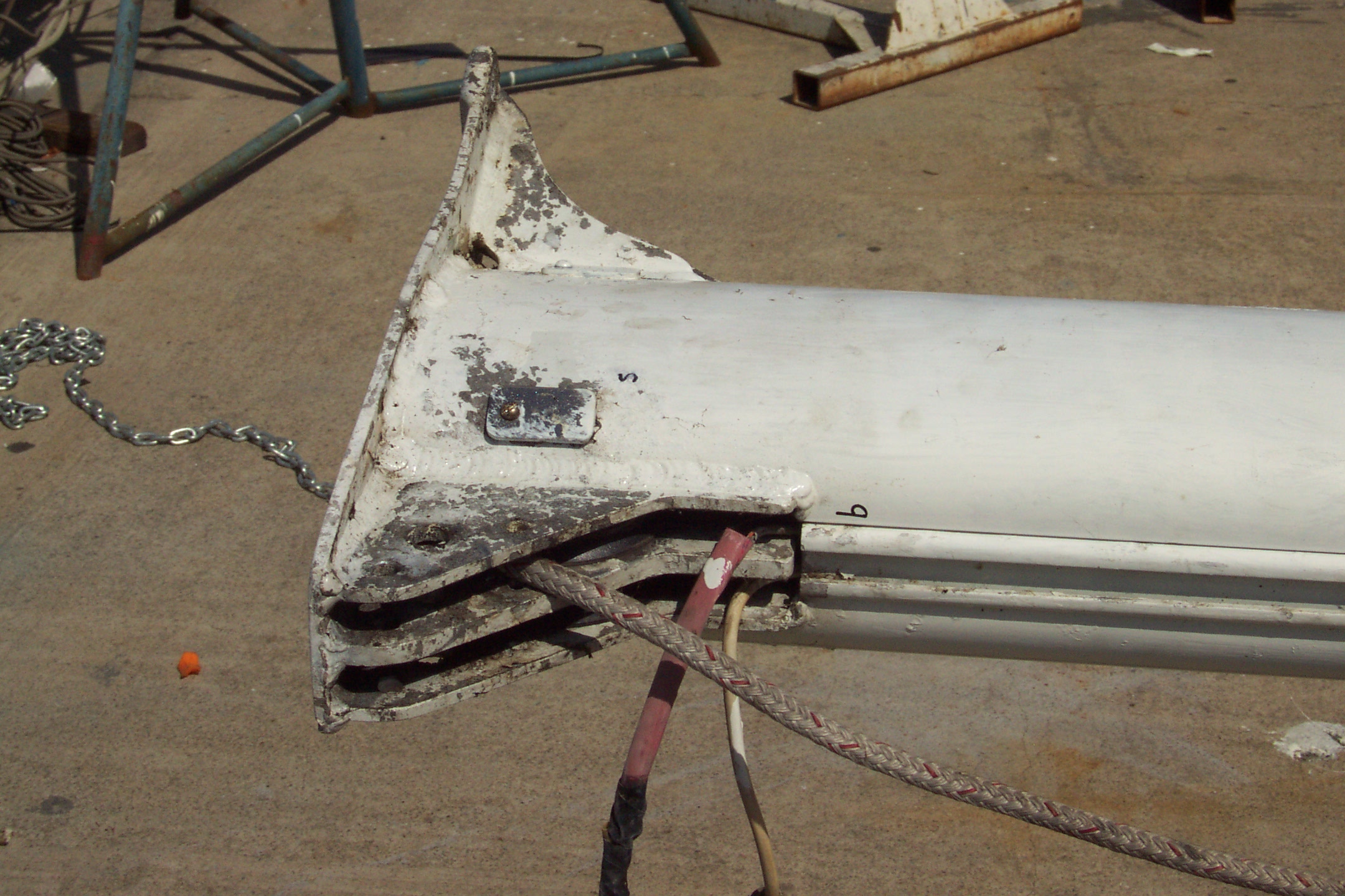

This shows what mine looked like, at least before we had the bottom few inches cut off and a new step installed

If you had the mast down and fully accessible I figure it would be possible to feed new wires in behind the track. While we have the mast down for upcoming work I am going see how easily the existing wires slide, what the condition looks like, and evaluate if I should run in new wires. The services are steaming light, deck light(s) and VHF antenna which don't add up to a very big bundle. We removed a huge old radar that had a bundle of wires running in that same track and were able to just pull them out.
The mast head plate is not removable - see picture.

1,099
I agree John - if all you need are the 3 wires you mention, I think you could pull the wires and avoid removing the sail track. But on my boat I have tricolor, mast head wind instruments, steaming & deck lights, and radar. Once the radar cable joins the wire chase, there is just enough room to fit it all in. That is why I had to remove the track that covers the wire channel.
