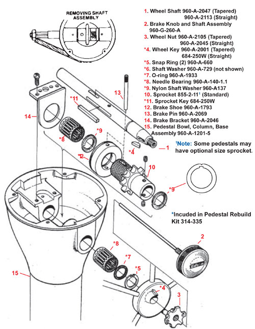

yea sounds exactly like mine. has been over 2yrs since it's ran. No did'nt check mounts yet will though. do you know where the gear lever is mounted? I believe on the steering column if so it's snapped of

The gear shift on my 79 H30C is on the binnacle below the steering wheel oriented port and starboard. It's basically a stainless steel, 8in. rod with a rubber covering at the outboard end for grip. It mounts through a hole in the pin that protrudes from the binnacle and is secured with a machine screw. Is the pin still present? If not, you'll have to study the Edson manual for a parts breakdown and dimensions.

I was afraid of that .Looks to be flush with it. So I,ll have to tear it apart just to see what I need to replace it
