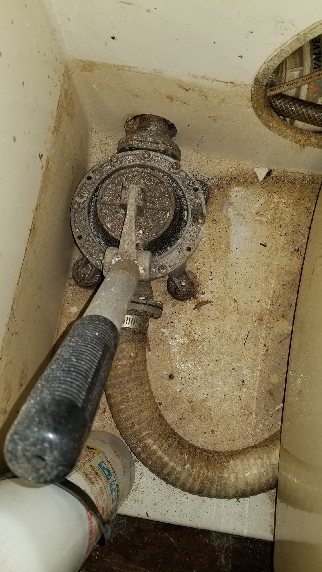

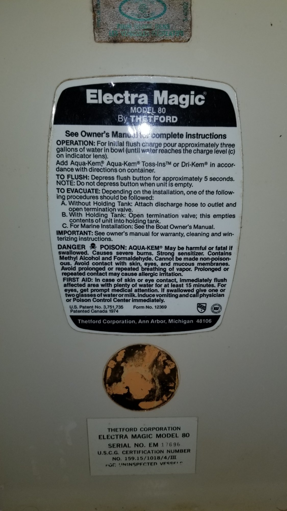

Concerning the head, probably the biggest expense. Is my electra magic 80 toilet salvageable, not sure on age? I am hoping this is in the good column. Not sure if it falls under toilet or porta potty but I do not have a black water tank and it appears the waste is contained within a reservoir of the toilet itself but it's not removable for me to pickup and dump out. This particular model has an electric flush to the self contained tank and then waste water line is connected to a hand pump and then waste line goes to a y valve to be sucked out or pumped overboard I imagine. I was able to download the old owners manual and parts list. I was able to clean up the toilet pretty well and found a new seat in a box from the previous owner. What should I look at to determine if toilet still has life. I image some internal gaskets grommets and flush mechanism may have to be replaced. I have no intention of installing a black water tank as the boat never had one. My marina has a pump out so I like the idea of keeping existing toilet and pumping out if possible . I am in the Chesapeake so I will never discharge in the water.

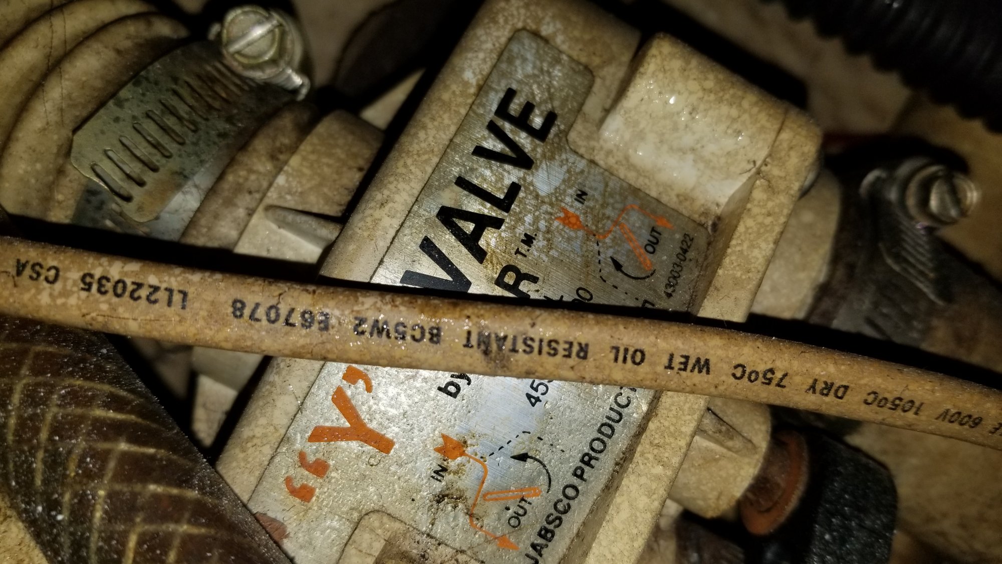

I was planning on keeping both sinks and faucets in galley and head. I have two Jabsco pumps on board I think one is for freshwater washdown and other is water supply to faucets not sure if they work yet.

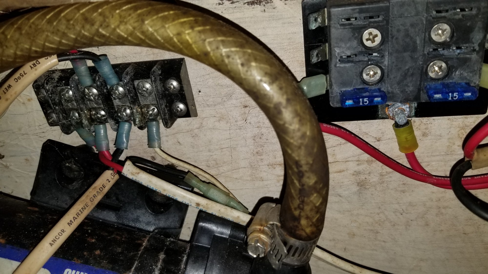

Also on a side note I have had a few 90 degree days and have been crawling around the boat and updating electrical lines and there have been NO off sewer smells so hoping the sewage lines are in the good column. The water line was from a fresh water flood when it was dry docked.

It would appear the head is still in production, so parts and manuals should be available from Thetford.
If the hoses are moldy and ugly, time for new hoses. Traditional reinforced vinyl hoses work as does Pex, each have their advantages and disadvantages.

The Thetford ElectroMagic is a recirculating toilet that holds a combined total of 5 gallons of waste and water to which a nasty formaldehyde based chemical is added in the same tank. "Recirculating" means exactly that...you get to see--and SMELL--all the previous flushes in the bowl each time you use it.If it's not pumped out daily, it really stinks, especially in hot weather. I've never known anyone who's had one who didn't hate it! If that's not enough to convince you that you don't want to keep it, it's also an electric toilet. Here's the owners manual for it Theford Electra Magic owners manual
But you don't have to spend the money for a toilet, holding tank and all the related plumbing--not to mention all the storage space you'd lose with it...and prob'ly the expense of adding a thru-hull for the flush water intake too. Many owners of smaller boats have what's called an "MSD" portapotty and love it. The "MSD" designation in the model name/number means it has fittings for a pumpout line and vent line, and is designed to be permanently installed (actually just sturdier brackets than portables, so you could still take it off the boat if you absolutely have to), which means that although it's still called a PORTApotty, you don't have to carry anything off the boat to empty it.
A 5-6 gallon model holds 50-60 flushes...you'd need at least a 30 gal tank to hold that many from a manual marine toilet. No plumbing needed except a vent line and pumpout hose--so no new holes in the boat...and -0- maintenance needed except for rinsing out the tank--which you can do with a bucket while it's being pumped out. Total cost including the pumpout hose and vent line is about $200--a fraction of what you'd spend for toilet, tank and all the related plumbing needed. And the best part is, you have all the advantages of a toilet and holding tank without giving up a single square foot of storage space. Check out the DometicSeaLand 975 MSD...available from the sbo.com online store.
As for your hoses...replace them. 10 years is the average MAX lifespan for any hose because plastics and rubber dry out and become hard, brittle and prone to cracking and splitting. You won't need but a few feet of pumpout and vent hose, so go with top quality hose that's proven to be 100% odor permeation resistant...I recommend this one RaritanSaniFlex hose Defender has it for about $8/ft.
