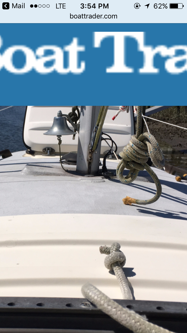

Have you also checked the photo I uploaded. (Where the mast sits, looks like it is dent, not aure if it is normal).

The depression in the mast step is not normal. The wood coring material has rotted away allowing the mast to sink into the deck. A proper fix requires the mast to be removed, top layer of fiberglass cut out, all the rotted area dug out and replaced with new plywood, then put it all back together with epoxy. Not a cheap job if you are have a boat yard do it. Honestly,, just looking at the mast step condition, I would be very sceptical about other areas of the boat that may not have been repaired.

Cannot tell from that picture if there is a depression at the mast or if it is normal. The compression post doubles as framing for the head pocket door. If the compression post is bent the door will not slide freely. I think those boats came with a single cylinder Renault diesel; from the listing the engine was upgraded to a 12HP Yanmar with fresh water cooling. Hunter has been using Yanmar engines for the past 35+ years. The boat seems to be in good condition and priced fairly for the year model. If I were you I would hire a surveyor to inspect the boat. I had an h27 years ago and that boat is sturdy with good stability and can be sailed to the Bahamas and down the Islands to the Dominican Republic but as with any small sailboat it will require an experienced captain to execute the trip. As far as navigation equipment a handheld GPS and charts would do but I would prefer a small chart plotter. Crossing the Gulf Stream from Miami to the Bahamas is a tricky passage which requires planning and a weather window. Hire a delivery Captain to help you take the boat and at the same time he can teach you about sailing and passage making.

That mast step looks collapsed to me. Check the standing rigging turnbuckles. If they are at the short end of their range it could mean they have been continually tightened to compensate. In any event given your timetable and plans I think it would be wise to pass on this one.

Because the deck is curved, the standard mast step can look depressed. Our purchase survey showed high moisture there, and a year later, our cabin door by the compression post under the mast began to stick. It cost us around $800 to have it fixed as described above. We replaced the rotted, wet wood with and aluminum plate and epoxy and have had no issues since.
