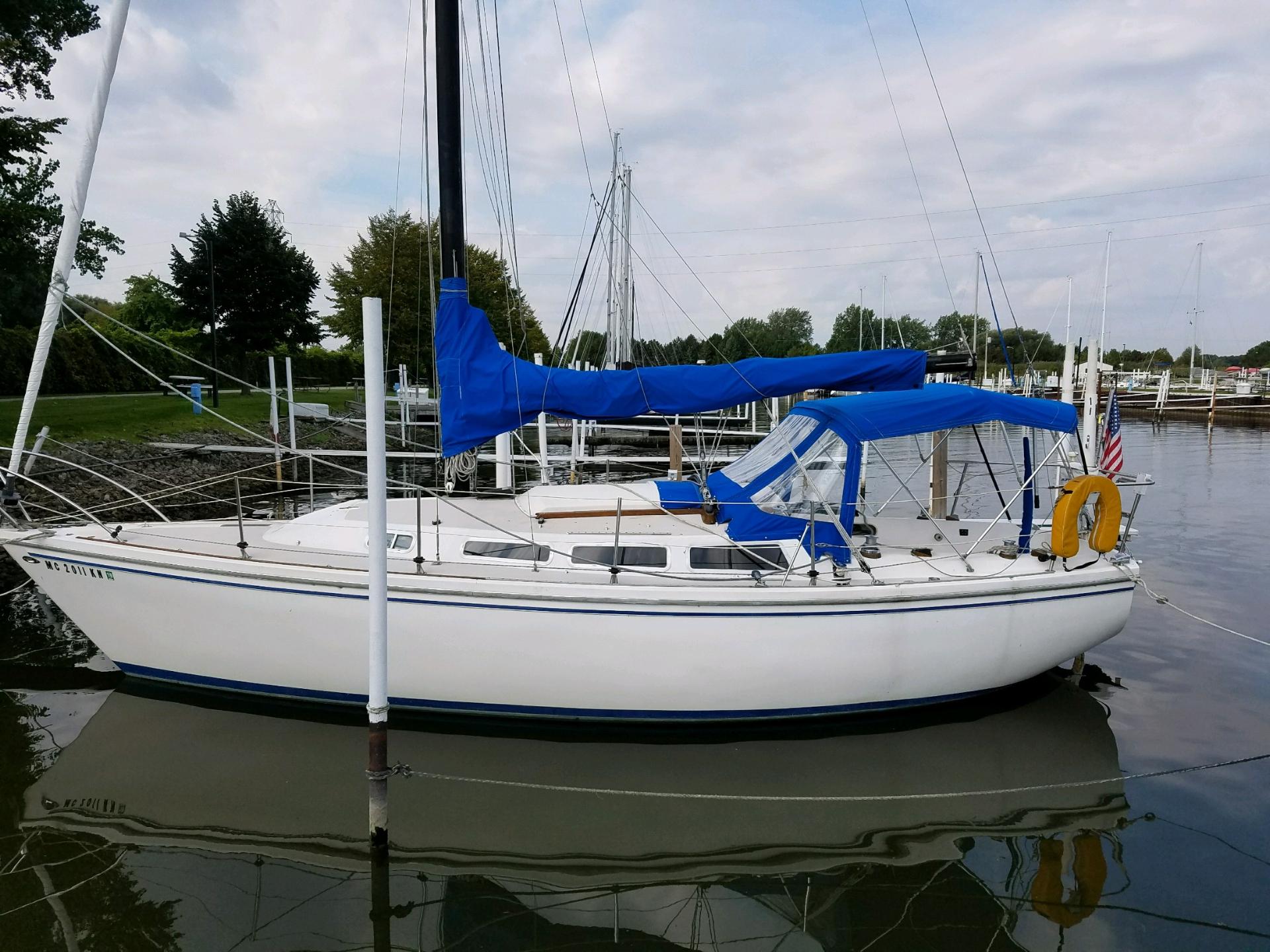

Hello all,
I just purchased a '77 Catalina 30 in incredible condition. It currently has a tiller and I’m wondering if it can be converted to a wheel helm. Is there a kit available? Is the rudder shaft adequate? How difficult? Is it worth the effort? Always wanted a wheel but every boat I buy ends up being a tiller.

All valid points. I have noticed the T shaped cockpit and wondered about wheel size as well as quick access to the helm with my layout. I agree the wheel takes up a lot of space but arguably so does the tiller. When in port the tiller is up and cockpit is very open but at sea the tiller tacks up 3/4 of the cockpit.
I'm going to continue to source the parts and knowledge however I think I'll sail for the season and get to know the boat before making any major changes.
