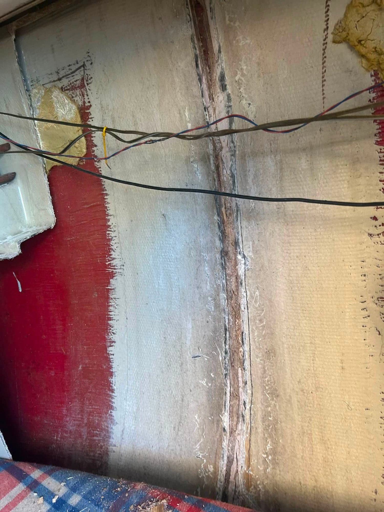

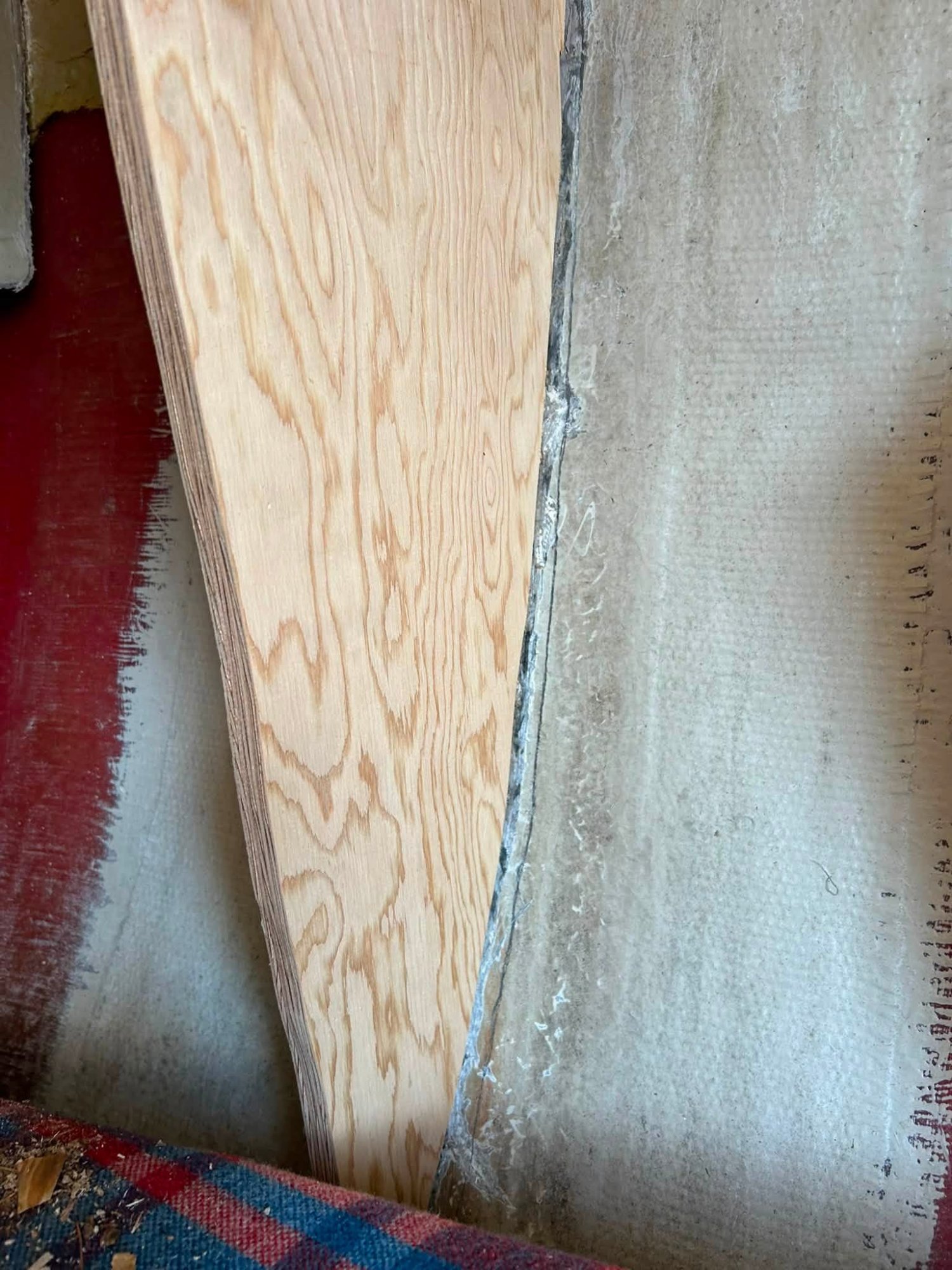

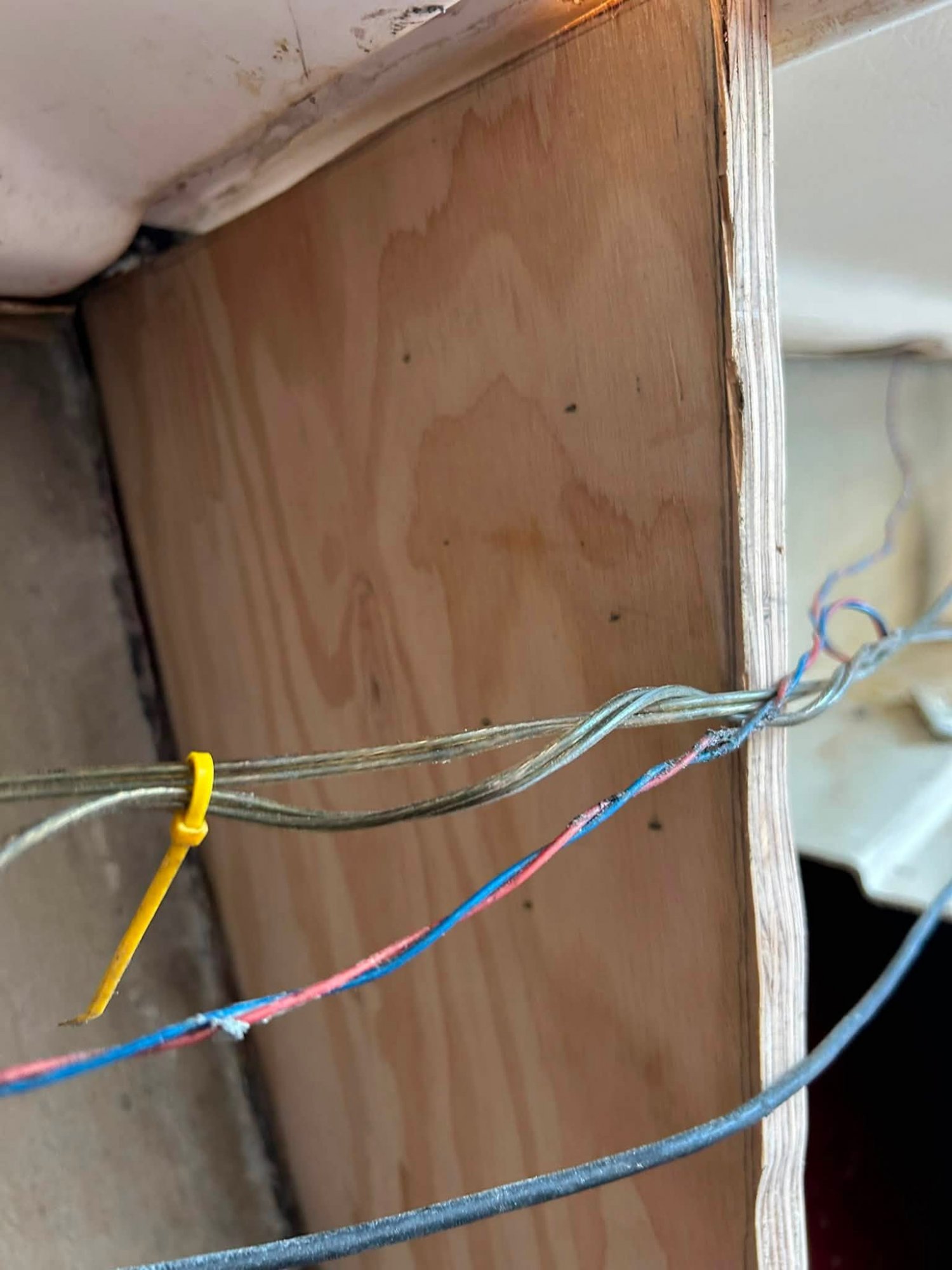

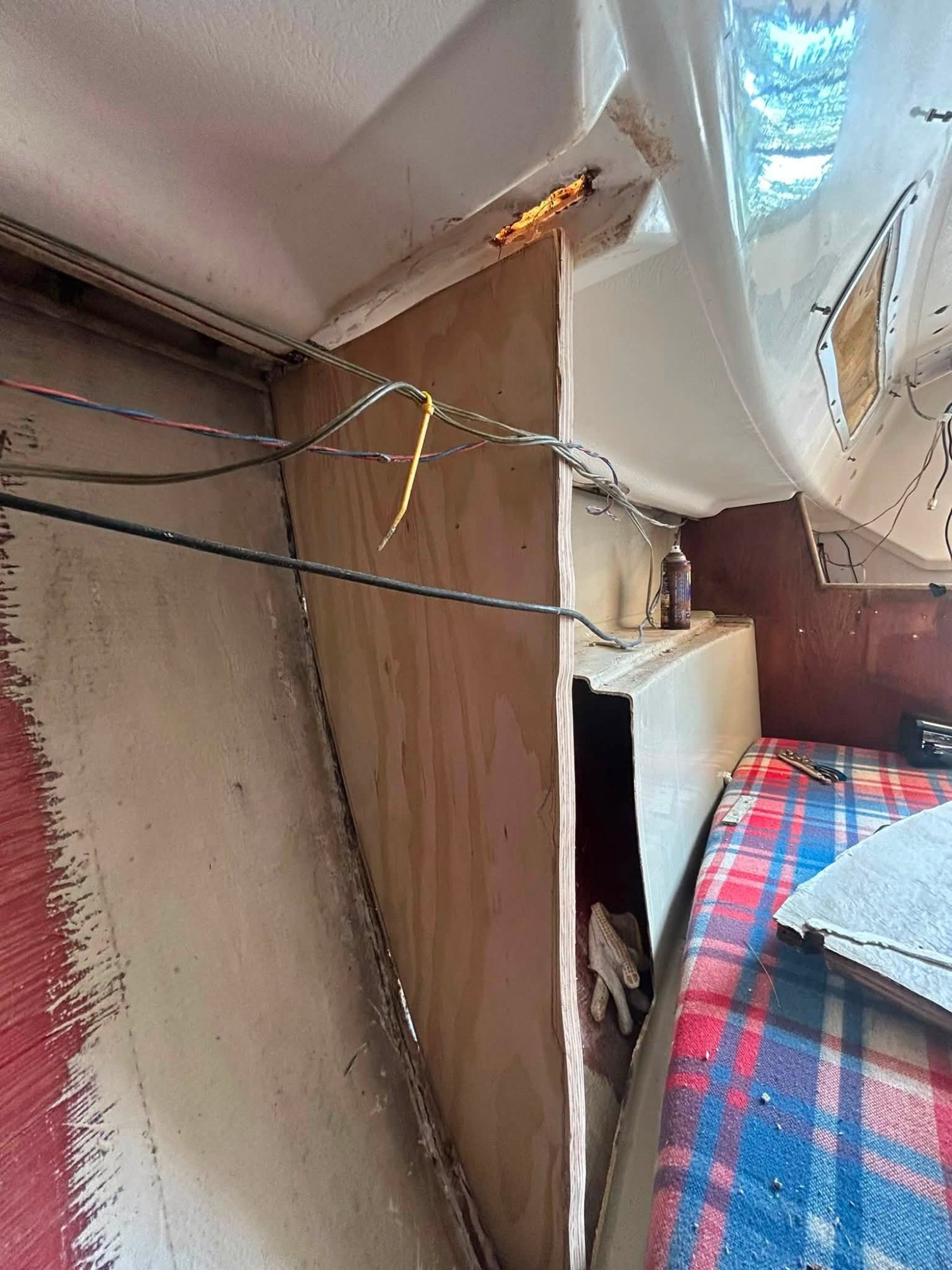

Hey.
I am in the process of replacement the Chainplate knees on my boat. I am getting mixed recommendations on how to install against the hull. the recommendations have gotten so are is to install a strip of foam between the hull and the new knee to avoid hard spots but some say to just epoxy it to the hull with a epoxy peanut butter mixture. I still have to grind the old fiberglass of the hull before setting it in place. Any thoughts on which would be the best way to proceed.
13,076
I am not a naval architect, (but I pretend to be one on this forum;)). Joking aside, I have read extensively on the subject. Traditional carvel-framed boats rely on the rigidity of the hull structure to distribute loads and stresses throughout the vessel. Any movement between structural members can concentrate stress at joints and fastenings, potentially leading to damage over time. For that reason, I would favor using epoxy, as it can help create a stronger, more rigid bond and reduce localized movement. The stress from the shrouds will be tranfered to the knee and then to the hull and stringers and .... and... and...

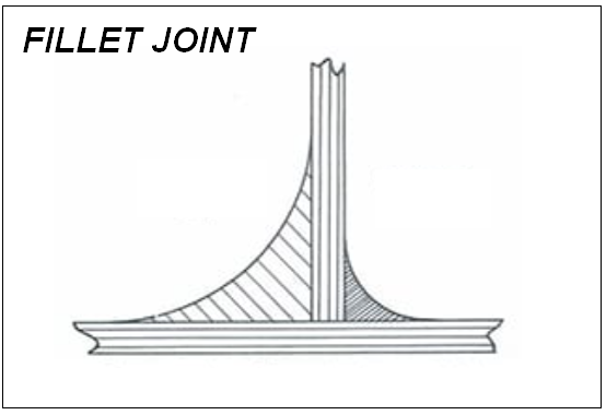

In order to avoid any posible separation at the contact, you may also want to consider a filet joint on both sides made of heavy glassed cloth (or several layers of lighter cloth) rather than just filler material :
.............. that runs from right from the top to the bottom. The cloth reinforcement should spread several inches from the intersection of both the knee and the hull. You don't want to do this job again in a few years. A solidly reinforced plate will also avoid telegraphing the attachment position of the knee to the shiny hull exterior.

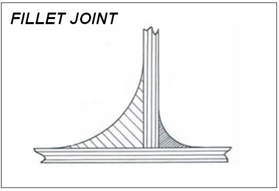

It is appropriate to be concerned about a the knee (or bulkhead) forming a hard spot where it meets the hull. If the knee is just glued to the hull with thickened epoxy there will be a hard spot. The fillet and the tabbing distribute the loads from the knee across a larger area thus eliminating the hard spot. Fiberglass does not like sharp corners, the glass will tend to pull away from the corner A fillet provides a radiuses corner which allows the glass to maintain contact with joint.
