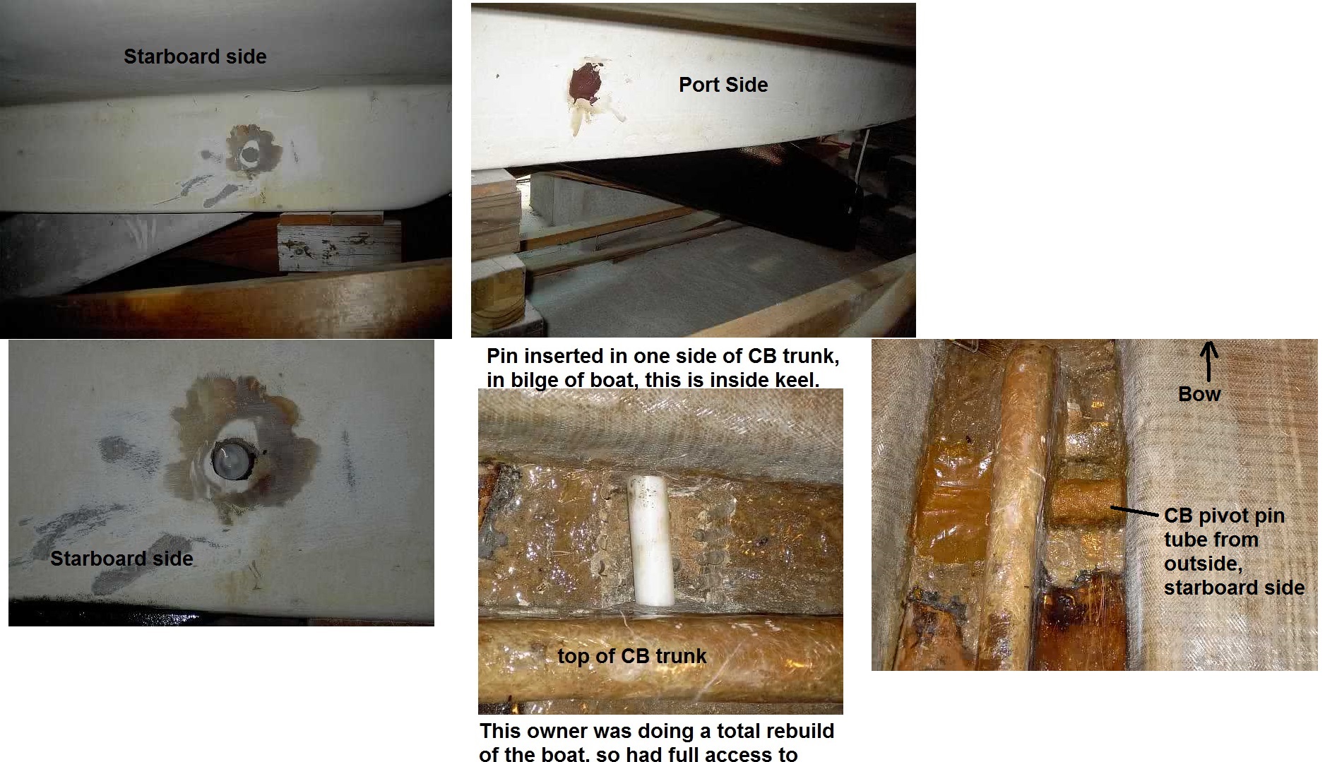

The 1973-74 model had a pin inserted from one side, so you should see some kind of plug/putty spot on one side of the keel covering the pin access.

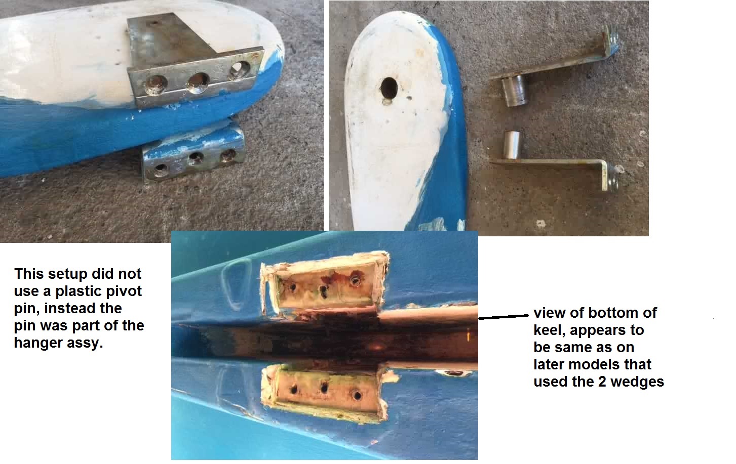

At a later time, (maybe 1975?) the setup was changed to have 2 metal "hangers" that held the CB pivot pin, these will have a stainless-steel plate on each side of the bottom of the keel, those plates are attached to vertical stainless-steel plates that go up into the CB slot one on each side of the CB, the pivot pin is metal on those and attached to one plate (I think) with a short tube on the other plate that the pin fits into.

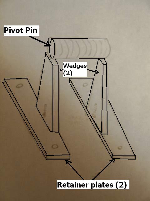

I think the last boats built (1978) may have had the 2 fiberglass wedges, held in my a pair of Stainless-steel plates, with the wedges holding the pin in place. Just like most of the other O'DAY K/CB models.

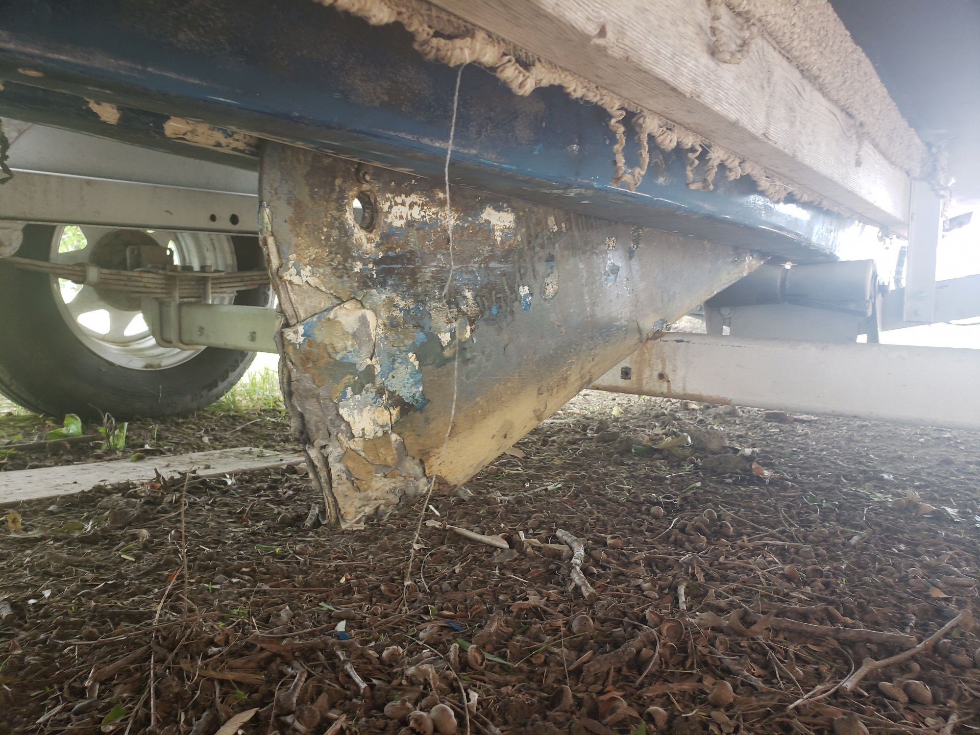

Here are some pictures of the setups:
