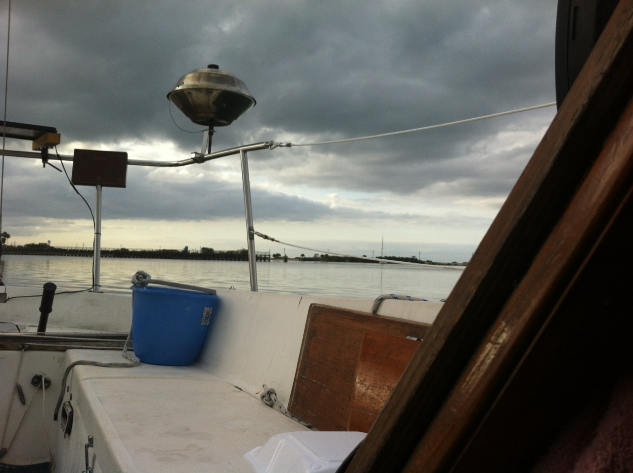

I bought a tiller extension for my motor and cut a hole in the well lid. You can see it here. Cheaper than buying the remote setup. Depending on how you plan to sail I would suggest setting up the motor to charge your batteries. We go out for days at time and the 3amps extra helps augment solar.
