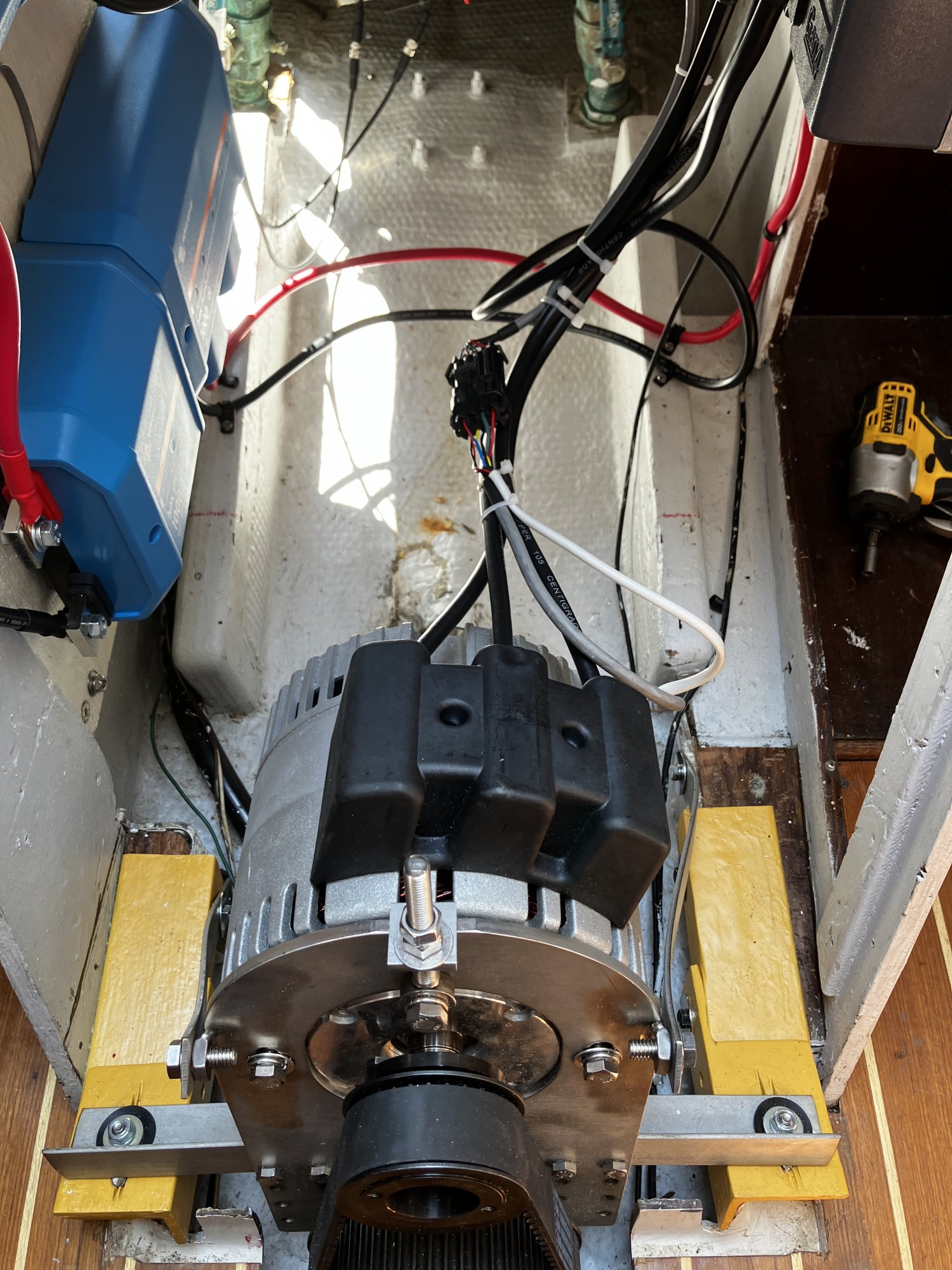

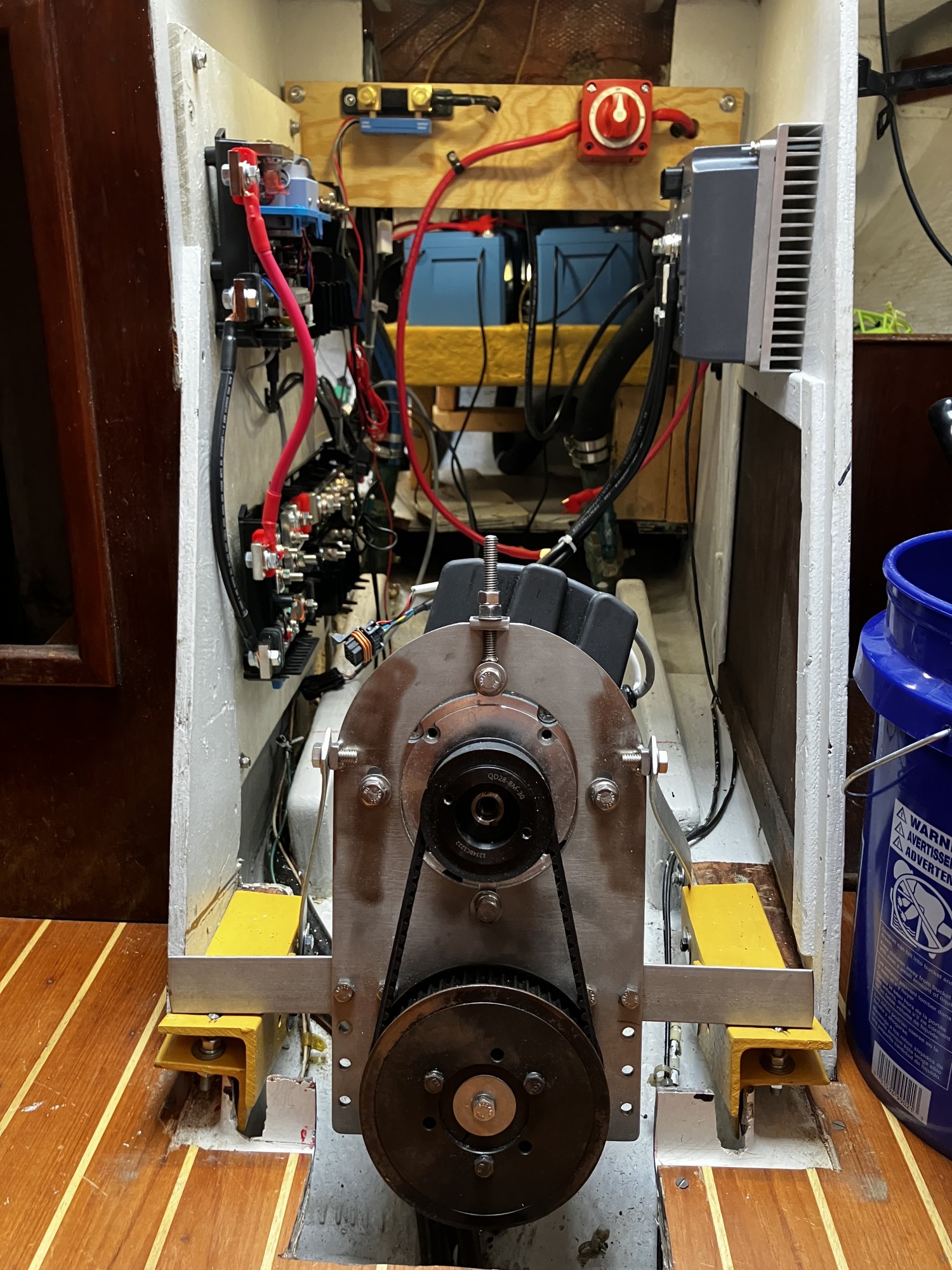

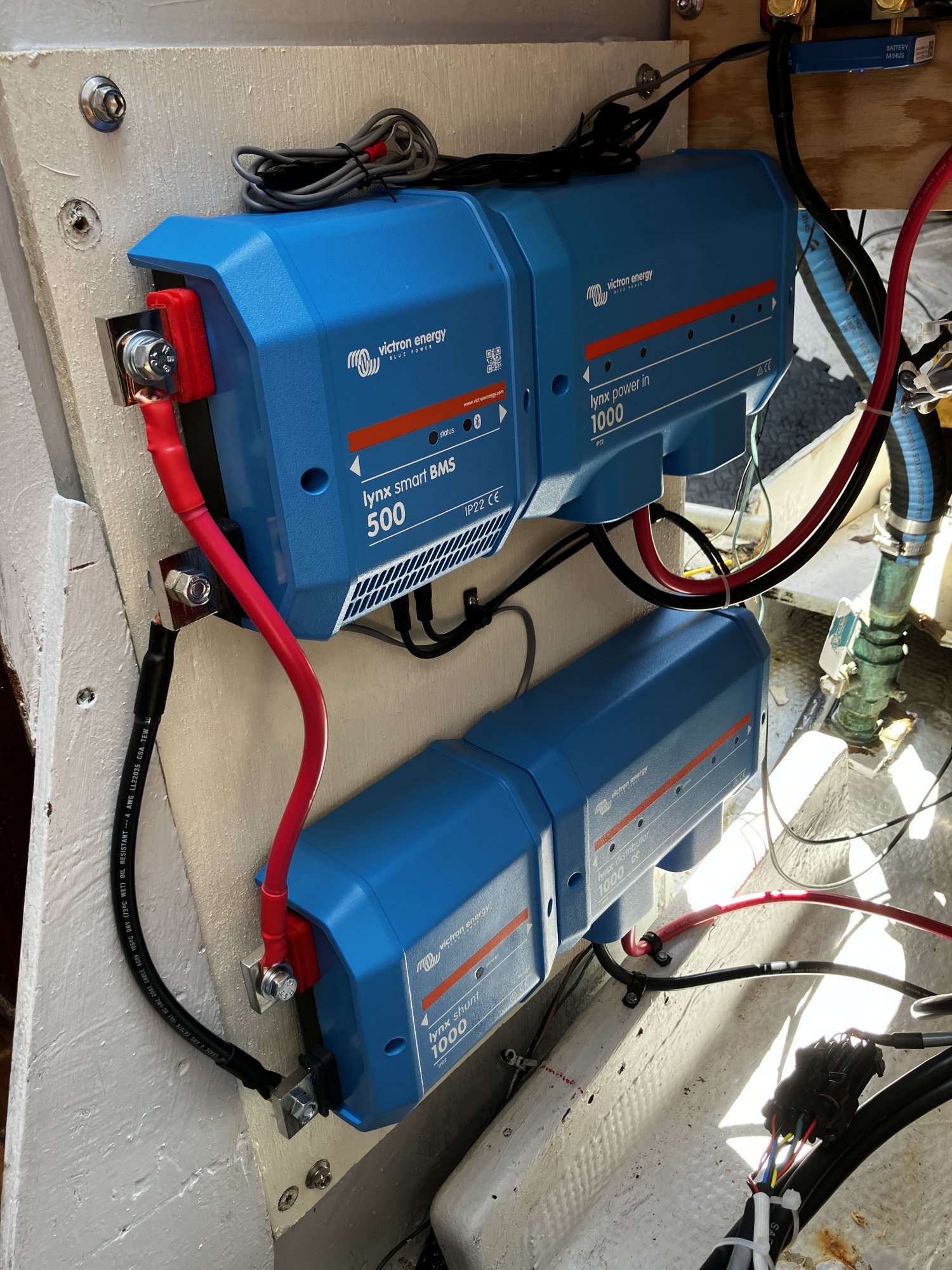

My wife and I spent spring and early summer 23’ on a nearly complete refit of our 75’ C&C 33. We blasted the bottom, ripped out the sea head, revamped the water system and replaced the gas powered atomic 4 With a 10kw thunderstruck setup managed and powered by a 100ah Victron blue smart 48v battery bank.
The boat runs solid, smooth and peacefully. No smells and no maintenance. We couldn’t be happier with the upgrades and am happy to answer questions about any aspect of the refit.

We mostly day sail and weekend. So our power needs are limited. I have 2 400w Canadian Solar modules that run through a Victron charge controller.
We will be installing a DC-DC inverter to be able to charge the 12v system from the charge coming in to the 48v system.
